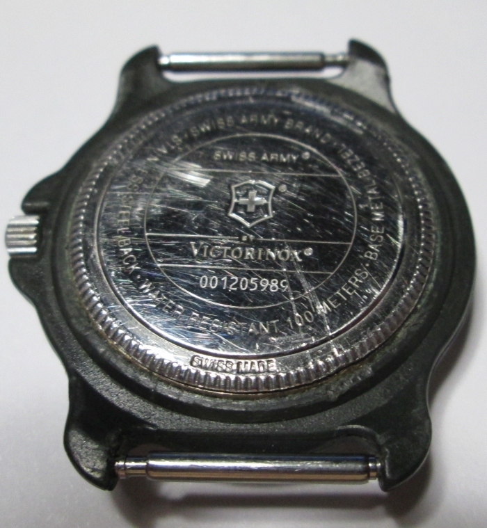

Greetings All,
I hope this is not a silly question but I'd like to identify what tool(s) I might need to open this type of screw back watch case (see pic. below). This is an inexpensive Victorinox Swiss Army watch and I really don't want to spend $20-$25 at a Jeweler's to have the battery replaced. I know it's definitely not a snap/pop off case.

A sticky ball would work.
I have a Swiss Army watch (same as Victorinox) and I was able to open it by laying it flat on a soft cloth and using another cloth on the back to turn the back (it's a screw on back). You'll need quite a bit of down pressure to get it to move, but don't break the glass !!!!

I believe it is a pressure back not a screw in...they do that sometimes to mimic more expensive watches. You'll find inside a regular Ronda 515 movement (if only a date dial). I believe if you try Rolex type dies to open it you will find none of them fit...because it is not a screw on! Hope this helps.
Cheers,
Bob
PS. I believe there is an indentation on the case to fit the knife. You will need a press to close it back!

Another original Swiss military watch, deceiving back is NOT screw in but pressed in.
Did you check if any Rolex type dies fit yours? Normally they shouldn't fit or grab if not screw in... and it takes quite an effort to remove these pressure backs and will need a press to put it back in.

Mystery solved! It is a press in back with a faux oyster back motif. I guess the people who didn't want to open it were fooled by the little grooves and the fellow at the battery place who tried to open it but could not didn't quite know what he was up to. I took it to a local jeweler who replaced the battery for US$13.00 (around 8.70 pounds). It took him all of 2 minutes. I might invest in a press and the proper opening tool to do this at home. I have a small collection of inexpensive watches that need batteries every so often.

That back had me fooled for sure ! I was pretty sure it was a screw on, my Swiss Army watch has the exact same type of back, but it's a screw on !!!! Same brand, same back, even same movement !!!
