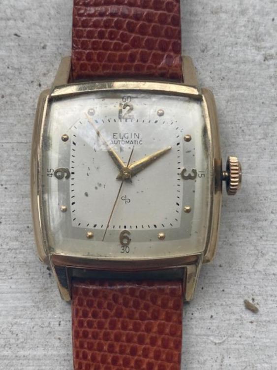

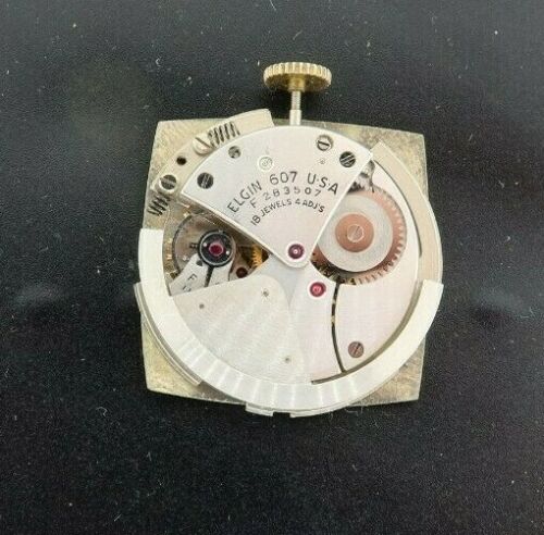

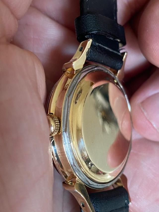

This little watch intrigued me so I wanted to see it for myself.
I wasn't planing on liking it so much, now I'd like a full restoration. The problem is that it's my 1st non-Swiss watch. I have no idea where to send it.
Does anyone know a 607/618 expert?

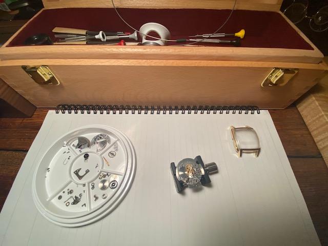

So...Instead of sending it out, I decided to go on a shopping spree.
I'm now researching lubricants and cleaners. Expensive little hobby you folks have here.
(And yes...I have a couple junk 607 movements to play with before the good one gets messed with)

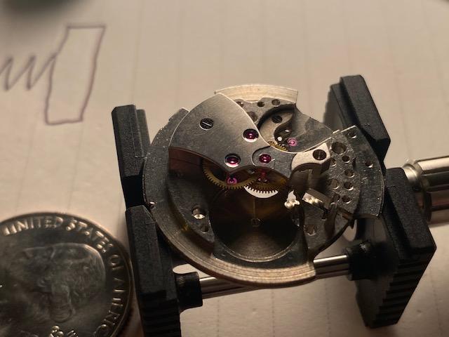

I had a bit of luck while looking for parts movements and picked up what looks like a NOS round case bumper. I'm not sure if it's a 607 or a 618 because I'm trying to locate a tool. I thought a "screw-ball" would do the trick but it is really stuck.
Beautiful though and almost/maybe 70 yrs old.

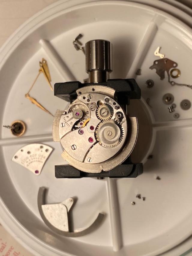

Now for cleaning...
1) Zippo ultrasonic bath for 5 minutes for everything except the escape wheel, pallet fork & balance/hairspring.
2) Remove from bath and peg wood all jewel holes & anything else that looks dirty.
3) Zippo ultrasonic rinse for another 5 min.
4) One-Dip escape wheel, pallet fork & balance+hairspring. Hand clean end stones & jewels on regulator w/ One-dip also.
5) Treat escape wheel & pallet stones with Epilame.

All clean and waiting on a spring winder from the UK. I started to assemble it but had to stop.
Everything went well except I think I'll wash the barrel & lid with the main plate next time because they were so dirty that they needed an additional rinse.

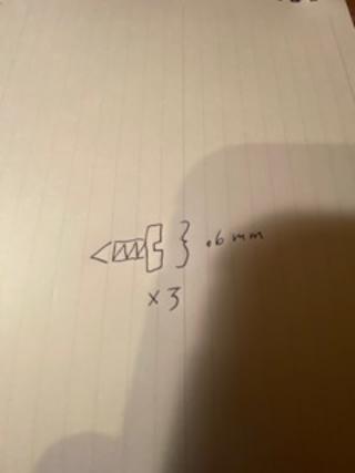

I found 3 tiny screws in the dirty solution that I didn't remove from the watch. That was puzzling. They look kinda like those screws on the balance wheel and are about jewel cap size but are steel. I never used my orange (0.05mm) screwdriver once but they are that size with a really pointy end.
Also, the yoke spring was horrible looking and appeared home made. It also looked like someone smashed it in there with a center punch & was a real problem to get out. Not sure what I'm going to do about that.

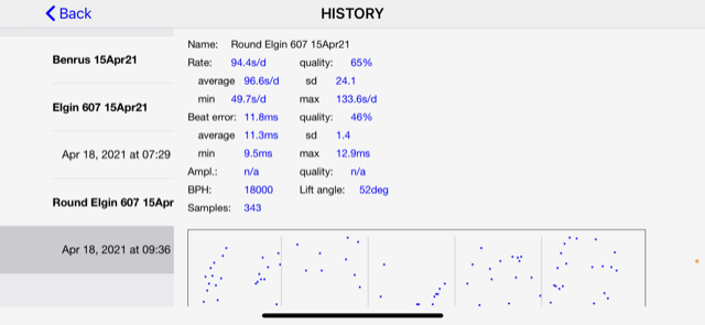

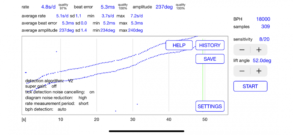

Here is a sample from the Timegrapher App.
The watch only ticked 343 times before stopping and it was fully wound. It didn't record a amplitude.

Are the screws for the dial?  They vibrate out sometimes.
Expand
They have a shoulder and are smaller. The only screws I've seen with a sharp point. No clue where they came from.
I did ultrasonic my oscillator bridge but the jewel cap screws are still on it. Plus, there are 3 of them???
The most satisfying tiny little click was when the train bridge dropped into place. I was tickling it for so long that peg wood fibers were accumulating on the gears. (about 30 min)
Next up was oiling the center wheel and I totally messed that up. I approached with a large drop of 1300 and it sucked it in so fast that I couldn't pull the oiler away in time. Lesson learned. No way I'm pulling the bridge off to clean the excess oil. I tried sopping it up with rodico but I'm pretty sure there is still too much on there.
The 9010 went fine. I switched to a smaller oiler and only put enough on it to lubricate the bearing. Same thing though, it sucked it in very quickly.
The pallet fork & cock where easy. Still waiting on the winder from the UK.

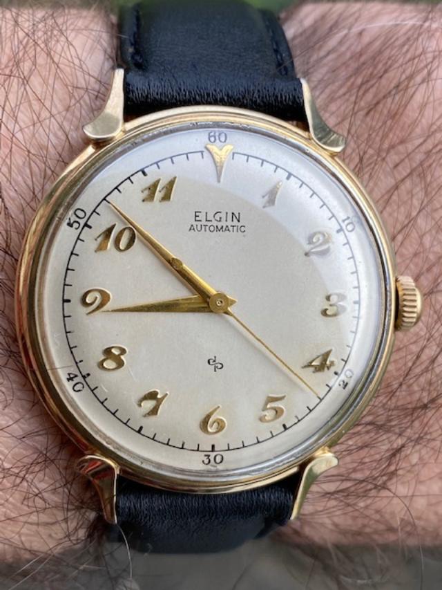

IT LIVES!
I haven't done the 9015 yet but the little fellow just really wanted to tick again.

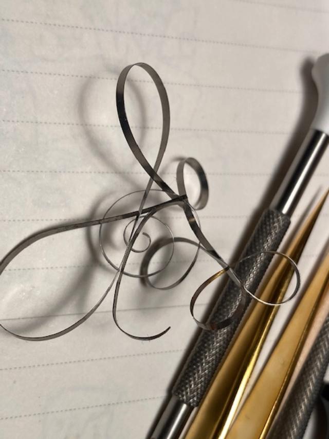

The winder came today and it's good that I had an old spring to play with because this happened twice when I was trying to reposition my fingers to feed the braking attachment into the winder. I got the hang of it after a few tries and my new spring went together without too much drama.
All back together & a new strap.
Apologies to Markr, the screws were from the dial & the 3rd one was the hairspring stud retaining screw.

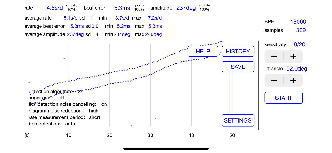

The timegrapher results were mixed. I have to work on correcting beat error & getting better at oiling.
And yes...It bump winds!
