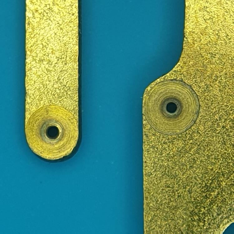

I posted about repairing the cracked mainspring barrels of tbis clock last year. The clock worked fine for a few months but it stopped completely a couple of weeks ago. There was totally no power transferred to the balance wheel. I removed the balance and found that the pallet fork would not unlock anymore. On examining the escapement, I found that the pivot holes of the escape wheel are worn.
I haven't done any rebushing work before. I can't even tell if this hole is original or has been rebushed before. The hole on one of the plates is in a very narrow strip of brass. I'm wondering if it is even possible to rebush this hole.
I hope more experienced members can take a look at the photos and advise me. Thanks.20210221_205337.thumb.jpg.870a178224b34cd4c2d899a830ebc950.jpg
Hi Hector   Both holes look original and dont appear to have been bushed.  The method in doing these is the same as any re bushing job, making sure you broach or drill the hole central. the attaced noted will explain the procedure.  I use a small drill in the drill press drilled under size (bush Size) and breach to fit thn broach the pivot hole.  when done try the wheel and the adjacent one for smooth running.

That's good for a first attempt, always check for end shake and make sure the wheels run free, it's a good idea when all is done to put the wheels between the plates  and tighten then check on the running as I said to make sure they run free try it at different angles and if all is well that will be a good job done.

I drilled out the oil sinks this morning. I'll test the escape wheel on its own first before fitting the pallet fork and balance wheel when I get home from work.
When I reamed the hole for the bush with my five sided cutting broach, it raised a bur around the edges of the hole. Is that normal or is it because the broach is blunt or am I using too much force?
My Seitz jewelling set also has D shaped broaches. Can they be used for bushing or is the taper angle wrong?
Bur around the edge is normal a simple way of removing it if you don't have the right tools is a simple pen knife blade. A D shaped broach is OK providing you have the correct size. Lantern pinions can be fun to replace and it's so easy. I have seen some nasty work done on them, instead of closing the hole with a punch they have run soft solder around, so if just one pinion needs replacing you have a task on your hands.

Hi Hector  Nice job  To remove the burr and create an oil sink I personaly use a drill bit in a pin vice for more control the same applies to the burrs posted by Old Hippy best used manually on delicate jobs.  Ok in the dremel for milling etc.
The clock has been running overnight. Thanks everyone.
I now understand what OH means by soft modern brass. The brass of the bush is much harder than the brass of the plate. When I was reaming the hole, I could feel the broach biting into the brass, but with the bush, I had to use a little more force to cut into it.
