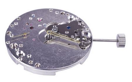

Recently signed up for the 1st course and purchased a 6497 movement.  It comes with the hour & second hands but no minute hand.  Can this be purchased and added?  I can't imagine a watch without a minute hand.

  On 11/18/2020 at 6:24 AM, Klassiker said:
Welcome. It looks like the hour hand and the hour wheel are both missing. Complain to the seller.
Expand
Yes, I can clearly see that now.  Unfortunately, the picture shown is from the seller clearly showing no hour wheel or hand.  I was duped, I guess??  I suppose I can buy an hour wheel and hand for $35 once I learn how to install it :).  Thanks for your reply.  It's not financially viable for this watch but it's the first watch I'm learning on and I'd like to eventually wear it with pride knowing I can take it apart and put it back together.  Seems impossible to me now but I'll keep pressing on.
