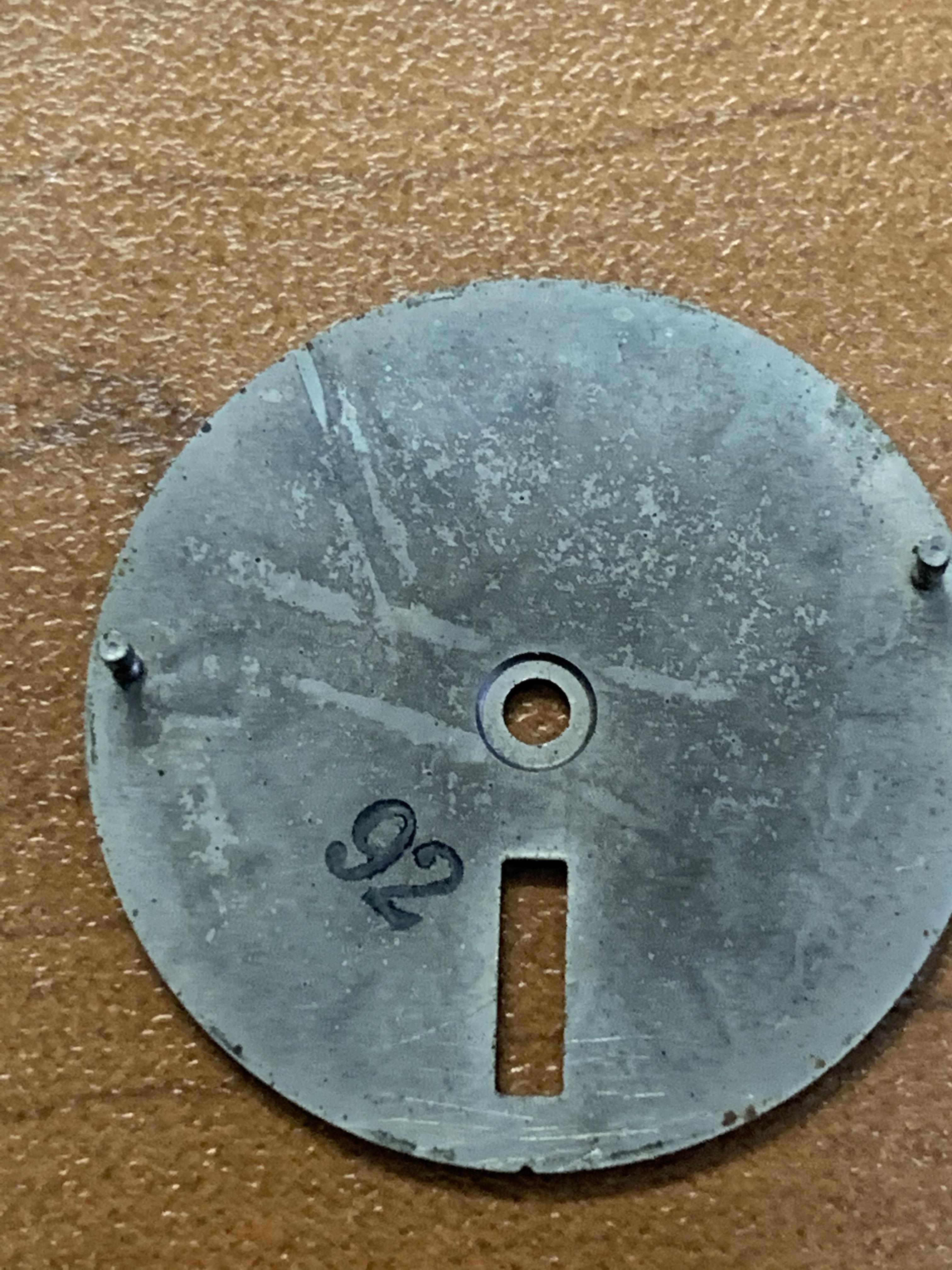

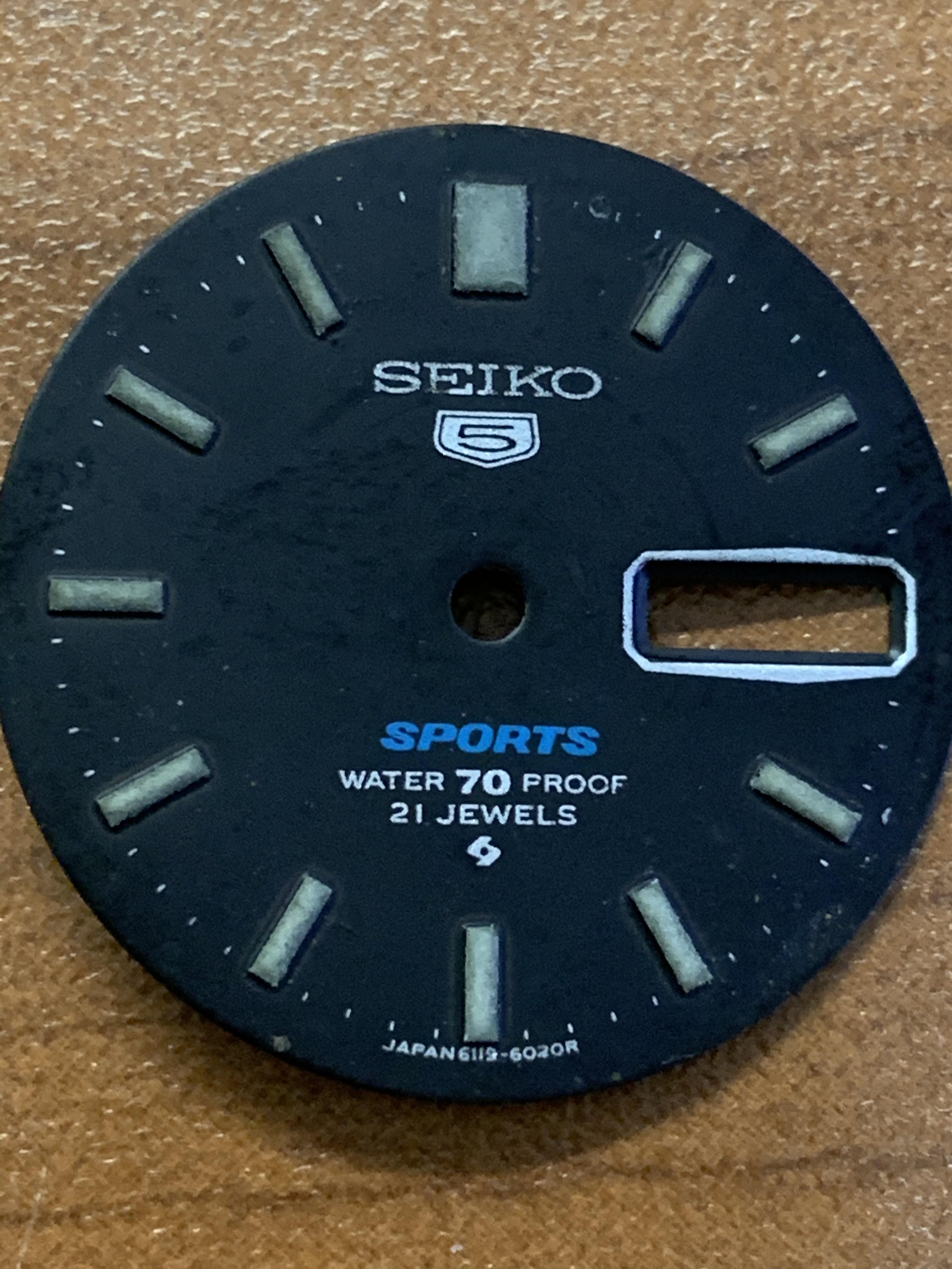

Seiko 6119-6020
53 minutes ago, Nucejoe said:
Date window frame, printed logo as opposed to embossed.
Checking images online it would appear that the date window should be printed (like yours) rather than embossed.
21 minutes ago, LonglineOjoe said:
What about the dial codes
It would also appear though that the dial code is normally printed inside the minute track either side of the 6 o'clock index, not outside the minute track as your is.
