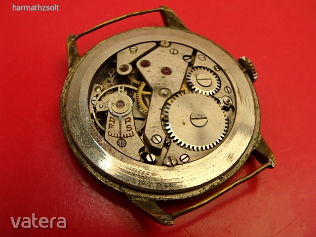

I bought a watch on an online auction site, Afra Watch is written on the dial. Now it is unlikely that I can put my hands on it this year as it goes to my parents place 2000 km away and I think the restrictions will get worse by the day. So I only have the pictures from the auction site I cannot take other pictures or I cannot get the movement out of the case. I am keen to learn more about Afra Watch as my daughter's name is Afra. Tried to google it but got no useful result apart from one Afra Watch for sale on a site. Would you recognize the movement based on these pictures or have you ever heard about Afra Watch? Any input would be appreciated.

According to mikrolisk, Afra was a company based in Vienna Austria. Dr Alex Frankel is mentioned alongside - almost certainly therefore the company's name being formed from his name.
Obviously not your movement but ranfft has mention of an Afra watch using a Helvetia movement: http://www.ranfft.de/cgi-bin/bidfun-db.cgi?10&ranfft&0&2uswk&Helvetia_33LI
I don't immediately recognise your movement but hopefully someone else will. In the meantime the titbits above might give you a few more clues to search around.
AS1123 or 1124 depending on size of main plate

I found that on ranfft and started to read the history of Helvetia, but they have not mentioned Afra anywhere. What is mikrolisk? Mikrolisk.de? Search doesnt give me anything for Afra. Thank you for helping.

Thank you. I used the wrong search box, those years teaching me german were all wasted. ? Based on internet history I could find these Afra Watch-es, on Austrian, Polish, Ukrainian and Czech auction sites. And this one is a Hungarian blog where you can also find an example of an Afra pocket watch (and many other watches): Afra Watch
