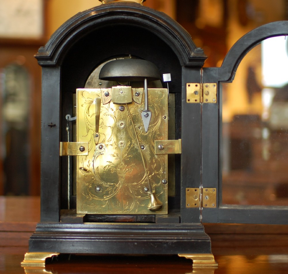

Still waiting for a winner. One is causing a bit of a problem, someone is very close.
Clock A painted case is typical of one European country  and is reminiscent of  a Mora clock also from that country so I would say Sweden
Clock B is a triple pad top verge fusee and is English
Clock C is a German Lenzkirch bracket clock in walnut veneer case, these turn up quite regular a small movement in a large  case around 1900, popular at auction and in good condition fetch £600-£800  with all Ting Tangs its the case that makes the difference in price.
Clock D  The model T-Ford of the clock world produced for ease and low cost of production for the masses typical American
Thanks to those that took part in this little brain teaser. Looks like A caused the problem. Well done if you got them right.
Sweden
England
Germany
America

I do own a horological mystery clock, that no one has ever been able to attribute country or maker to they turn up now and again its large 8 bell bracket clock with St Michael chimes and is spring driven with a unusual off set barrel arrangement and underslung bell nest. It has many attributes that make people either say French or German, but many think they come from Slovakia I shall make a seperate post of it and see if anyone knows.
