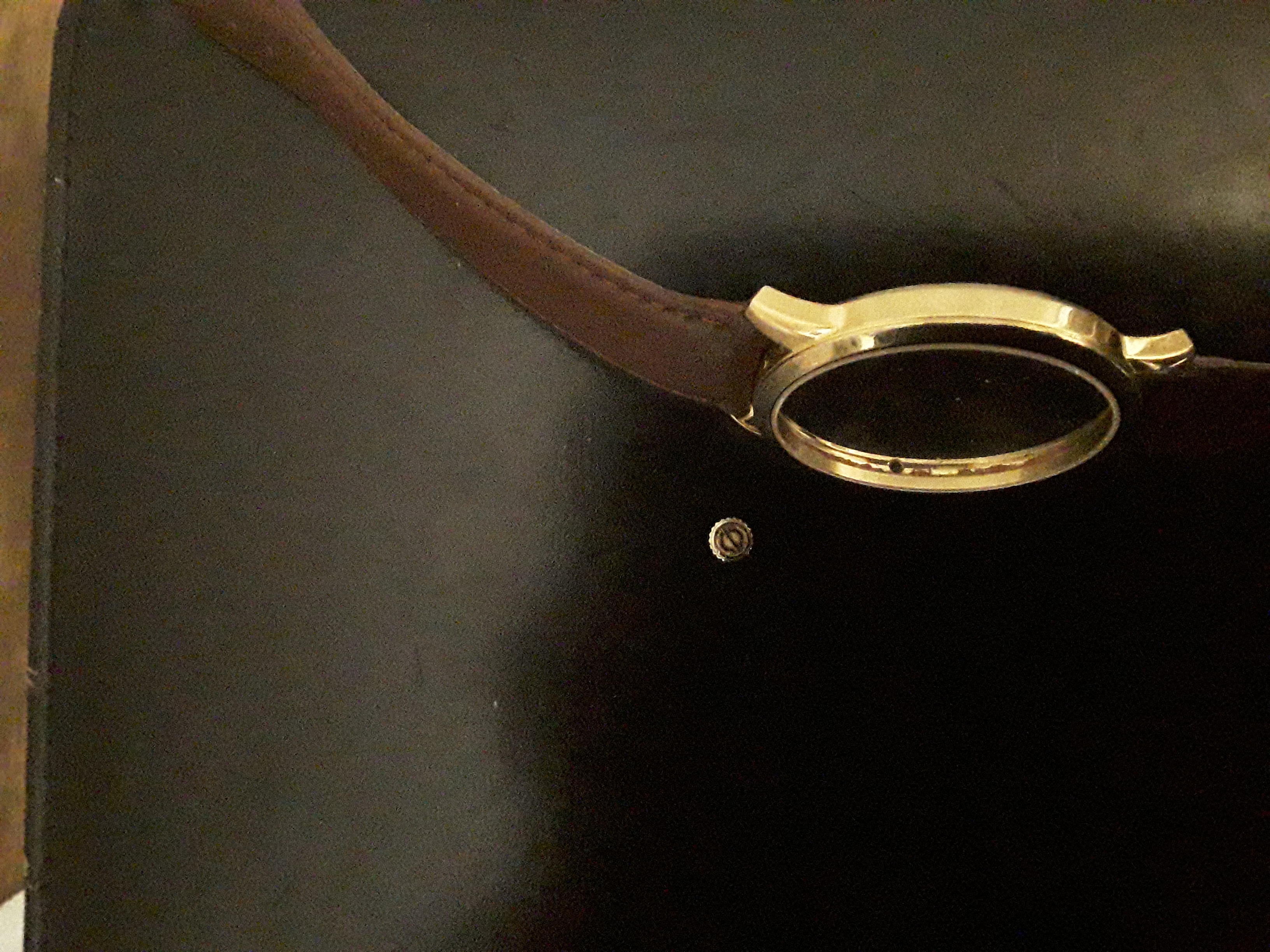

Have a PVD coated winding crown with stem broken in it, wonder if alum destroys the PVD coating?
Its yellow gold tone PVD.

Its just a Swiss candino $150 quatrz watch so no gold I suppose.
Would a picture help.
How do you determine what material or if affected by alum, that is the question.
Hmmm... Besides the coating, we don't really know what the crown itself is made of either.
In you position, I'd source a generic "gold" crown for it, and either run with that, or wait until that is in hand before experimenting with the original crown.
Is it a screw-down crown, with a spring loaded "clutch" mechanism inside, or just a tapped solid? If it is a complex assembly, it might not be a good idea to introduce chemicals that could effect the other components of the assembly.
I think if you used an oiler, to place the solution precisely, you might be OK working on a solid. But, I'd still want a "fall back" plan on hand, in case things went wrong.

Its a signed crown and taking a bath in alum right now.
 I do have good quality genuine Swiss gold plated crown fhat would fit, unsigned though.
Will let you know if it like the bath or not by your evening time. :D

Alum worked with no damage to the coating.
 Someone may recognise what this coaing is by the picture.
Took alum several days though to dislove the stem.
Hope this helps.
