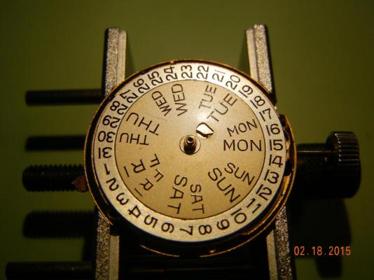

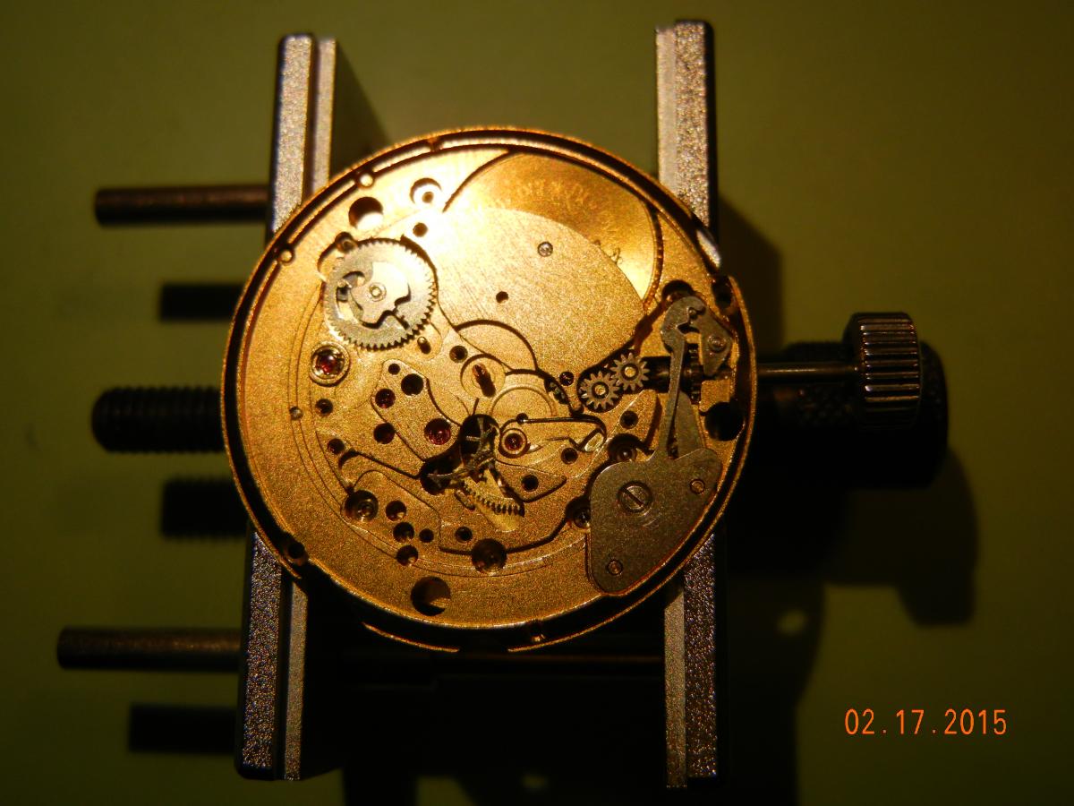

Finally was able to get the notorious KIF elastor in place. This was the third spring I tried after having broken a wrong one trying to squeeze it in (it looked ALMOST the same!), and having two fly away into oblivion one cold, dark night here in Brooklyn: I curled up into the fetal position and went to sleep after that. Well, I reached out to a great help known as RustyColt around here, and he sent me not one but Three of the correct KIF elastor 3-2 springs for this movement, which is the Bulova 11ANACB. Here are a few pics. The movement remains uncased--I am overloaded with school work right now and unfortunately have to prioritize myself if I want to finish up this year. In any case (no pun intended), I want to say thanks to RustColt for the help in getting the correct spring.
post-328-0-29264500-1424402452_thumb.jpg Finally got the little bugger in with the help of some super-pointy Erem tweezers and cling wrap.
Coming together now...and ticking nicely
