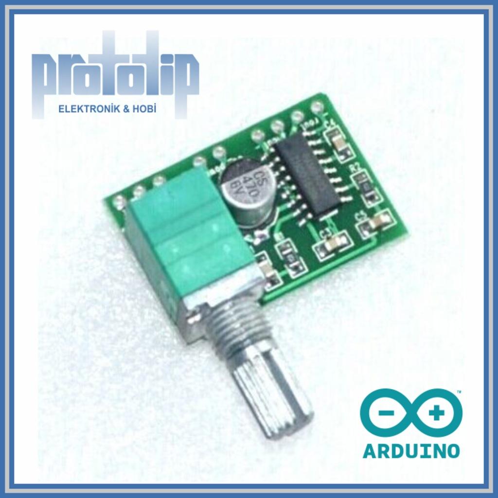

Hello,
I tried Watch-o-scope and Tg programs when I started out this hobby but I got no results and I just decided to spend a week timing the few watches I service bu yesterday I say Jd Richard's video on time graph softwares and tried trickoprint on my phone whic worked fine and gave me a reading, I don't know if it's accurate or not but I was really happy to see a reading anyway.
after that I did some research with the help of uncle Google and I found that to get better results I have to get myself a Preamp  which I didn't even know such a thing existed :woohoo-jumping-smiley-emoticon:.
anyway I found a couple of really cheap preamps and I am almost certain that they wont work just because it's me and I never get stuff easy but I decided to ask for advice from you nice people.
this is the first one (no specifications):
arduino-pam8403-mini-digital-amplifier-board-2x-3w-2-kanal-5v__1167810222652033.thumb.jpg.4f4ca9cb36f7ee7949a5ae9e9e9392dc.jpg
and this is the other one which they have the specifications for:
arduino-pam8403-mini-digital-amplifier__1525545752135368.thumb.jpg.7a3b84930e90cb9ba80dba9f2716f7f7.jpgarduino-pam8403-mini-digital-amplifier__1072380814283852.png.ca957553aac570dcda9910241d703249.png
From what I have read I should use a Piezo mic with these which is available as well.
please note that I know very little about electronics I just have a soldering iron and a cheap multi meter, also it's not like I don't want to buy a proper timegrapher but I can't afford spending 200$ as I have been unemployed for a long time and even when I was working I was getting paid like 300$ a month but I would have managed to save up.

Hey! Something I know a little about for a change! To start, it's a little confusing, because the first and second pictures are not the same board. They do appear to be using the same chip, so consider the following:
An audio pre-amp takes a low powered signal (like from a microphone) and makes it bigger so that a larger amplifier can take over and put it to speakers. In your case, the larger amplifier is in your computer/tablet/phone.
That particular device (first image), assuming the screen printing is to be trusted, wants 5V, which is right about what you get from a USB port. You could also very easily find a 5V DC wall wart at Mauser/DigiKey (or Turkey's equivalent if that's not an option), and run it off that if it helps declutter. They edited out the chip screening, but I'd bet money it's a bunch of op-amps ganged up into a single package. I know that probably means nothing, but essentially it's likely a bunch of even smaller amplifiers all in a line to make a larger amplifier.
Once you have either broken out the power leads from a USB cable or a DC power supply, the bottom left is where you'd put the Left and Right outputs from your microphone setup. You probably won't be using a stereo microphone, so you can either pick one, or run it to both. To get it to your device, you run the audio plug to the L/R channels at the top of the board.
The larger board with the green thing and the knob looks like it's essentially the same thing, but it gives you the option of a power/volume knob. If you follow the above instructions using the printed labels rather than spatial description, you'll get essentially the same result.
That's how... The question though is whether or not it'll get you there. If that board were dropped into my lap, and I was told to use it to make a microphone work on a device, that's how I'd do it. I can't say for sure that's the exact correct device for the job, but the fact that it is likely marketed as an audio preamplifier is promising. If it's only a few bucks, I say jump. It'll likely get you where you're going.
The one caveat I see is that in some of the results I'm finding, the pictures show the outputs going directly to speakers. 3W isn't huge, but it may be more than your device wants. This could either mean you're better off with a different chip or at least the one with the knob so you can turn it down.

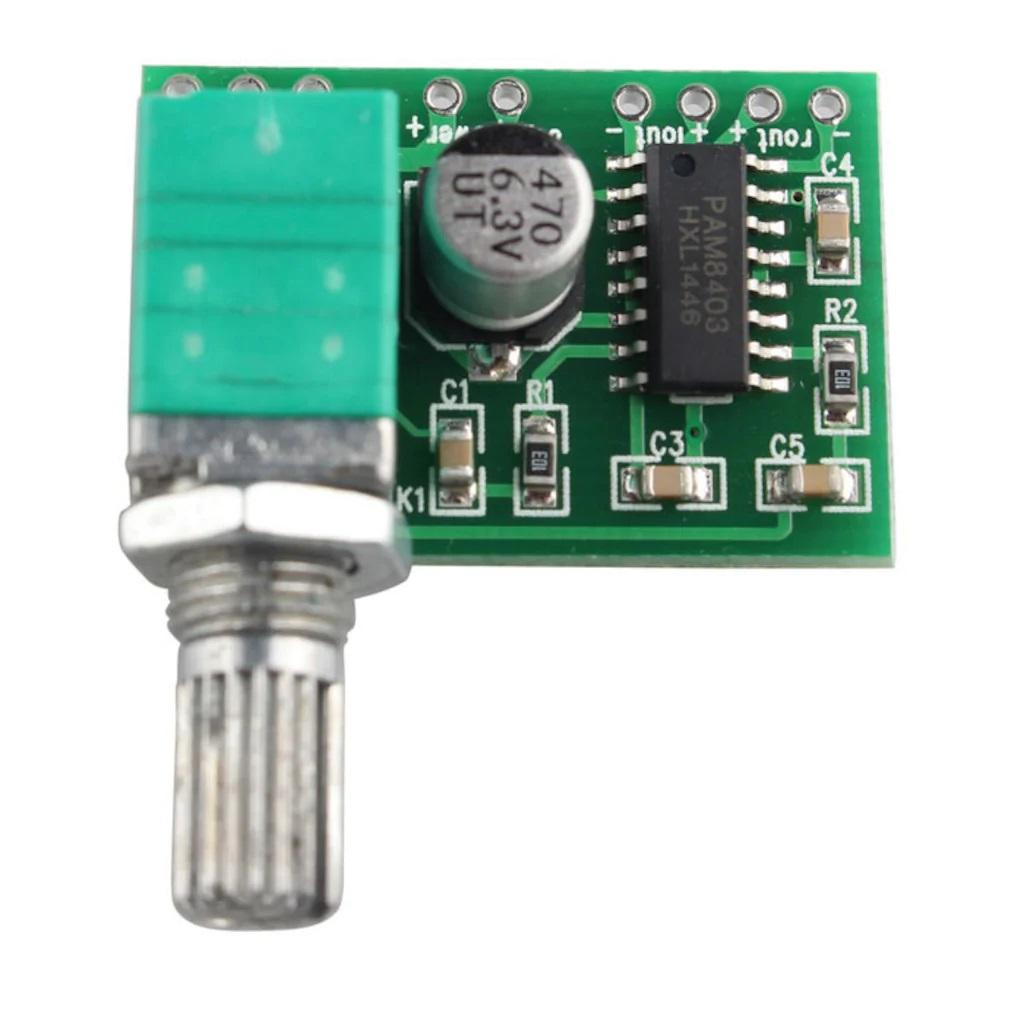

Thank you for the explanation, I found some better photos from another seller if that gives you more information, now I don't want to mess this up as I usually tend to do let me tell you what I understand:
so the r-out l-out are basically where the speakers are connected but in my case it's where I connect the cable with the 3.5 mm jack going to the pc/phone.
The 5 volts is the easiest part I can connect it to usb or 5 v wall adapter as you mentioned but I read somewhere that it would cause some humming or noise and it's better to use batteries but it looks like 5 v batteries don't exist.
The input side is where I connect the mic and this is where I'm confused because there are 3 connection points and no polarity and the mic has only two wires and what exactly does (L,G,R) stand for.
Thank you very much for helping me.111.thumb.jpg.55600a3e3926a22d4f0e51f82c3e6849.jpg222.thumb.jpg.6132dcf854a96e24fc169e5fd5bba311.jpg

So... The hum they're referring to is the AC cycling polarity... In the US, it's 60 Hz and sounds like a low hum. I have no idea what the AC frequency is in Turkey though... If you're playing an electric guitar with a lot of distortion or a hifi audio system at high volume, yeah, it sucks. I doubt this will come through in a way that would affect a watch analyzing program. If you want to play it safe though, power it via USB. That uses your laptop/phone battery, and the AC cycling is fully out of the picture. I seriously doubt a quality power supply would give you any issues though, and it's less trouble to wire up if you don't know the pins on a USB plug.
Quote
L is Left channel, G is Ground, R is Right channel. You microphone has a signal (center) and ground wire (green or jacket). You can either pick a channel, or run the signal wire to both. If you go to just the one channel, and the software is only listening on one, you have a 50/50 shot of success, but it would get 100% of the signal if you guessed right. You could get around this by wiring the stereo output in a mono fashion (I think that still works with modern audio...). If you run it to both AND the software is listening on both channels, you effectively get double the output from the amplifier.
It would be handy to know what the input impedance is a piezo transducers are high-Z (often around 10K Ohm). The data sheet for the chip may say.

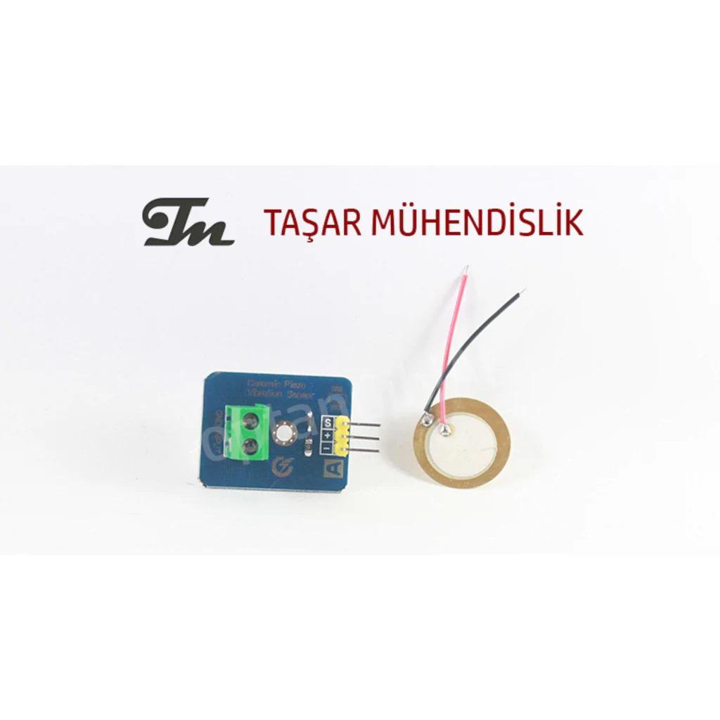

I found this Piezo Mic with this small chip but I have no idea what this is and what does it do, do you think I need to get it with the Piezo or it's no required for my little project seramik-piezo-titresim-sensoru__1174116611590828.thumb.jpg.75082df1cdc73639f434eda5d7ce2f02.jpg
and this is the description of it as posted by the seller (translated it on Google because I don't know the Turkish terminology of electronics):
Working Voltage: 3.3 V or 5 V
Working Current: <1mA
Working Temperature Range: -10 ~ + 70
Interface Type: Analog Output
Product Size: 30mm x 23mm
GPIO: S; signal output, +; power supply (VCC), -; ground (GND)
Introduction: Positive electrode piezoelectric ceramic
Gnd: Negative electrode piezoelectric ceramic
S-point with connected controller's analog input pin
5 V and GND respectively connected to the power supply + 5 V and GND
Already piezoelectric ceramics associated with the inlet and Gnd 'positive and negative.
Thank you.

To be completely Honest I have no idea what this means, but in case you mean the chip on the circuit I found this data sheet online.
https://www.diodes.com/assets/Datasheets/PAM8403.pdf

It doesn’t mention on the data sheet. Incidentally, this is really a power amp for driving a loudspeaker, but I expect that it will work acceptably at low gains.
Something like a phono preamp may be more suitable, especially if you were able to modify it to remove any equalisation:

Looking deeper, I think rodabod may be right. That does look like a higher output amplifier than you'd typically want for a preamp. 3W per channel sounds small to me, but my amplifiers are all quite large by comparison and not pushing little computer speakers or whatever. That's not to say this necessarily won't work, but it might want a larger signal to start than the mic puts out on its own, and could put out more volume than the software knows what to do with. A phono preamp is the exact thing you're most likely looking for, and should play nice with most microphones.
As for the piezo microphone, it looks like it'd play nice on the power side, but the output isn't mentioned (nor are the signal input ranges mentioned on the amplifier).
https://www.sparkfun.com/products/12758
These guys are local to me. Good people, good products. This is your microphone and preamp all matched, soldered, and ready to go. Give it power and ground to the respective lugs, and then your audio jack does signal and ground to the same.
