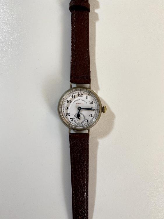

I am lucky to receive my grandfathers 'West End Watch Co - Matchless' watch that my father tells me he bought whilst in India during the second world war. Its a sentimental piece and i want to get it up and running and return it as a gift for my dad.
The bit i am having difficulty, (at the moment, there will be more i'm sure!) is the 'glass'. I say glass as i believe this is acrylic.
I have removed this and taken photos for inspection. It appears the recess in the case looks about 1mm deep and measures 27.8mm. I have had a look on cousins website and the variety is so vast that its leaving me more confused the more i study it.
Has anyone any advice they can offer me, it will be greatly appreciated.
Hope everyone is keeping safe and well.
Aidy.

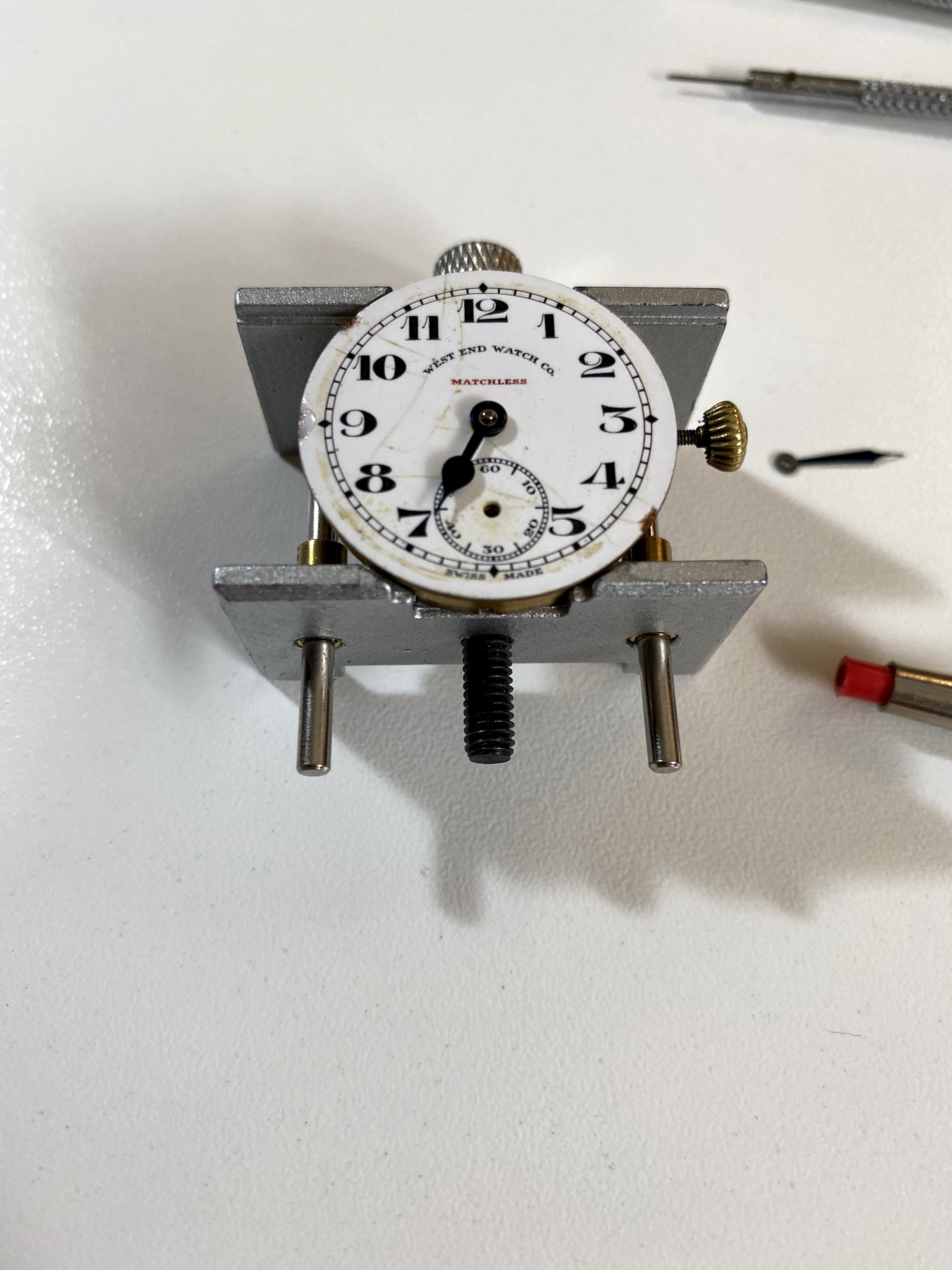

I ordered a Sternkreuz 28mm 'glass', as well a 3 more of different sizes as they where all a few .2 of a mill off, loaded the 28 into the press and after a healthy click sound and a heartbeat flutter it was in!
The watch has now been stripped, cleaned, oiled and put back together, BUT,
The second hand was giving me problems not sitting into the jewel location (second wheel pin is it?). I tried a few times but feel i might have damaged it as on closer inspection the very end 'pin' section now looks a great deal shorter than it used to. I'm guessing that pushes in to the center of the corresponding wheel on the gear train? (Still learning this hobby).
Can i order a new second hand or do you think i might have caused damage to the corresponding gear pin?
There wasn't a great deal of room when this was originally seated, created by a a dial that only has one dial screw that holds on side of the dial in tight, and the other having a corroded screw that doesn't remove yet doesn't grip the dial too well, this leave the dial slightly proud of the movement which ultimately reduces the clearance on this accessory dial (Second hand) in this case.
Bit stumped now as what to do. Somewhat disheartened as the watch runs really well and looks vastly improved and keeping to my original goal. But, without a second hand it looks, well odd.
Any advice would be appreciated. Thank you once again for taking the time to read my comments,

From what you are describing regarding the fitting of the sub-seconds hand, I’m wondering if you have snapped the pivot off the 4th wheel.
Just for clarity, the 4th wheel is the 4th in the train if you start counting from the mainspring barrel. It has an extended length pivot to carry a seconds hand.
Is it now the case that when you look into the dial hole, there is barely any length of pivot left to secure the seconds hand to?
My fear is your correct, I haven't stripped it back down to inspect the 4th Wheel but all evidence leads to this. Assuming this is the case, is there anything that can be done?
I'm guessing replacement 4th wheels are not generic and specific to the movement, a brief search on cousins doesn't result in much luck.

So, you may find that the subseconds hand’s pipe contains the remnants of that pivot if it remained attached.
What we need to do is identify the movement and find a spare. Shouldn’t be too difficult. Since this is an heirloom, if you can’t find a spare wheel then I will give you one of mine. But let’s try to find a spare first.
Could you possibly post a “can you identify this movement please?” thread and see if anyone recognises the model? It will be one of the main Swiss manufacturers of the time like FE, FHF, AS, etc.

So, an update to my repair.
This watch has taught me a great deal about watch repair. In some respects, working on earlier movements has given me more of an understanding of the mechanics of a manual wind watch. The movements based on simplicity, without getting too complicated, and what a joy it was to do.
In the end it was taken apart 3 or 4 times to overcome hurdles, aligning the bridge above the gear train to get them sitting perfectly in the jewels was quite an experience, thinking i've cracked it then then it would stop, only to find the hour and min hand colliding, then getting the click spring to catch perfectly through a plastic bag as i have a habit of making watch parts fly around my room.
My biggest mistake was removing the front cap, slipping and colliding with the second hand which sheared off the top of the 4th wheel pin in which the second hand sits upon. A massive thank you to Rodabod who kindly sent me a matching Cal 59 movement the day after posting on this forum, which allowed me to replace the 4th wheel, then rebuild with the second hand now sitting correctly on the pin.
And it works!
I have it on my wrist and feel immensely proud. I am doing a shop for my dad this week and he doesn't know i've fixed it yet, i can't wait to see his face.
Thank you to everyone who has given advice and helped me out on this post, I've learned a great deal from this and the watch bug has fully hit me. Once again, Rodabod, thank you.
