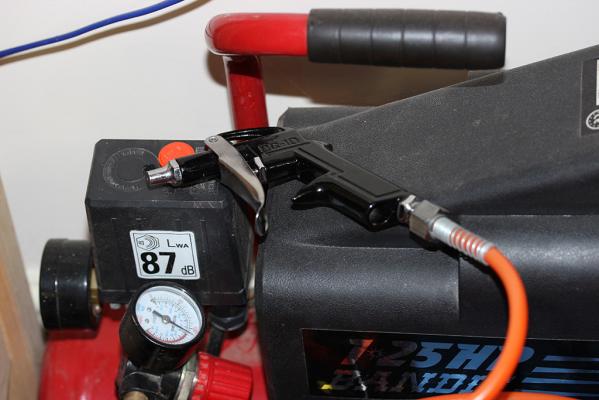

It's mineral glass epoxied in so two obvious solutions would be to break the glass out (not easy - it's domed, plus don't want to risk damage to the movement). The other option is to heat up the case - not really an option as it would potentially cause damage to the movement.
So my compromise solution - to use a diamond round head drill to make a hole over the bolt screw so I can take the winder out - then blow the glass off with compressed air through the pendant tube. And the glass just popped out, no damage at all.
After drilling.
Winder is out :)
Sealed the hole in the glass with some rodico and created a seal around the pendant tube with a tiny hole for the compressed air to get in.
This is the compressor attachment I used - a dust blower which I use for blowing dust out of a case before re-assembly.
And the glass just popped out with no problems. Sweet  :thumbsu:

Mark what happened to using the large hypodermic and a plastic bag (as per video)...lol.
Oh no a 1hp air compressor...Brilliant!
The syringe was not powerful enough - that epoxy was strong.
The air compressor was overkill but did the job very well  :jig:
