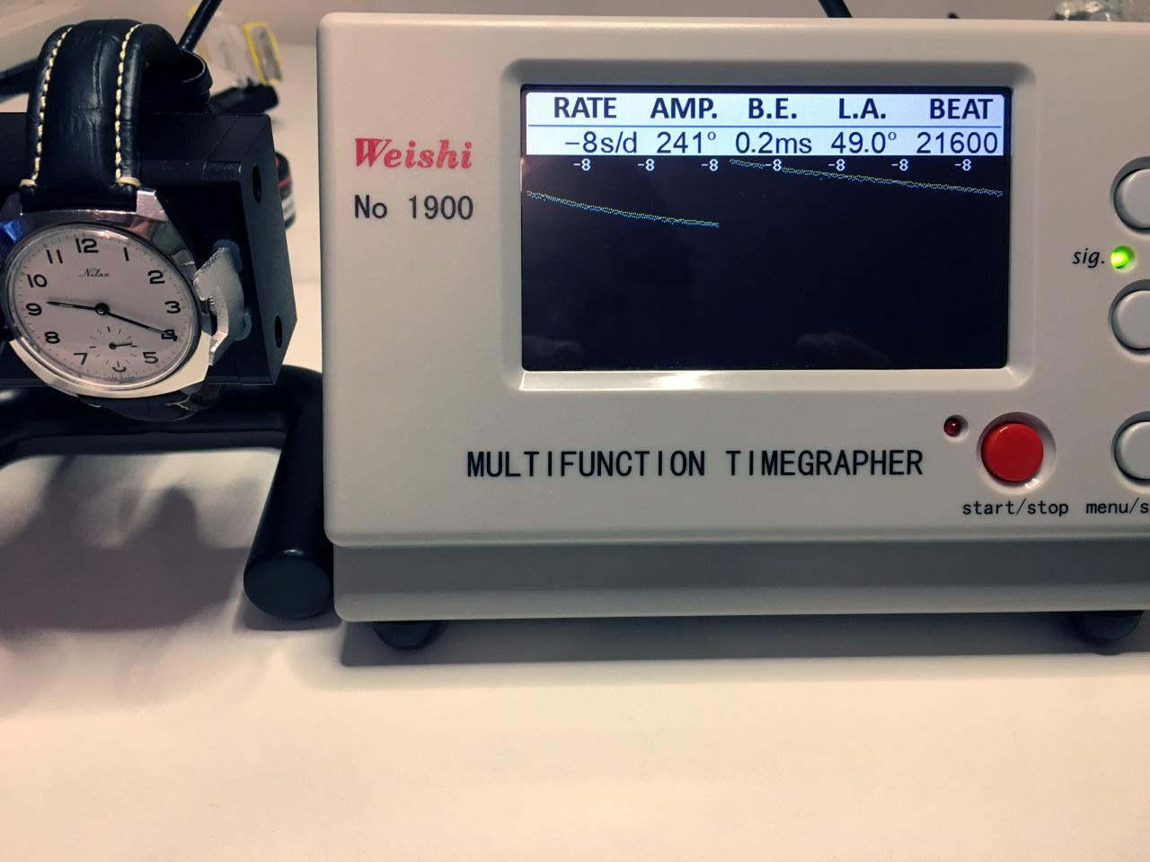

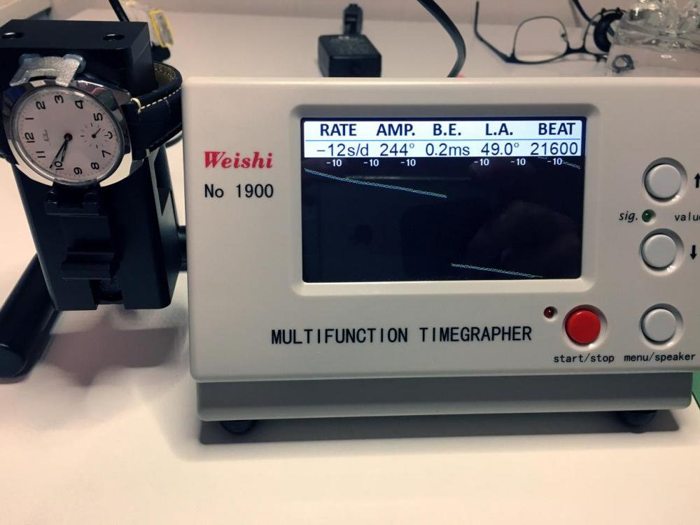

So, finally my very legible Unitas 6325 ”amplitude problem child” has been re-assembled. Timing machine images below. I started the reassembly weeks ago but as I was fitting the click spring it decided to launch for outer space, never to return. Anyway, CousinsUK had the click spring in stock and delivery to Sweden usually just takes a week. However, my local mail delivery “decided” not to inform me and not to deliver it after it had arrived. Instead, three weeks after my order, they informed me that they would send the package back to England if I did not pick it up. How very, very annoying! Anyway, when into watches there’s always something else to do meanwhile, like servicing an ORIENT movement and replacing an ETA cannon pinion with driving wheel, and…
The current amplitude is maybe not perfect (not sure what is to be expected from this calibre) but it is now in the acceptable range, especially considering it started out at 200 degrees dial up/dial down. The graph is a bit wavy and I guess the reason could be that for some reason the power isn’t perfectly and evenly transferred to the escapement. Anyway, I think I can live with that, and as I said, not sure what should be expected from this calibre. Perhaps my copy is a bit of an odd one.
My original plan was to try to locate the source of the low amplitude, but I ended up doing several adjustments before reassembling. This is what I did:
  • Adjusted the hair spring with the help of @nickelsilver's excellent illustration. Again, thank you!
  • Stripped it and ran in in my (ancient) ELMA cleaning machine.
  • Meticulously pegged every bearing and jewel hole including the barrel. Then rinsed and brushed the parts in IPA to get rid of any peg wood residue, carefully inspecting everything to be spotless.
  • Polished every single pivot.
  • Replaced the mainspring with a brand new Generale Ressorts spring.
  • Replaced the jewel for the third wheel in the main plate as it was slightly cracked. There was a super tiny groove on the pivot, but I decided to keep the wheel as this post by @rodabod made a lot of sense to me.
  • Checked and adjusted the end shake of every train wheel individually. By doing it one wheel at the time I could use my stereo microscope to actually see and not just feel the end shake. To the best of my ability I adjusted the end shake of all wheels and the pallets to about two hundredths of a millimetre. That is, barely visible even at 40X magnification. I used my jewelling tool for this operation and with this in mind for inspiration.
  • Applied Fixodrop on the pallet stones and lubricated with Dr. Tillwich 1-3. I think I’m beginning to prefer this oil over Moebius 9415. I have no evidence whatsoever that it is “better”, but it has worked well for me several times now, so I will probably stick with it

Thanks @VWatchie; some movements are what they are. Not all of them are high flyers but can still be very good & accurate runners. Looking at the pretty constant positional amplitude and corresponding daily rate, this is one of them! There aren't many watches which receive as much TLC as this one and therefor it will serve you well ..... that's an universal thing ;):biggrin:
I commend you for your pursuant and dedication; Well Done !!   :Bravo:
Edited by Endeavor
Thanks guys! Adjusting the HS, replacing the cracked jewel, and adjusting end-shake using my jewelling tool were the three major learning points for me. What caused the low amplitude is of course difficult to determine having taken so many actions at once, but I guess the combination of adjusting the HS and replacing the cracked jewel probably is what did it.
