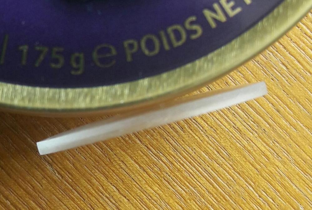

After assessing my options, I decided with gluing acrylic rather than a "pressable" one with a tension ring. There's no local shop around me that offers acrylic with tension ring, let alone the correct dimensions. I had to sand down the acrylic crystals I got to make them the right size. I used GS crystal cement to get things going, and so far so good. It's also by far the cheapest option as I barely needed any tools for the job.
The only thing I still find ambiguous is, how tough is it to remove the crystal in case I want to replace it in the future? And how hard is it going to be to clean up after the glued crystal is removed?

The thing is, when I safely removed the crystal and its gasket, there is really no flat area where I can apply the glue on. The big flat area that you see is for the chapter ring, and not for the crystal.
I suppose a tension ring crystal might work in this case, but no place in my area has them. I cannot justify paying 25usd shipping for a 10usd crystal either.
Am I out of luck for doing it on this watch? What about acrylic crystals with straight walls?
Hi there, acrylic crystal with straight walls will work with uv glue or slightly bigger than the diameter of the opening. However you will lose any water resistance in that manner. But if you like the look of it then why not. Just remember to take it off before getting wet. On second thought I would go the slightly bigger method as the glue may end up on the chapter ring and you'll have to do it again. Use a crystal lift to put it on. Hope this helps and if you look around you can find thicker acrylic crystal for diver watches then you can glare at the crystal distortion from the side you will enjoy. That's a nice watch
