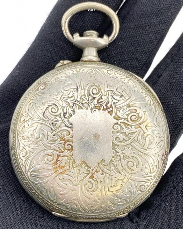

I’ve got an old Longines pocket watch (1897) that I want to try and overhaul and restore.  I’m kind of falling at the first hurdle though as I can’t get the movement out of the case as the stem is rusted just situ.  This model has a pin set and this to appears to be rusted.  The crown has broken of level with the top of it’s entry place into the case so I have nothing to get hold of.
I’ve got some Horosolve rust remover, some wd-40, some 3-1 penetrating oil and some Elma 1:9 watch cleaning solution.  Quite a bit of the movement has got rust on it so could do with going in a bath of Horosolve but I was planning on taking the movement to bits and soaking the individual parts.  As I can’t get the stem or pin set out, I’m a bit stumped.  Should I just soak the rusted parts in 3-1 and then try and remove them?  Or put the whole watch (including the case) in Horosolve?

So I dropped a few drips of penetrating oil onto the wheels on the back of the movement (crown wheel and ratchet wheel) and all the other gears, pivot holes, etc. that I could see but it was still all gummed up.  So I dropped another few drips onto the screw holding the click and also dropped a few drips down the space left by the top of the broken winding stem. Left overnight and tried again.
Releasing the click got things moving!  Both the ratchet wheel and crown wheel turned and now everything seems to be moving.  However, I still can’t get the movement out of the case as I can’t pull out the stem (Should it just pull out?  Or is something else going to be holding it back?). Also, this movement has a pin set and that’s held fast too.  The good news is, I’ve been able to remove the tiny screw that holds the stem in place.

Took ages for the penetrating oil to release the screws holding the bridge and the ratchet wheel in place, but finally got them out.  The bottom screw in the Longines bridge wasn’t screwed in - not sure if the screw is too small or there is no thread inside?  There is some rust staining under this bridge too.
In this picture, I have circled too issue areas - red being the end of the winding stem; this is rusted solid.  I can’t pull the stem out because it’s rusted to the sleeve (is that the right name?) but once I take the train wheels out, I’ll be able to remove it from inside.
This next picture is the front and you can see the rust again and in the red circle, it’s quite bad.  The component on the right in the circle I think is the Pin set;
Here is the Longines bridge removed, also with some rust staining on front and back.
What is next now?  I’m assuming the remaining bridge is the next to come out?

I finally managed to get the main bridge out- after loads and loads of penetrating oil.  Strangely, neither screw came out rusted!  But there we go.
Here’s a picture of the movement without the main bridge .....
I’ve labelled the wheels - hopefully I’ve got this right?  Only my third wheel has a pinion on the top of it - which is different to what I expected?  Anyway, I can’t get the second wheel out - it wobbles but will not come free- I think it might be rusted to the canon opinion?  I finally managed to unscrew the retaining screw that was holding the movement in the case and bingo!  I got the movement out!
As has been predicted, this movement has almost certainly had it but I’d like to keep dismantling as a learning exercise.  So, can I drop it in some Horosolve Horelex Rust Remover now to try and get the worst off?  Or will this stuff melt / dissolve / damage any jewels still in place on the movement?
