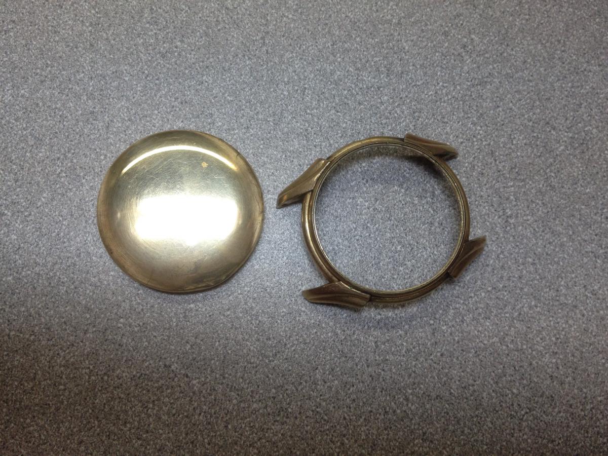

Since there is no glass at all on the watch, I am in the unfamiliar position of trying to locate a replacement blindly. Any suppliers I know of require a case reference number, which does not appear to be available on this watch.
post-456-0-95515600-1419887314_thumb.jpe
post-456-0-97572500-1419887371_thumb.jpe
This brings us to my first uncertainty, how can I determine which type of crystal is right for this watch. I can measure the diameter, and determine an appropriate dome/height, but I do not know how to tell which type of fitment the case is machined for. Likely, a typical snap in, but how can I tell?
The hands are incorrect for this watch, and are in poor condition, so I wish to replace them. I posted a link earlier to an example which I believe to have correct hands. Again, a case number is necessary to track down a Longines part reference, so I expect I will need to hunt down bulk hands from somewhere which match as closely as possible. If you have a lead on a supplier with a large selection of bulk hands, I'd be grateful for the lead. The usual suspects all have a pretty generic selection, so I'm moving the hunt to the next level.

I decided to send out the case and crown for replacing. The 10K RGP finish on it was in decent condition, with a little bit of honest wear, and more than a few service engravings. I wanted the finished watch to reflect some of the history of itself, so I took care of the preparation and polishing myself, making sure to improve the appearance without buffing out the sentimentality. The replating was a cosmetic decision. Mrs RustyColt dislikes yellow gold, and I was concerned that may discourage her from wearing this watch, regardless of emotional connection. I found a plating service in Vancouver, BC that could do the parts in 18K rose gold, and was fairly pleased with the results. It turns out that the plater I chose does not do a lot of watches, and I think that they are used to much larger parts. In the end, all was well.
