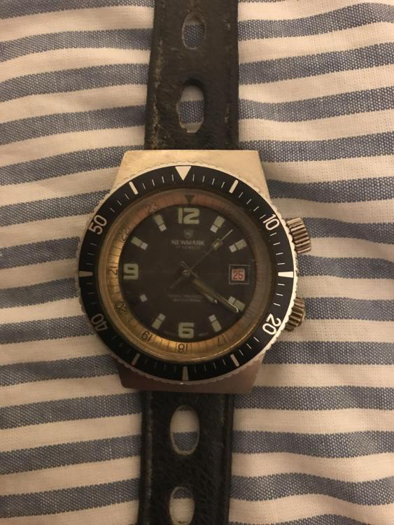

Hello fellow enthusiasts!

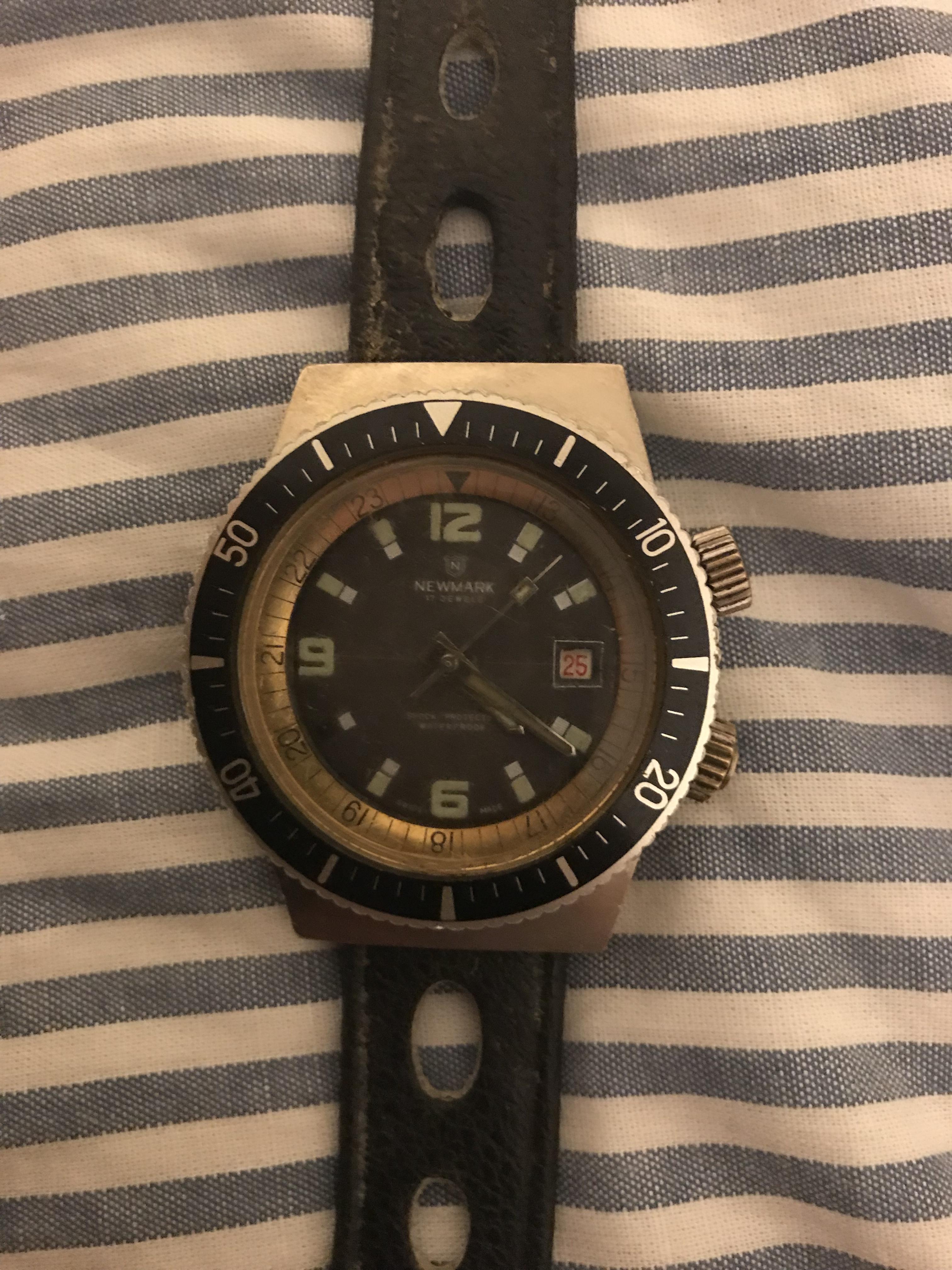

I have a vintage newmark dive watch.
I really love the bezel and two crowns.
I would love love to get this baby back to it’s former glory. However, there a few issues preventing me.
Perhaps you guys / gals can help me.

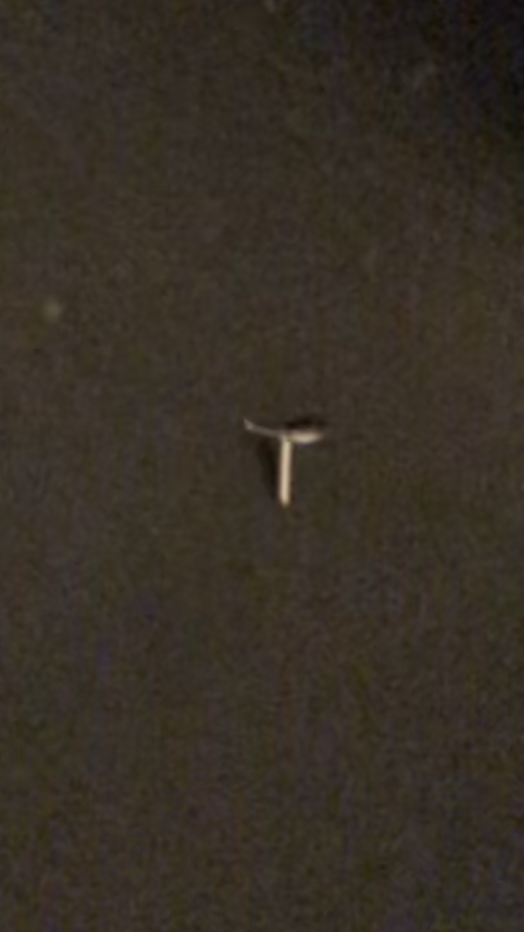

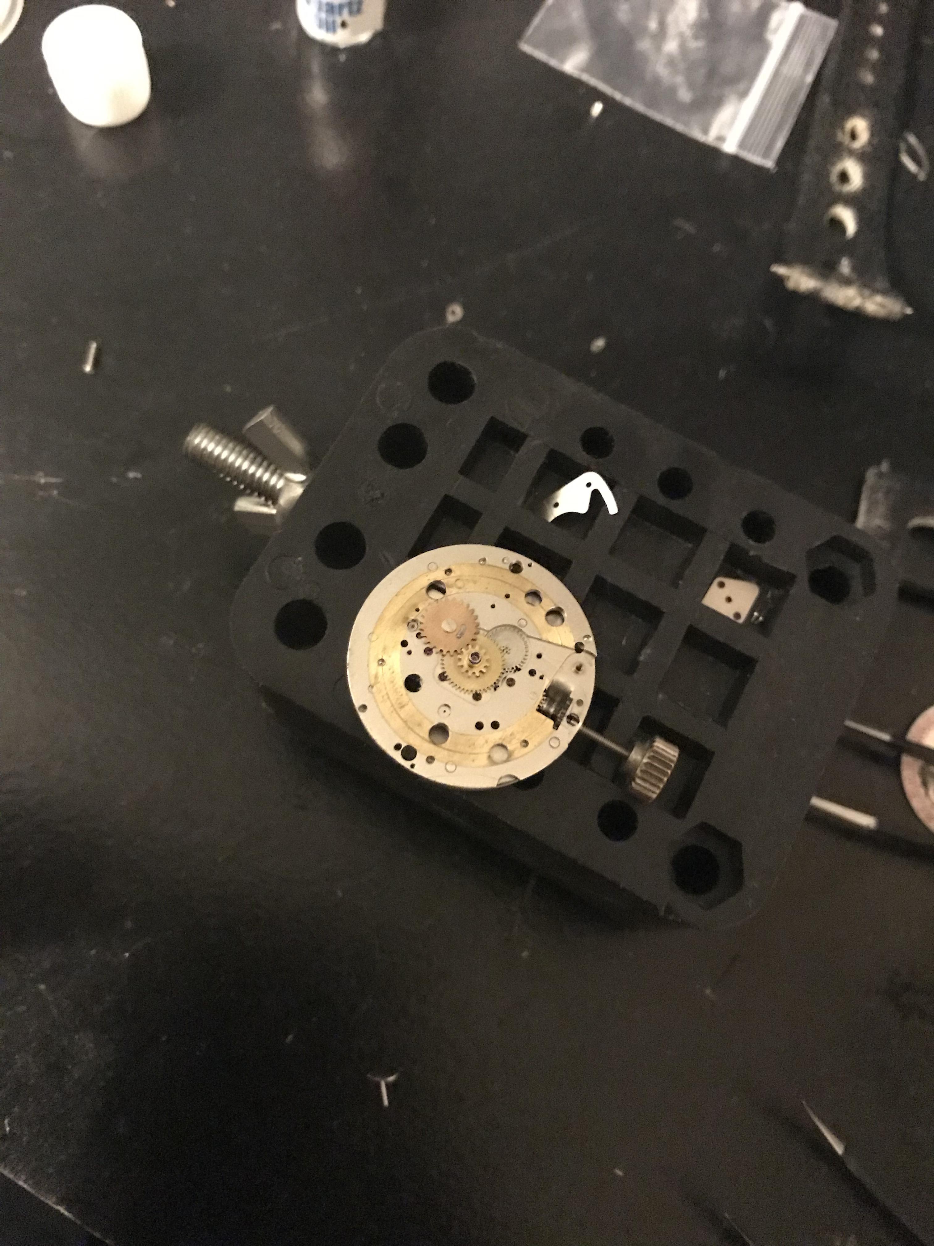

The major issue is that the one piece of the stem locking system has sheared. I’m not sure what it’s called. The pin that stops the stem from pulling right out and when it should be working can be pulled and the mechanism shifts to wind. The peice that’s rests on the movement is fine, but someone has forced the stem out and snapped the pin that stops it.can anyone please advise.
Another issue is that the dial legs have also sheared off.

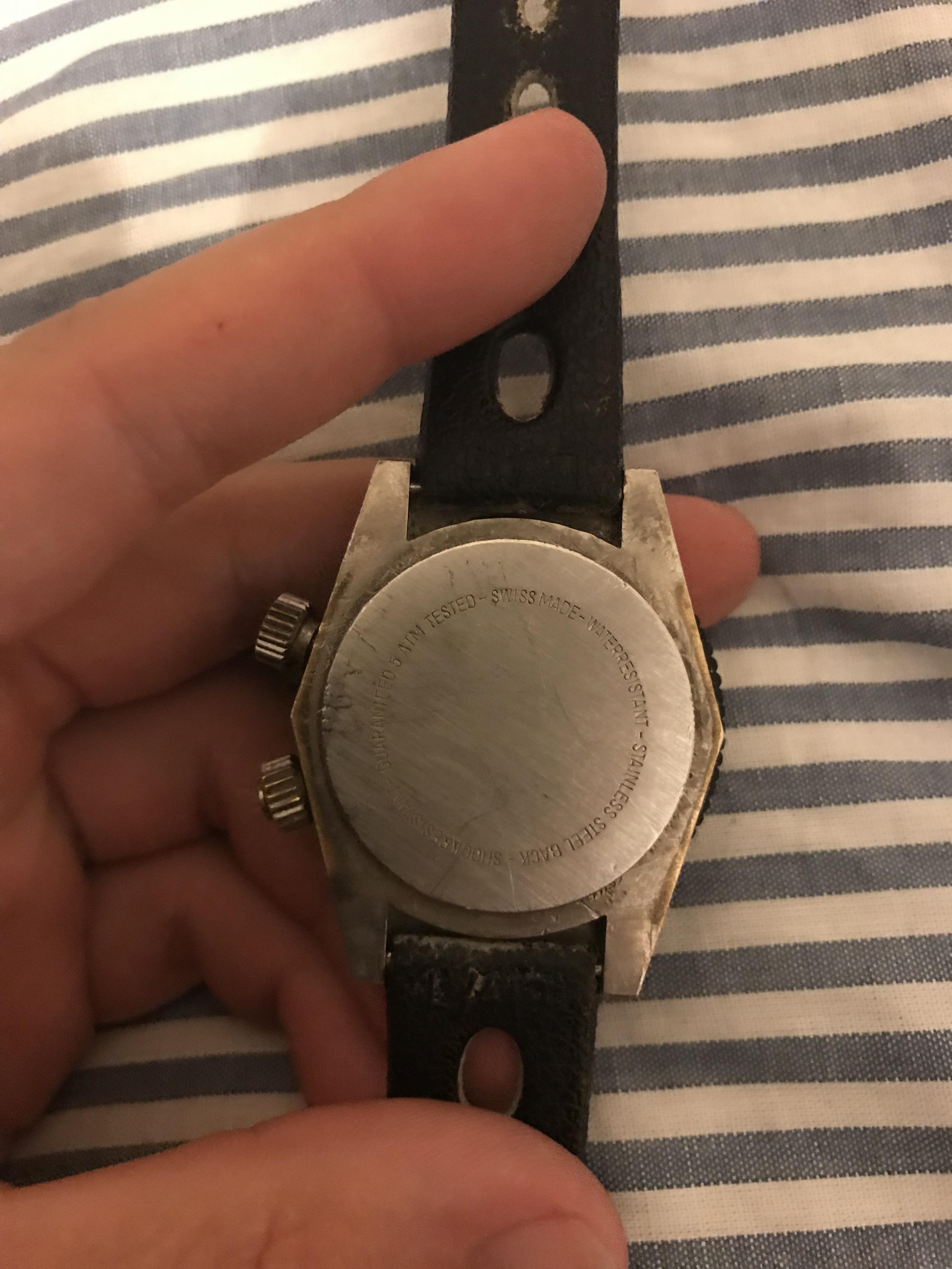

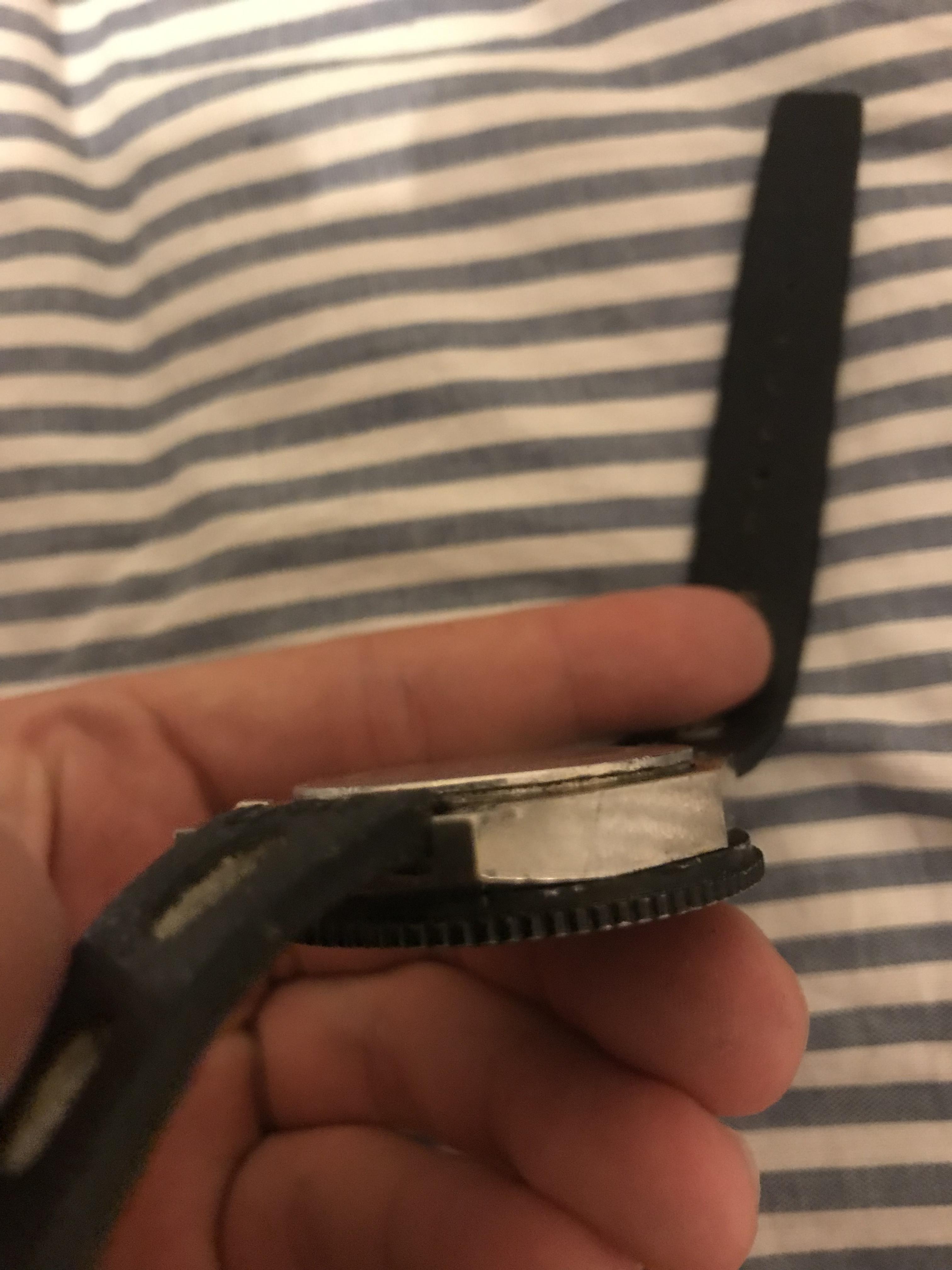

The rear back plate also doesn’t press down all the way and therefore there’s too much movement within the case for the movement.
The balance is also randomly stopping.
Please can have some advice.

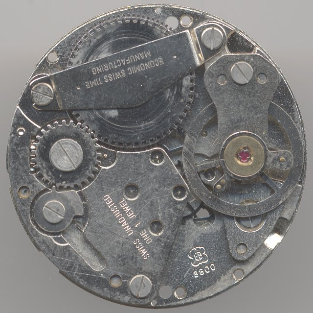

Looks like an EB8805 -> https://17jewels.info/movements/e/eb/eb-8805/
It should be relatively easy to find a donor movement, as they were produced in large numbers.

What does the broken part actually do?
Do you have access to a 3d printer to print some sort of movementretaining ring? If not you may be able to modify one from a modern quartz watch to fit.
WOW! Thank you very much! That's the exact movement.
It prevents the stem from getting pulled out and its also critical component for the keyless works.

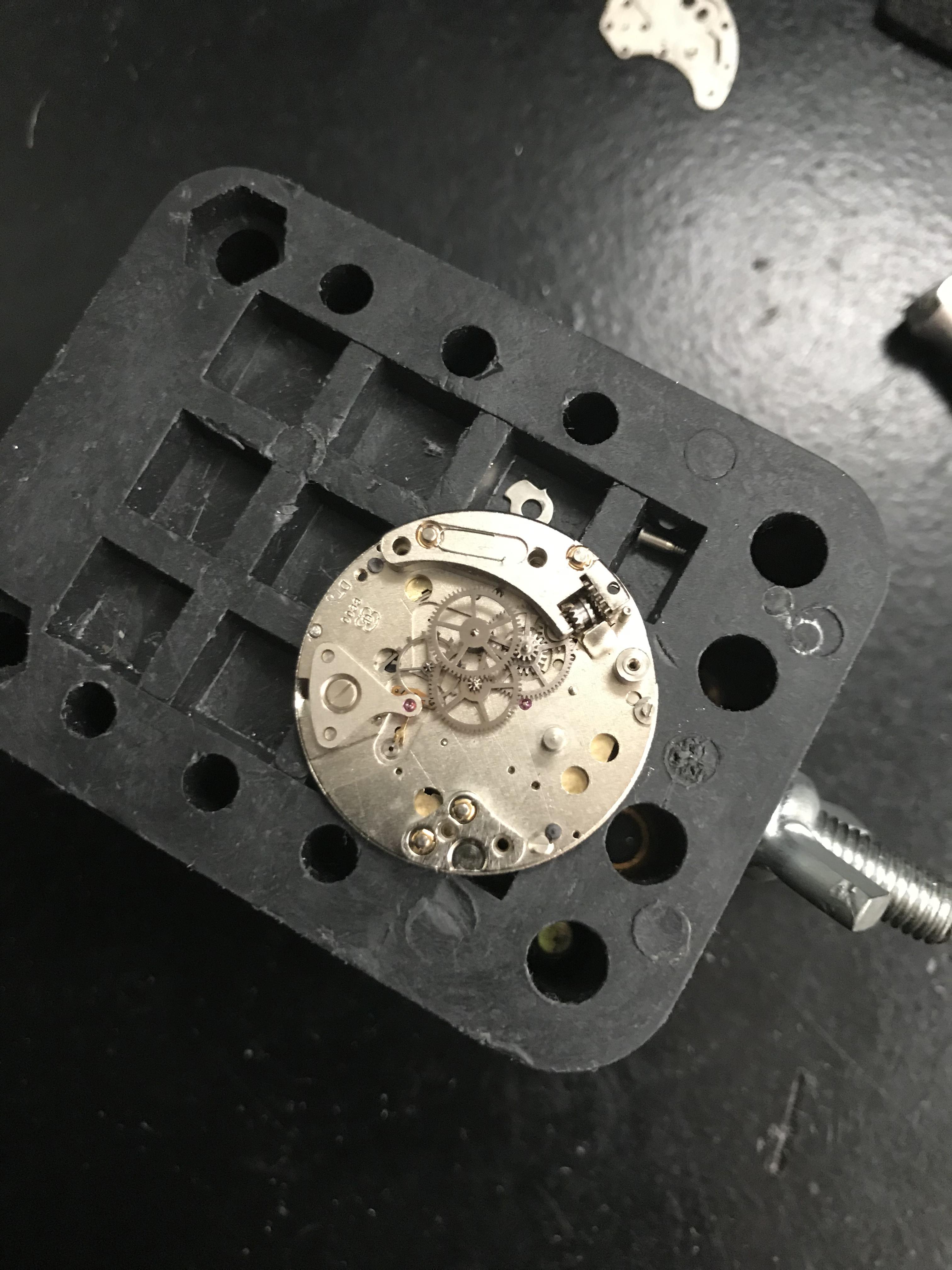

Okay then, as are you, im currently at work and cant take pics untill i get home.

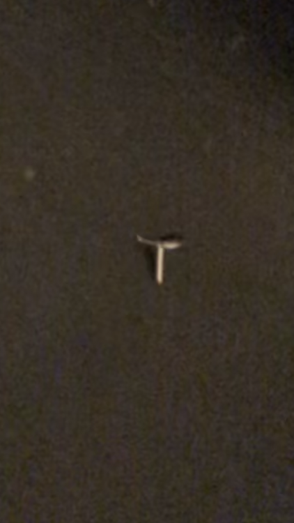

There is one picture of the broken component above, but not great quality.
I can take more pics when i get back.
I presume, though the photos are unclear, that this is the jeweled version of the EB 8805, although that may not matter as I'm fairly sure the keyless work is the same on all versions, but I'll have a rummage when I get a chance and see if  I have that part in one of my donor jeweled EB 88XX movements.
Sourcing parts for these movements is generally a lot easier than with some of the higher quality stuff, simply because there were so many of them produced.
They do tend to suffer from a number of issues (in addition to the usual balance and fork problems).
The spring barrel is inclined to wear, and the strange hold down spring/bridge that keeps it in place is inclined to loose its springiness and allow things to slip. Also as you have found, the keyless work is a little fragile.
They produced a whole bunch of variants of this movement over the years, including a jump hour "digital" version - More info here -> http://www.ranfft.de/cgi-bin/bidfun-db.cgi?10&ranfft&&2uswk&EB_8800
... and the service sheet is here ... -> https://www.watchrepairtalk.com/applications/core/interface/file/attachment.php?id=25537

Oh sorry didnt see the second URL.
I believe its item, 443/1 as its local to the other keyless works items.
According to the service sheet, 443/1 is the "Setting lever, mounted" and appears to be common to all of the variants, which makes life easier. I'm bound to have something suitable in the parts stash. I'll keep you posted.

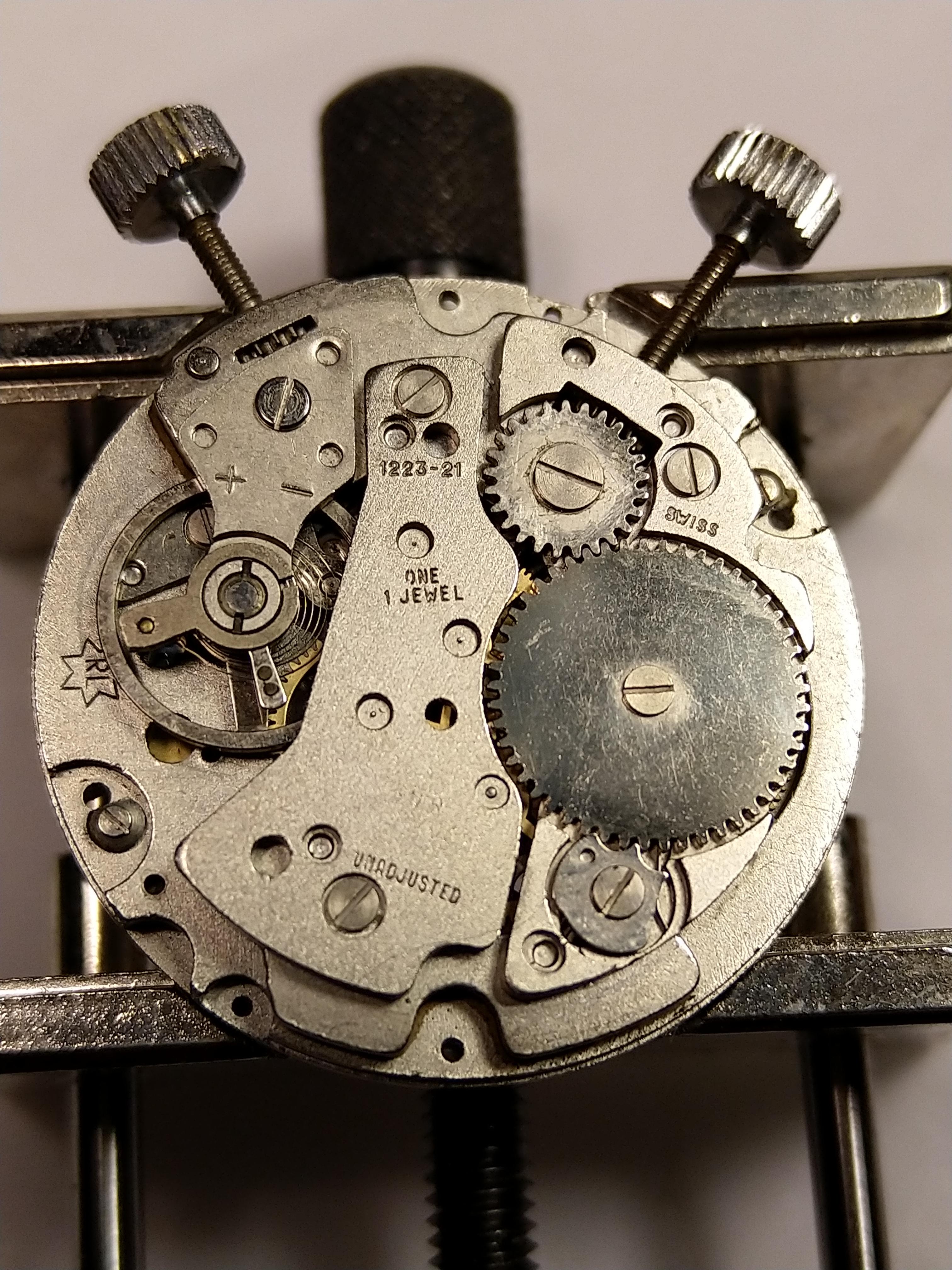

Just out of interesst, what does that second crown do? I've seen some Newarks with a similar solution but they had a Ronda 1223 in them and the second crown wound the alarm. But is there an alarm on the 88XX?
  On 9/3/2019 at 5:59 PM, RyanGreerMcGilloway said:
The second crown has no impact on the movement and only locks the rotation bezel in place
Expand
Ah ok thank you for the answer.
I found a 1223-21 in my treasure chest but no 8800 this far.
