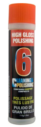

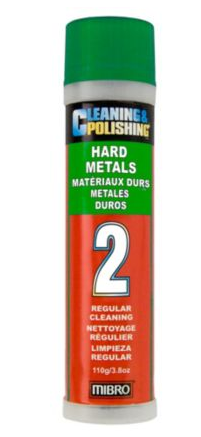

I've got a couple Seiko 6139's with pretty rough crystals. I was able to get about 75% of the scratches out, but it's not the sparkling result I've often see posted by others. I've been starting with a 1000 grit sandpaper(too chicken to start any lower than that), and then I jump straight to 2000 grit, using some #2 and #6 polishes in between, which has yielded what i'd call average results. I know they're only around 40 bucks to replace, but i'd love the satisfaction of being able to do it myself! Does anyone have a tried and true method to restore these old crystals?

I've got a dremel with the small felt wheels, that should suffice? I will need to pick up some of that diamond paste. Like I said, I've been trying to use the two polished below, finishing with Peak Cream. I think starting at 1000 grit was my biggest problem. Will pick up some rougher grit SP and give it a whirl. Worst case scenario is a ruined crystal i know i can replace!
The above are mild abrasives, they do nothing to glass.
