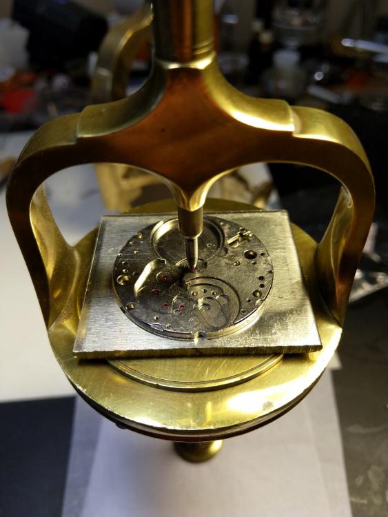

This is a great tool for the watchmaker when he wants to replicate a part, or even the watch repair man sometimes needs to make a new bridge. The tool is used to transfer the hole positions from the part you want to replicate. Usually, it is fastened into a wise in the square part you can see in the picture, but here I just show you what it does.
On the tool you got two snuggly fitted rods which is pointy in the both ends; these has to be exactly centered with each other.
I mostly use a nickelsilver alloy when doing the parts since you get a much nicer finish to the parts.
I glue the part which holes I want to replicate in the plate of nicklesilver. One have to super glue the part into place on the plate. It will come of in a bath of acetone later on.
Next I adjust the center jewel hole in the main plate with the upper rod (so you can see better).
With the rod below I gently push and twist so it makes a mark in the plate. I just do one for this example. In real life you just continue to mark out the rest of the holes you want to drill.
Here is the result from this operation.

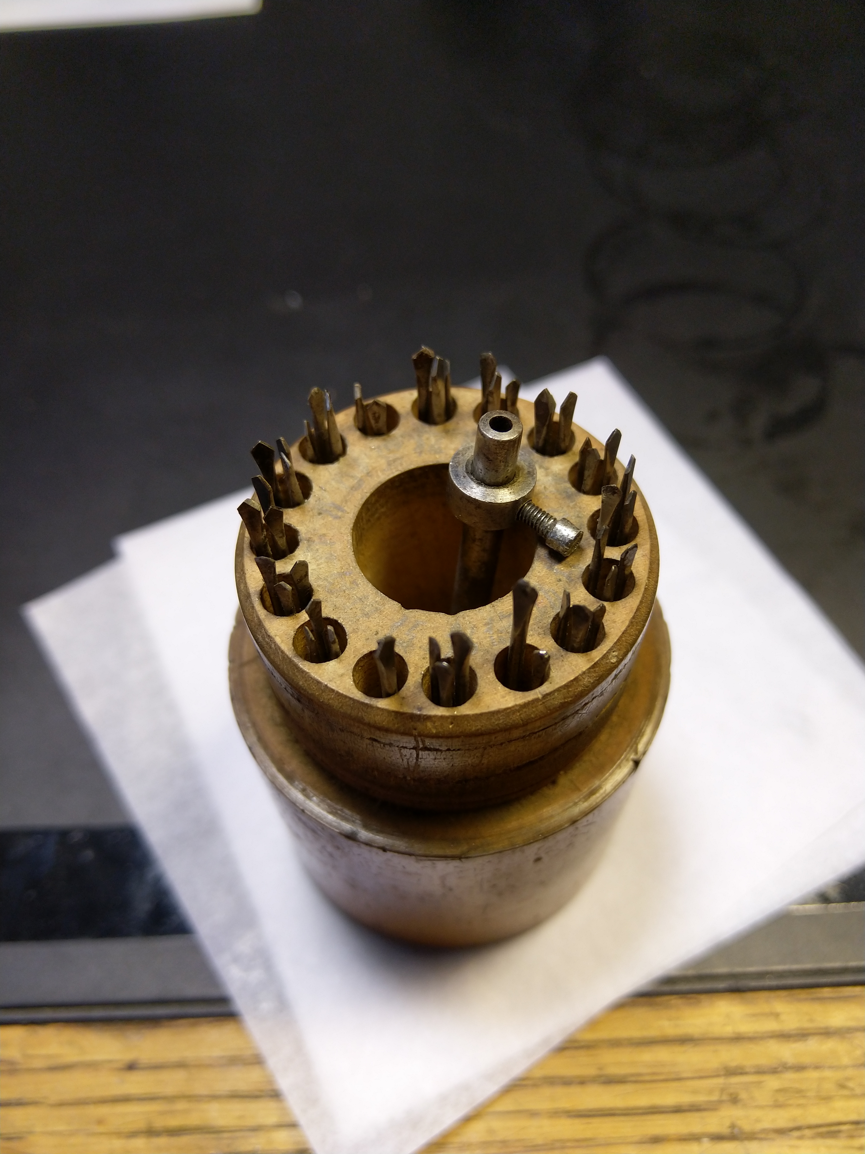

So now I take the drills out, I measure the hole diameter in the mainplate and choose one slightly smaller, don’t take the same size incase the hole you drill comes slightly out of center. You might need some room to adjust it later.
In this case I use an olden goldie drill press too. On this drill press you also got a rod which is pointy on one side and has a small indent on the other. With the three fasteners you center the bit into position by using the pointy part of the rod in the drill press.
Here you can see the part centered to the indent with the pointy rod.
When the part is in place you put the drill into the drill holder part, this is pointy on the upper side so now you turn the rod around in the drill press.
As you see the drill is centered in the dent you made with the upright tool.
So now you just drill away with the bow (which I can’t find right now)
