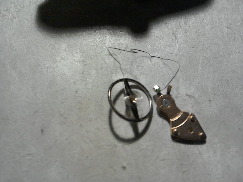

Hi all, the postman has just knocked with my latest purchases ! Each owing me the sum of £3.27 each including postage. The pocket watch is a "runner" but I haven't got a clue what it is, or was before the case went missing? The Oris looks ok, but the balance spring is all over the place, and the Rondamatic also looks clean but again the balance spring is total mess! More like a rat's nest.

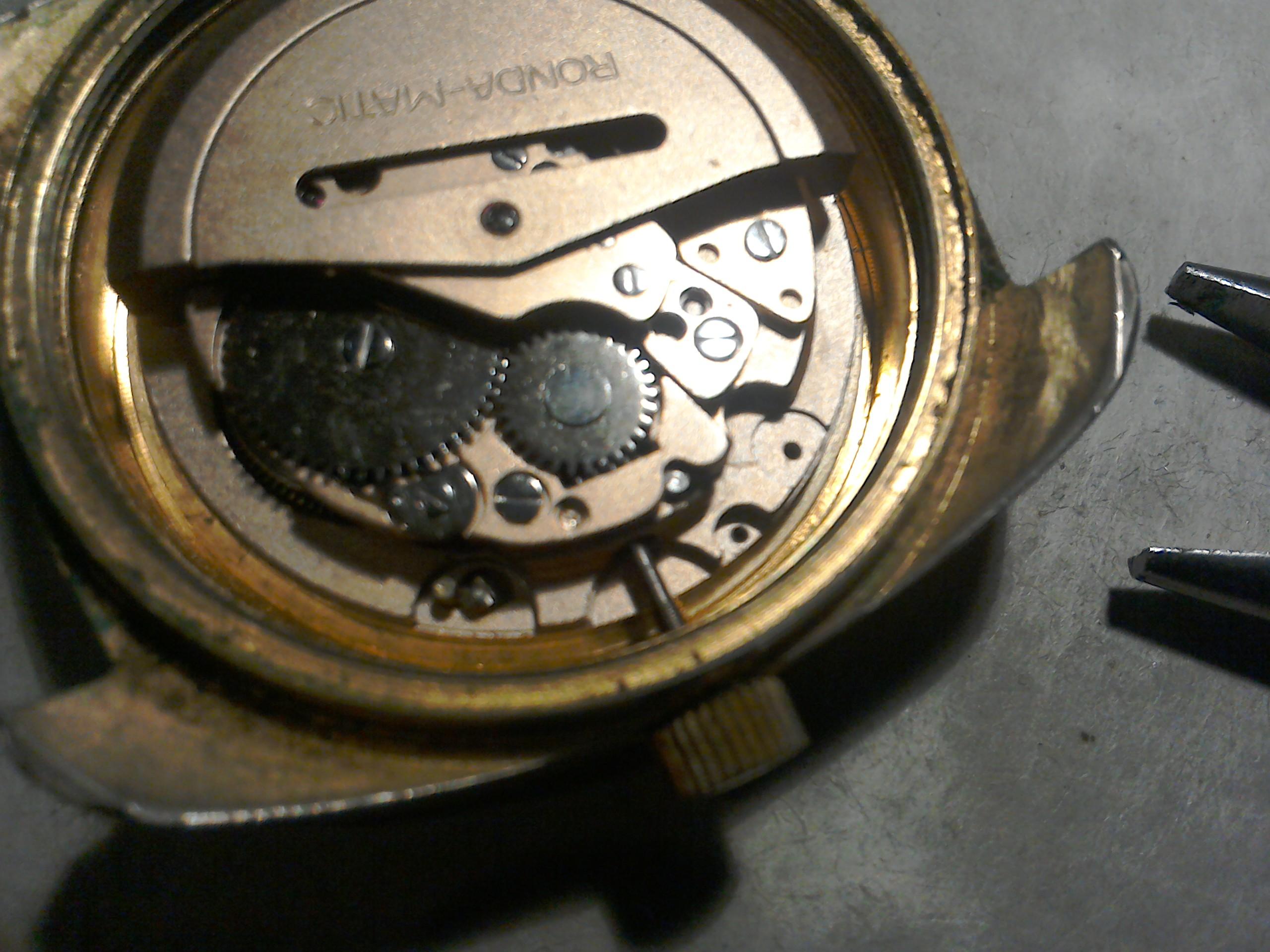

PS, any idea how to remove stem and crown from the Rondamatic? The silver button and the indent either side of the stem does nothing, nor the screw, I am stumped ! The balance spring appears to be glued??? And is wrecked I think.
So far as I recall, you press the silver button to the right of the stem in the picture. I can't be certain which position you need to be in, but I think it was the wind position.
The hairspring... 5 minutes and you will have that sorted :P
It does look unfankleable but you will have your work cut out. The real question is why is it mangled in the first place. Has something jammed up and "bounced" the spring out of the side of the balance, or is this simply the result of fat thumb trouble on the part of the previous owner?
Hi Andy, the previous owner of all the above watches has had a go at them all ! He said, " the Rondamatic was running fast and the Oris was slow, so got his mate to adjust them and they both stopped" ! Can't imagine why lol. I will try your suggestion about the stem removal. They were cheap and ideal for me to practice on, and the bonus is I know out there there is someone worse than me ! Thanks Andy for your time and advice.

No worries. The Oris balance is probably saveable. The Rondamatic may need a new balance (which are available), but if you want some practice, you might take a crack at fixing that hairspring.
In this case, I would suggest removing the hairspring  from the bridge, by unscrewing the pin screw then taking a good long look at it under some good magnification in good light to try to figure out what origami skills you will need to bring to bear. When the hairspring damage is less severe, i tend to leave them attached to the bridge and work on them in the watch. The "correct" way to do this involves some tools that I don't have, but in most cases you can get by without.
If it proves too damaged to sort, then you will at least have learned a bit about the noble art of hairspring massage. I have given up on a few, as sometimes they simply snap when you try to un-kink them. You win some, you loose some.
If you do get it back in order, or even if you decide to replace it, the original problem with those two watches still remain. Most likely they simply need a good clean and service, and once adjusted they will be ticking away like new.

Again I will take your advice, the Rondamatic is twisted badly and as they are available I will go down that route. The Oris, I will try to sort out, have looked at Mark's YouTube video on sorting hair springs so will give it a go, nothing ventured nothing gained. Many thanks.

Ref Rondamatic, it appears that the hairspring is glued, is this a special glue ? It is green and due to my very limited experience I have not seen hairsprings glued on. Any clues as to where I may get another spring balance from would help. As said I have tried Cousin's and eBay, Cousin's and eBay were brilliant for the Seikos that I have worked on but not much help concerning the Rondamatic. I am hoping that it's simply that I am looking in all the wrong places. Many thanks in advance.

100% right. Crown in winding position, out it came easily. I had it pulled out ! Easy when you know how. Many thanks Andy :)

Seller is in Poland, and the postage is steep, the part is more than you paid for the watch, so you would probably be better keeping an eye out for a better price, or even a whole mechanism with good balance. I suspect you could pick up a beat up, scrap ronda automatic for <£10 if you are prepared to keep checking every few days.
.. or you could try unfankling the current one.. what could possibly go wrong. As to being glued, it is probably shellac and would probaly dissolve in nail polish remover (acetone), or possibly denatured alcohol or perhaps isopropanol. I pretty sure the one I have is held in place with a screw, but it is not to hand, to check.

Service manual now down loaded. Will keep watching eBay. And will have a look at the one in Poland too. Here is a photo of hair spring. Can't see me sorting it out, will try though.

What I am trying  saying is, the sorted out HS never gets to be as good as new.  Your  Oris for instance looks good enough to get reconditioned and  join your collecrion, certainly not with an imperfect HS. It is not a question of your competence rather the fact this HS is not worth all the work involved.

Thanks Joe, if I can treat the Oris to a new HS that would be great. I have no chance of getting it good as new.. so hopefully I will be able to get one.
Thanks Andy, glad it confirmed that it's glued ! I will check eBay daily I am sure one will turn up. Will push on with the Oris for now.
