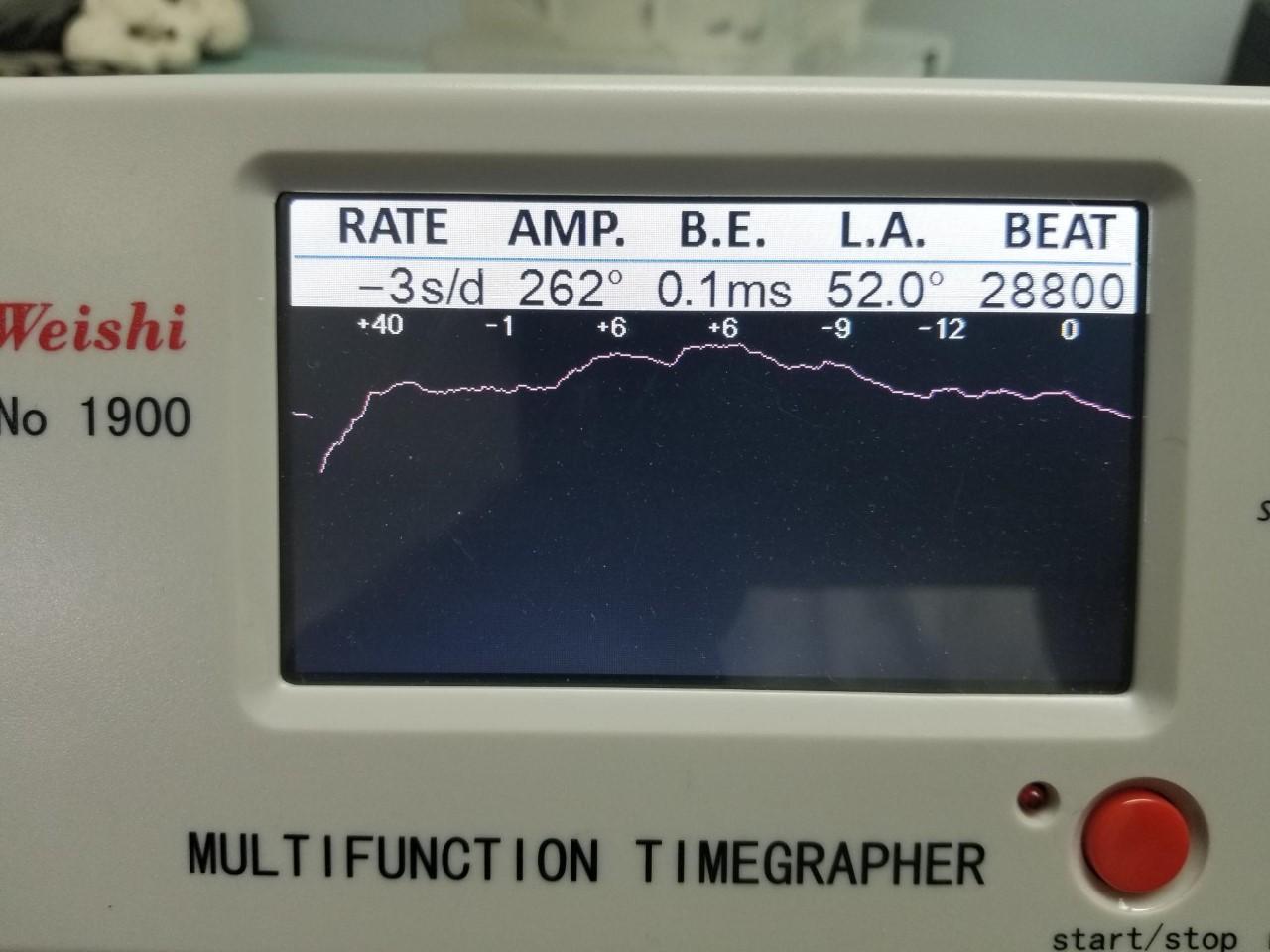

Ok I purchase a clone 2892 took it apart and serviced it with good results. So I felt brave enough to work on my Cartier Pasha with a 2892-A2.. Apparently I I screwed up  Timegrapher all over the place ...I used it on several movements and always had better results than when I started..Of course they were always the cheap Chinese movements.
Here is what I am up against. I took it apart and examined but did not notice anything wrong From what I read it is most likely the escape wheel or the 4th wheel. But I am not sure if I am analyzing  this right.I enclosed pictures of what I am seeing ... Sometimes the movements can get even more extreme than the pictures I uploaded
Definitely an interesting waveform! Can you change from the current to the B graph? In the B graph mode will display 192 seconds which will make it easier to look for patterns if there are any. Then I'm a big fan of timing in different positions to see if the problem occurs in all the other positions?

This three shots are in B mode
Face down
Face up
Crown Right
Same type results
I am tearing it apart to examine a little closer I obviously missed something.

Were in the same boat ...Still not working right can not figure what I am doing wrong ...The only variable is I used 9415 on pallets instead on 9010..could that b the problem?
I am leaning towards on of the drive train wheels is screwed up
Its weird because I can not see anything that looks off ..No wobble in any of gears ..balance wheels looks good to me ...I suppose it could be so slight it is not noticeable without proper measuring devices
What we need access to is a different timing machine? One thing that can cause timing fluctuations is change in amplitude because of issues with the gear train or basically fluctuations of power through the gear train. There timing machines that will run time plots for both the rate an amplitude which makes it really easy to see if you have a gear problem. This is where was hoping with the longer display we can possibly see a repeating pattern and figure out if there's a particular wheel that's the problem. This is one of the times where paper tape was nice because you to run on nice long piece of paper and look for things.
Then the balance jewel assembly? When you disassembled are you 100% sure that you put the Cap stones back correctly? One side is curved one side is flat it's really easy to sometimes flip them over. If you look at them like under a florescent light you can look at the reflection on the top and see if the reflection looks flat or whether it's curve the way it's supposed to be because the curved side goes out the flat side goes down.
When you have it on the timing machine leave it in one position and watch the amplitude see if it's going up and down and how far does it fluctuate up and down? Then if it does fluctuate see if the fluctuation occurs at a regular interval.

Amp stayed about the same but very low. Look how wacky this chart is
I upload a picture of my 6498  just to show I can dial it in if it lets me.

If this was a pocket watch with a little secondhand then that wheel is the fourth wheel. Typically it would go around once per minute indicating the seconds but on a modern watch conceivably it could go at a different rate.
Gear trains are interesting in that they have power fluctuations. Modern watches the power fluctuations are less because they understand things and have nifty test equipment to make sure they're less versus older watches that existed before timing machines and nifty computer simulations. So gear train fluctuations typically don't show up on the timing machine which is usually averaging over time anyway which is the average out all the short-term fluctuations. The only time you might see something is if you're having a problem and when the amplitude is low problems can show up as everything gets magnified.
At work I get spoiled the witschi machine I have has a full automatic microphone I time everything in six positions. Occasionally on American pocket watches I will get suspicious and look at the numbers on the last page then I run the whole thing again. On the watches I'm suspicious of the numeric page the numbers are different. A lot of times even between dial-up and dial down which should be the same there's enough time between timing that the numbers are different. But a nice characteristic of a watch is it tends to average out things like this and it's not noticed usually.
Then there is a way to see gear train fluctuations if your timing machine has a time plot feature. The last time I did a firmware update on the machine at work I now have a nifty time plot feature. It's interesting in that it auto scales to whatever the input is so the graphical displays might look similar but you have to look at the numeric scale on the left-hand side to see what they mean.
So to understand the time plot feature I'm attaching images. You'll notice the Rolex appears to have a problem but timekeeping wise it still looks fine. The Hamilton hasn't been serviced in I have no idea when this is the way I got it when I purchased it and it also looks outstanding for timekeeping even with the fluctuations. Both the Rolex and Hamilton were time when fully wound up. Then the seven jewel laco timed at the end of 24 hours which is why the amplitude is low looks really bad.

My  Chinese wieshi is not quite a Witschi LOL ...
I do not have access to a better unit...Is there any one thing in particular you would concentrate on ?  ..I already ordered a mainspring and barrel . If I have to replace one part at the time that is what I will do. Could always use the extra parts for another project.

Unless you are also seeing fluctuations in amplitude which correspond with the fluctuations in rate, then I would not initially suspect that it is an issue with power delivery (mainspring and barrel).
If you are noticing near-instantaneous changes in rate then I would suspect it is an issue with the oscillator.
