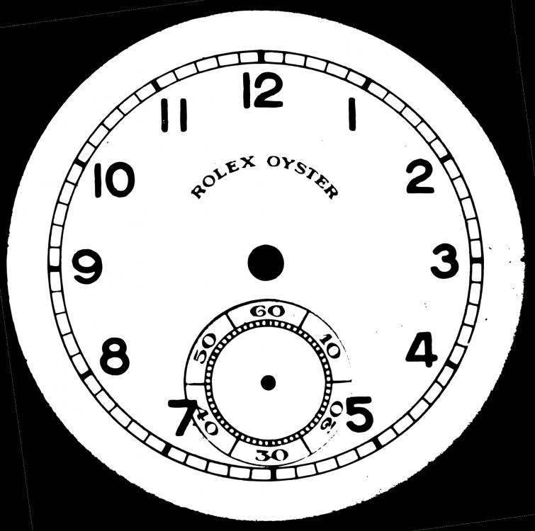

I just did a quick experiment, based on a random rather scruffy and slightly out of focus old 1930s Rolex dial from the internet, which is hopefully long since out of copyright.
As well as the original image, there are two converted files here.
The first is a jpg (raster based) the second is an SVG (vector based).
For a first attempt I think they look OK, and gave me a rough idea of the work flow.
I suspect that they could be improved by printing out at A4 size and hand finished, then re-photographed, and converted to SVG, then finally scaled to the dimensions required to produce a sharp image. There are other tricks that could be employed, including perhaps anti-aliasing and de-speckling in the photo editor of your choice (in my case Gimp).
My work flow was to clean up the image as best I could, convert to 2 bit colour (Full tone black and white), then convert to svg using a  Linux tool developed for that purpose called potrace (On Ubuntu and other Debian based Linux distros, install with sudo apt-get install potrace)
Clearly the original dial left a lot to be desired, but the basic idea looks sound.

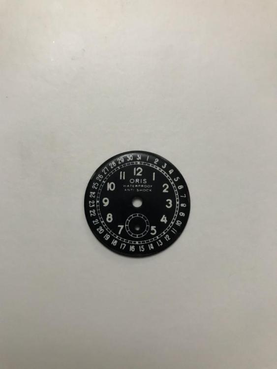

Hi, Manodero
The pic ahowing the single dial is available rather cheap here, the aim is to it,s quality.
The pic showing two dials are genuine Oris , and to be refurbished
Quantity is eight hundered, which mqy make a diference in choosing the best option.

12 hours ago, Nucejoe said:
Hi, Manodero
I must agree that the quality of the refurbished one is pretty low.
Printing is not good and, most important, the design of the numbers and letters is not even accurate ... plus the refurbished one even lack the "SWISS MADE" mention.
I'm curious to know how much they charge in Tehran for such a badly redone dial ... would you mind to tell us Nucejoe ?
I've made a comparison pic to make the differences as obvious as possible.
In fact I wouldn't call the redone one "refurbished" ... "reprinted" would be more correct.
It is really possible to redo such a dial with decal and there are 2 ways to proceed :
1 - redesign everything on Photoshop or Illustrator to reproduce the original dial as close as possible
2a - print in black on white decal sheet and just put it on the dial plate ... you'll get something looking too new because the white parts will be "too white"
2b - spray paint the dial plate in white, age it a little, print the dial in black on a clear decal sheet and put it on the dial, finish with semi-glossy spray varnish ... that way the white parts will look "old" because they'll look more "off white" than "white"
The problem with both methods is you wont get any "3D effect" on the white printings ... everything will look flat on close inspection.
But when cased you could get a good looking result ... if you're handy at luming because those tiny numbers are "shitty" to relume.
The only 2 ways to get an almost perfect  result are silk printing and pad printing ...
- low "3D effect" and "woven" printing (something you can only see with a magnifier) with silk printing
- high "3D effect" and perfect printing with pad printing

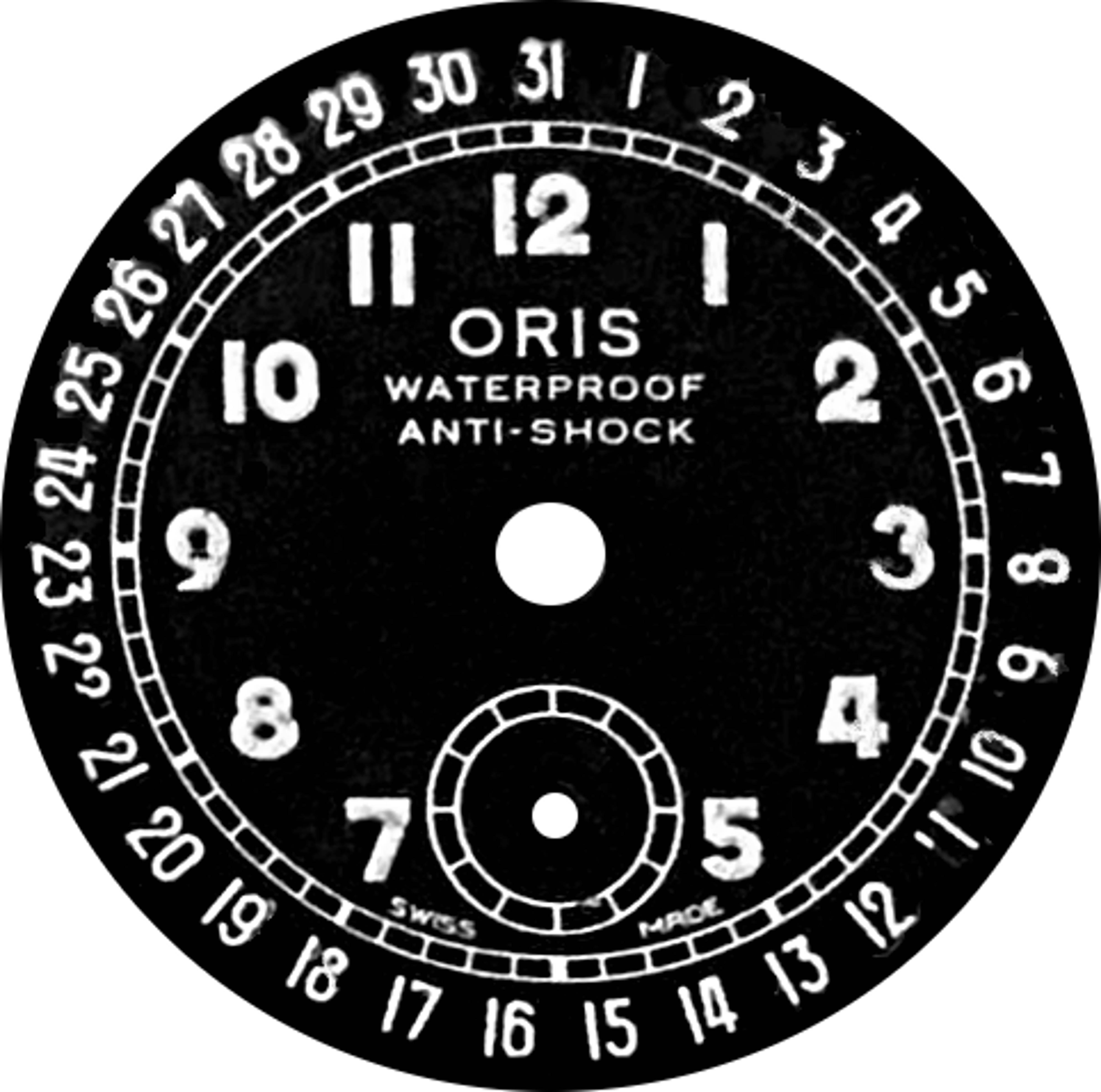

OrisBlackSecondsAtSix1940s150dpi.thumb.jpg.1c708a732b70a98b514e66ec765f8ed6.jpgFor a bit of fun, while the thunderstorms have me confined to the laptop I had a quick crack at tidying up that dial.
A higher quality starting image image would be a help, but here is a quick and dirty conversion.
Note, the file I am working on to produce these results is 150dpi and around 65Mb, and the version here is lower res. I don't think I can post 65Mb images here. Even if it were possible, some of the readers are looking at this on their phones, and wouldn't appreciate the 65Mb download.
The SVG version is probably the more interesting of the two
Certainly with the right starting image quality and some careful editing, you should be able to come up with a pretty usable result.
Note: I'm not happy with the numerals yet, but I thought it worth posting as is, just so you can see the technique.
OrisBlackSecondsAtSix1940s150dpi.svg
OrisBlackSecondsAtSix1940s.ppm
The idea behind using an SVG scale-able image rather than a raster based one, being the fact that you can mess with the size of it (within limits), without introducing too many weird raster based artifacts, and without having to fiddle with anti-aliasing.

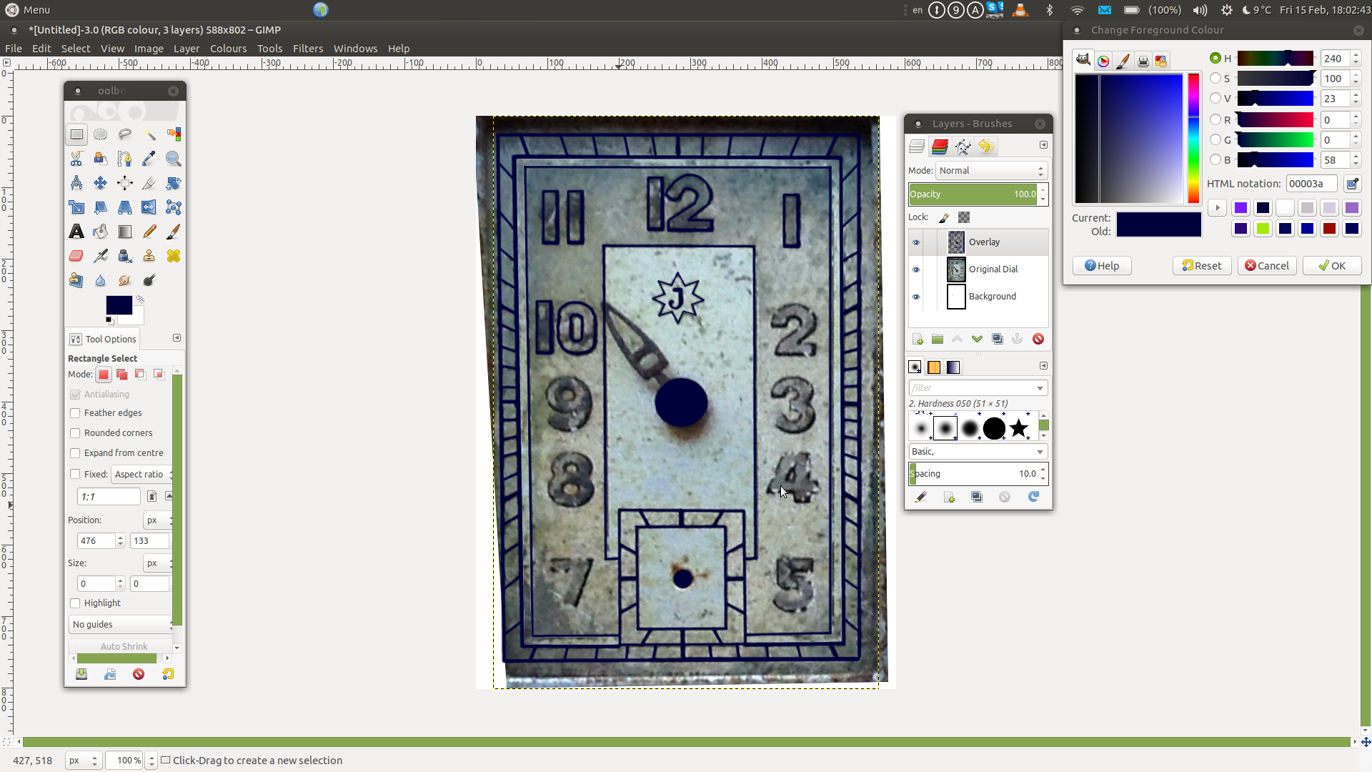

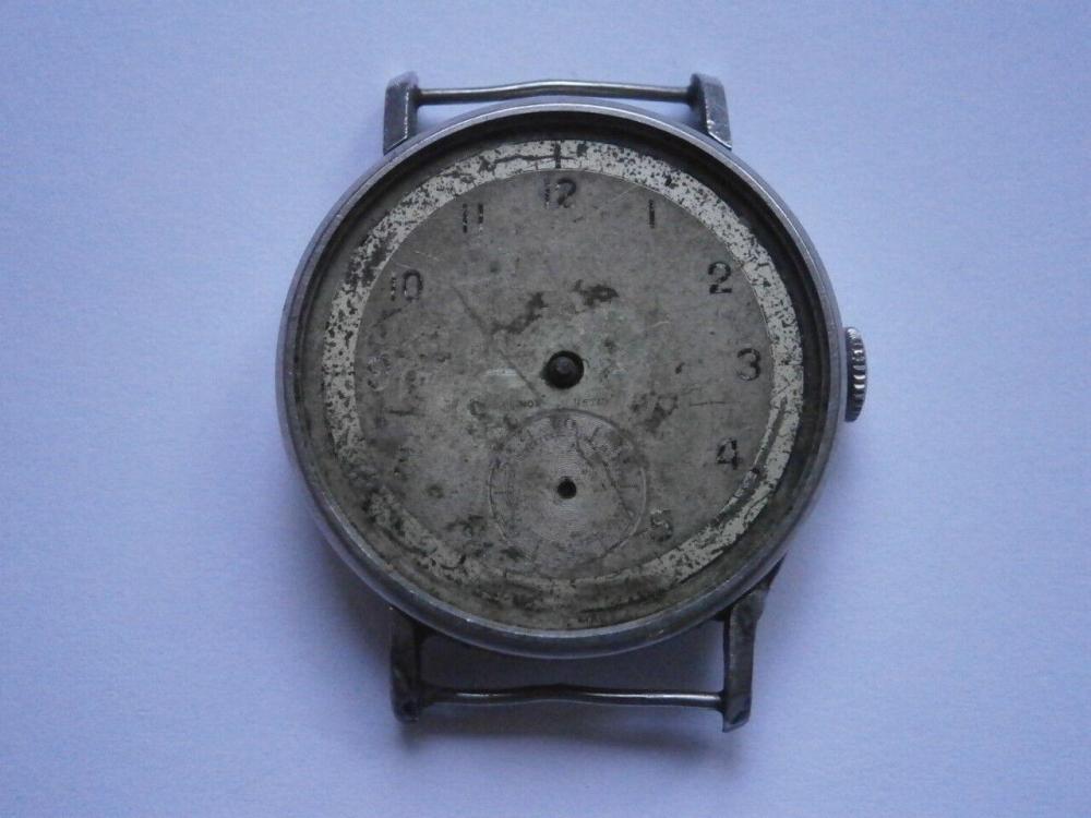

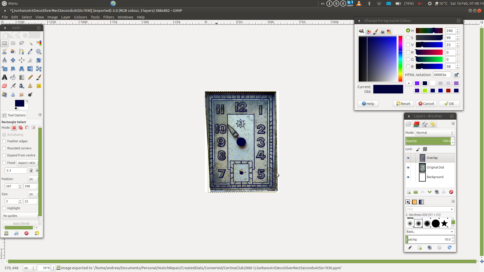

One of the scruffier watches waiting for my attention has a pretty beat up looking dial, which I hope to experiment with.
My plan is to preserve what is left of the original, but make a replacement, which given its condition seems the most sensible way forward.
With this in mind I set to work with Gimp to see what sort of result I could expect.
I used one of the ebay images as the basis for the replacement art work, squared it up and set it as the base layer of the new image.

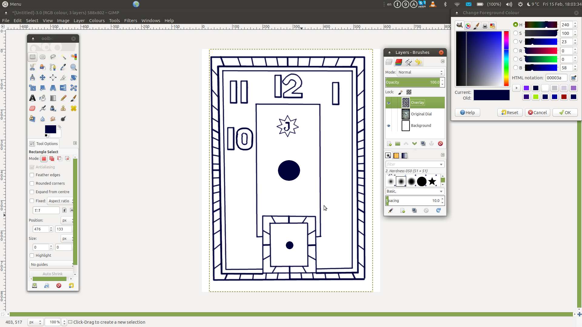

My feeling is that the original was dial artwork was fairly simply produced, probably using three different drafting pens, as there appear to be three distinct line widths. So I measured each, and experimented with the brush widths in Gimp until I had something close to the original.
I then added two new layers. A base white layer, and a top layer on to which I am building the art work.
By selectively switching each layer on and off, I can toggle between the transparent top layer with the art work, the middle layer with the original damaged dial, and the base white layer (by clicking the small visibility "eye" icon next to each layer in the tool).
Here are a couple of screen shots to try to illustrate the process.
1959023310_Screenshotat2019-02-1518-02-43.thumb.png.21f20fb67a3a7123fa5249c490b2fbc8.png
All layers on.
38303782_Screenshotat2019-02-1518-03-34.thumb.png.4899d22073786a66397d6abb94c146b5.png
Base and artwork layer on.

This technique allows very accurate positioning of the artwork to match the original, and lets me re-create the missing details by careful measurement.
This is only a first draft, but it looks like it could produce a usable result.

Here is the "final" draft of the Junhans art deco dial. I say final draft, but clearly you could tinker with and refine this more, but it is good enough for the purposes of refining the workflow.
338285596_Screenshotat2019-02-1607-48-15.thumb.png.22a3e63e272112a623036ec69f39ec1f.png
JunhansArtDecoSilverRectSecondsAtSix1930.thumb.jpg.1b248d81116ee465452241b94eb9e558.jpg
JunhansArtDecoSilverRectSecondsAtSix1930NewArtwork.thumb.jpg.2a91375aa5960fdb83abb47da9d0d0b1.jpg
If you want to use these files, you can do what you wish with them, within the bounds of the GPM3.0 license.
