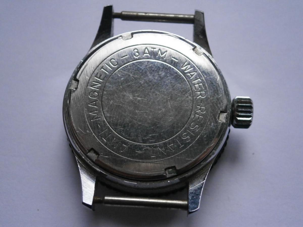

I completely fell in love with this watch - so much so I've been counting down since I first seen it.. It's a non runner and the auction only just ended. I can't wait for it to get here!
Now I'm looking for advice of what to do with it. Also any info anyone has on it's history would be greatly appreciated.. I believe it was made in Swansea?

We need to find out why it doesn't run. Mainspring and barrel ok? friction washer/foil present under dial? Do the balance wheel and pallet fork look ok? No pivots broken or bent? Wheels and pinions in good order? end shakes ok? Jewels not cracked or broken?...there are many things that may be the issue including dirt and old oil. I believe you may want to give it a real good servicing and while at it a very good inspection...

These are the photos that were on the auction - I don't have it with me just yet.. It should be with me midweek. I have unearthed some info on it: It seems to be from the Anglo-Celtic Watch Co (existed from 1946-1980 in south wales) After spending all evening researching this, I have only found 1 other the same, but it looked in poorer cosmetic condition. I don't think this one will have anything done to the dials/hands. Maybe the crystal will be renewed or polished. It'd be nice to get it working though.
It looks a simple enough movement to work on - But I will be leaving it until I get some dismantling experience on an old Seiko 5 I ordered to practice on.

Judging by the overall condition I would say that this watch was worn for a few years and then stopped working and was put away in a drawer where it spent the last 20-30years. The reason I say this....
- The afore mentioned bezel... it looks printed on aluminium.. This would not last long in the real world and you would see significant wear with 2-3 years daily wear.
- Case does not look like stainless steel. SS was a big deal in the old days and you would usually see it mentioned on the caseback. Plated base metal cases will usually show wear under the lugs and also in the area where your fingers would rub as you're winding the watch if the watch has been used for some time. In this case I would say its a plated case with minimal wear. Check inside the case back if there is any marking that says its stainless steel.
- Such big lume areas on the hands do not last long as they tend to break/flake off with normal use.
This watch is unusual (in a good way) in that it has a full bridge for the balance instead of a 'cock' which you see on most watches. This is usually found on higher quality watches as it lends itself to better timekeeping. A bit fiddly to install if you're new to this game.
Overall I would say it is a good buy. Pin-lever watches are underated but they are important part of watch-making history and its hard to find one that is in nice condition cosmetically as most watch collectors did not place much value on them and a lot of them have been tossed out.!

Thanks for the info anilv & clockboy. Would little wear to the bezel and case indicate that the pivot holes and pivots could be in good condition? I hope this is the case. The watch should be here with me in the next few days, so I will check it over with a high powered loupe to see if can see anything obvious. I will get the macro lens out and take some better quality, closer shots too.
Although this is clearly a relatively simple movement, I may contact Mark to service it. I am confident I could dismantle, clean and reassemble it, but my fault finding and lubricating knowledge isn't there yet. I can't find any servicing info for this 512 movement, and to be honest, I wouldn't know which oils to use, and where to use them. I only managed to find one watch the same as this after spending hours searching. It had lume missing on the hands, and the bezel was not in good shape - This confirms your assessment. If the cost is reasonable to have it serviced, then i'll probably leave it in more capable hands. Either that, or it will sit as-is until I feel confident enough to start on it.

Interestingly, a light rotation on the balance wheel made it start ticking. So it actually mechanically works. It stopped shortly after, it looked a little lazy too while it ran. This is leading me to believe that it's just in need of a full clean and re-oiling. You're right, it's a ticker alright! :)

Update on this watch: Just the other day I took another look at it. It ran for a minute or so when I manipulated the balance wheel. Everything looked in order from what I could see, so I set about removing the balance bridge and removed the balance. I cleaned up the bottom pivot hole, oiled it with a little anchor oil. Then I oiled the jewel. Reinstalled it and it fired up straight away. This was last night at 9pm. I synced the time to my iphone and just compared it 30 or so minutes ago. It's still spot on to the minute after over 24 hrs. Quite surprising really for such an old watch! I'm over the moon it's working. I kind of wish I'd stripped it completely to clean and oil it. I just ordered a new strap for it, black with orange stitching.
Good to hear from you again. That's great that you managed to get it up and running and keeping time. :)
It would still be a good idea to give it a thorough clean down the line sometime, as oiling a watch without cleaning can make old oil that has turned to varnish swell and grip pivots. It's happened to me in the past.
Yes that will be next. I think the only thing I'm in need of to complete it, is an ultrasonic cleaner and parts baskets. I'm looking into it today :)
