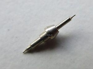

Just to let you know, I just made a full movie on how to make a balance staff. I start with an old Waltham movement and show how to strip the balance cock down and then strip down the Parts right down to the old balance staff. Then I show the process of measurement and material selection, including the use of the tools. I then cut the complete staff including finishing the pivot ends on the Lathe. This is the most complete video I have made to date. I will post the link as soon as it processes in a few hours...on my “jdrichard01” YouTube site. Here are the end results and the camera setup. Very hard to do with a camera strapped to the Lathe.fdc36bbaf052eb48bdf5a7110b50b529.jpgb02ce5f7f80b083fd5411a05c6222e51.jpgece32388943e3c0bb89b49904326760a.jpg

Here is the video. Sorry in ended up inverted for some reason. New software :)

The roller table cut is very hard so I really take my time. The pivots are also challenging. Using a stone to get the right final diameter of the pivot is the real skill. The rest is not too bad.

It takes a bit of time and not cutting off to much material is the hardest part. I had to turn a friction fit staff into a riveted staff once because I cut too much. Also, cut the pivots down to .2 mm and then use a stone for the rest. Screw up one pivot and you need to start all over again.

Put the watch together and adjusted the balance to the round. Did rub on the balance cock so I took the lower pivot down a tad and it worked really well in all positions.
