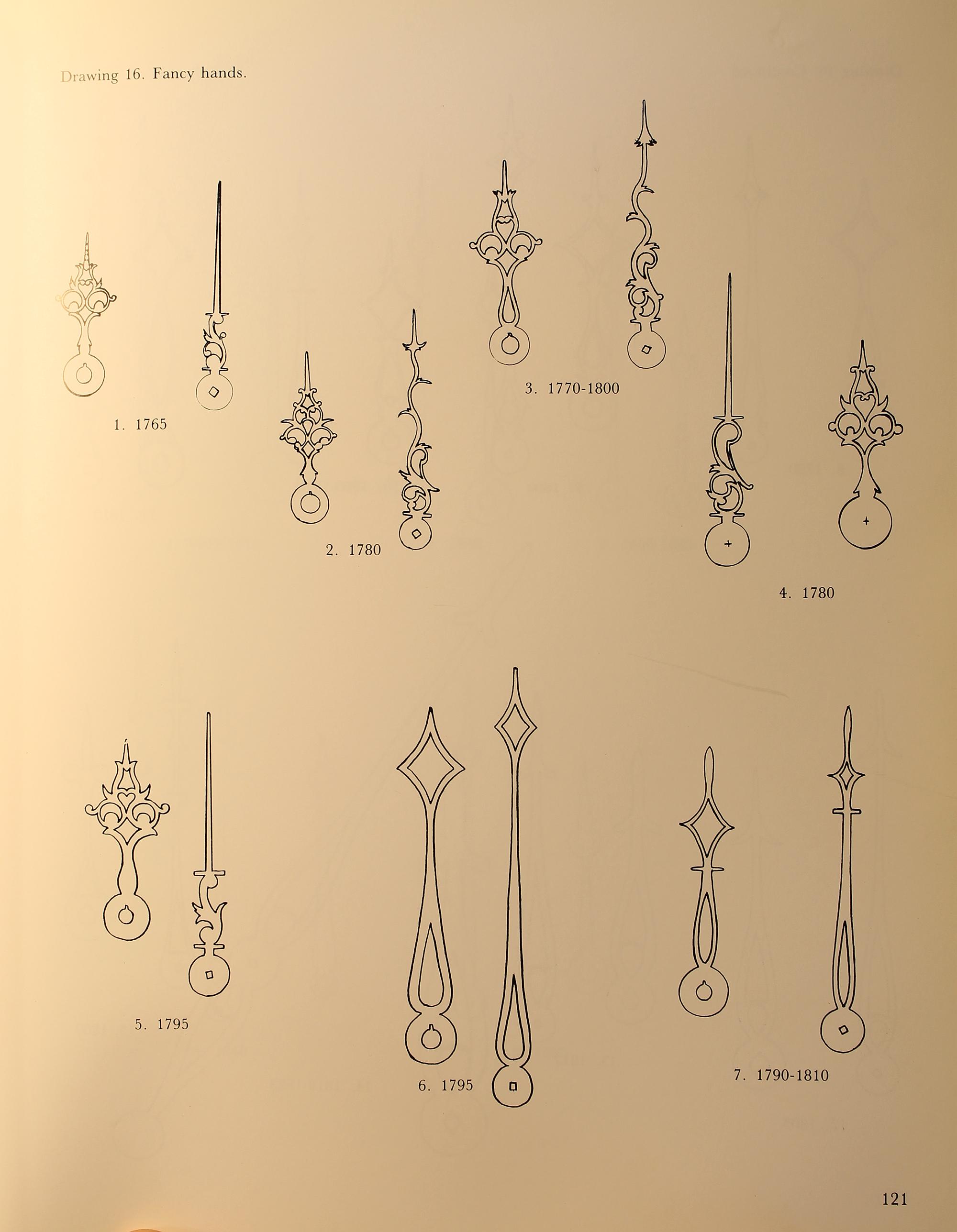

In the mid nineties I bought my Dial-clock in Melbourne, Australia. To learn more about these clocks, I also bought a book about Dial Clocks. The above mentioned bracket-clock is estimated from around 1770. Consulting my Dial Clock book, comparing the pillars it comes up with a pillar design of the 1770 or the pillar from the period 1780-1840. The hands puts the clock around 1780....... according to my Dial-clock book.
But this seems then also to be thru for bracket-clocks ........ !? Which make me wonder about how come ... ?
I know that London was the most advanced in clock making and I guess they did set the design trend. Which hands or pillars to use. Some designs slowly spread to the countryside and therefor they were in longer use than they were in London, hence the dating is often given in a period of years; from then to then.
So my question is; were there, for example with the pillars and hands specialized companies who "mass" produced these and a clock-maker could order these parts from those respective specialized companies? Or, in order to make the pillars & hands identical according to the latest fashion of that specific period, were there reference (latest design / fashion) books floating around which could be consulted by a clock-maker? Same counts for the chains ...... I do assume that they were ordered from a specific specialized company or did each clock-maker made the chains themselves?
Clear to see on the Ben Shuckforth (Diss, Norfolk) clock I did begin this year, that nearly all part were hand-made, but for example the dial ornaments in the corners seemed to be "mass" produced? (perhaps Ben made the hands himself or ordered them ??)
Any idea how that went in those days .......? Did they have a kind of "assembly-lines" for certain clock-parts ....? (was a kind of CousinsUK already around :biggrin: )

Bracket clocks and Long Case Clocks (grandfather) styles are virtually the same. You are correct in thinking London being the centre of clock making. It took time for what was happening in London to reach out to other parts of the country. The plates including pillars and other parts of the movement would be made under the same roof. Anything to do with the dial would be made at a different place; a case maker would construct the case. With white dial clocks, an artist would paint the dial. The clock maker would know where he could obtain chains for a fusee movement. It was in later time when mass production came into existence that a string of employers would each make one part and at the end of production, you had those that would assemble the movement. Clockmakers would have a catalogue of sorts with drawings to show off their work. You mention the dial ornaments in the corners. These are called spandrels, you also find them in the arch of arch dials, and these were diecast, the style and size of these changed over the years. If I have missed anything just remind me.
A book I highly recommend is White Dial Clocks: The Complete Guide by Brian Loomes
