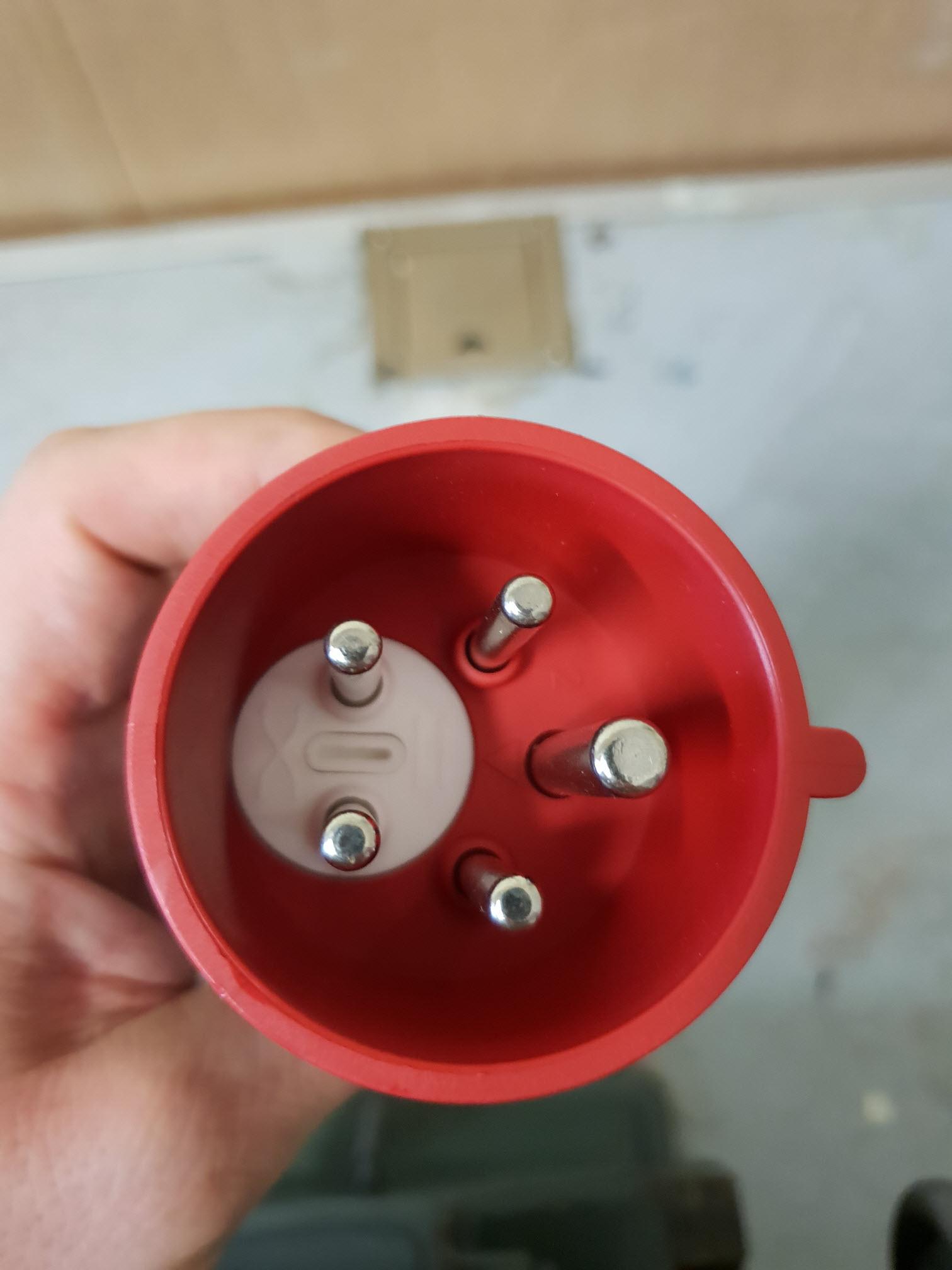

I recently got myself an old Schaublin 70 lathe but am in a bind over how to set the motor up and was hoping you might be able to help.
The lathe has a 3 phase motor that is fixed onto an old table with tool drawers etc. It has a five pin 16A CEE plug that I cannot connect to my 220V socket in my house, and I assume I need a VFD plus an adapter to connect everything, but I really don't know. Would anyone be able to say more by looking at the attached pictures?
Best regards,
Stian

Do you not have 400v three-phase available? If not a VFD is definitely the way to go. There should be a diagram in the electrical cover showing the different hookups for 230v or 400v. As to sizing and wiring up a vfd, I suggest asking at practicalmachinist.com . They have a subforum just for vfds and transformers etc. with very knowledgeable people. I've wired in a number of 3 phase motors but am not confident enough to advise someone else on it.

With the motor set for 230 you'll only need the vfd. The PM guys will have you sorted soon [emoji106].

I just did this for a Hardinge lathe.
Generally a VFD is to allow variable speed from a motor. But in my case, the VFD is 110v single phase power and 220v three phase output.
I fixed the cycles (hZ) at 60 rather than varying it so it becomes a phase splitter/step up transformer.
 Since you have 220v (single phase I presume) a 220v input inverter should have a 220v three phase output for the motor and you meerly fix the frequency as I did.
If the motor spins the wrong way once hooked up, just swap two of the three wires going into the motor.

I'm on PM more than here (different handle) and yup, there are plenty there who know this stuff well.  I can get you started as I just did this....still have it all sitting on a shelf under the bench (will weld a steel enclosure for it)
You definitely want to use the 3P motor; 3P is smoother than single phase and the OEM motor is beautifully balanced.   My motor was only 440 volt, no 220 option so I first ran a household 220V to a 1P transformer, stepped it up, and then ran it into a VFD to create the 3P.
1P in, 3P out is a common use for a VFD.  Basically a VFD takes power in, rectifies it and then draws from that DC bus when sending the power out to the motor.  In powering that DC bus it usually doesn't much care how the power gets there, BUT if you're supplying it with 1P instead of 3P basically 4 of the 6 diodes are handling all the amps.  You compensate for this buy overrating - using a larger VFD (in HP or watts) than what you need if it was 3P in.   Over rating is the common approach and works, however you can also hunt around for 1P in VFD's, afaik its just marketing....nothing is accomplished over using a 3P in and over rating. (the later being likely more common and easier to find)
There is a caveat on that - sometimes a VFD will check for voltage on all three inputs and not work if its not there.  I haven't come across that, but its possible.   I've used Eurodrive VFD's and there is no issue with them, just over rate and away you go.  Fortunately for these small motors VFD's are cheap (on my big machines some are 7.5 hp, VFD cost gets large so I use a homemade rotary phase converter to get 3P).  A shot of the SEW Eurodrive I used is below...as I say, installation is a work in progress so it looks rather unprofessional until I get it in an enclosure.  Eurodrive are the worst manuals ever, but they work.  Anyway from the shot you can get the model, the 220V version of this should get you working without needing a transformer (but you need to unsure the motor hookup is for 220)
The VFD gives you some other advantages like a ramp up.  I had a bad time with the lathe throwing belts starting in the high speed belt position.  a 1 sec ramp up solved this, it took away the jerk on startup.
One more really important point.  DO NOT use any switch gear between the VFD and motor; i.e. do not run from the VFD to on/off switch then to the motor.  There'll be a terminal block on the VFD for low voltage remote control of speed, direction and on/off.  You can use the OEM switch with these if you want it to look the same or just use a toggle and pots....but put nothing between motor and VFD!

I noticed you mention sending the power direct to the motor from the VFD, and I nearly did that myself on the Hardinge; however, that uses a dual-winding motor- so it has one set of windings for "low" speed and a second set for "high" speed. If I use the VFD direct, I cannot use that feature. (I understand I could wire it to "high" only and let the VFD control speed)
Also it runs in reverse as well. So, you have four speeds: FWD and REV, high and low in each. And, when you use the levers on the lathe to change, it applies the spindle brake mechanically. I'd have to eliminate the mechanical brake feature if I ran it direct, to avoid burning up the belts.
So, what I ended up doing is to bring the three-phase from the VFD direct to the output of the main contactor in the lathe. Doing this, I have full functionality of the lathe as intended.
The VFD deals with this just fine, although going to "stop" (with the brake), from "fast" the VFD detects a problem and throttles back because the motor stops spinning faster than the VFD thinks it should. SO, you have to be patient and not run it like it was full production in 1960. Otherwise, it works flawlessly with no issues at all. It is possible further tweaking the VFD settings would eliminate this error.

Hi Stian,
I wonder why nobody mentioned this, but if you want to run your motor from 230 V with fixed speed only, this is easy.
Now your motor is wired in star connection, for 230V you must
1. change it to delta connection (in the connection box, with the metal bridges)
2. connect both 230V wires to 2 of the 3 terminals
3. connect a motor capacitor (5-10 µF, depends on motor power) from the  empty terminal to one of the two 230V terminals. To reverse motor direction, connect it to the other 230V terminal.

Hi guys,
I used the tips you provided and got myself a VFD, a Teco 510. However, it did not work out of the box and I struggled a bit before stumbling upon this fantastic video on youtube:
A lot of what he talks about I think can be relevant to more newbies like me :)
