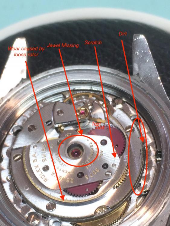

I posted in an earlier post the problems I was having getting a retaining clip for the Rotor. However this problem is bigger than I first thought. This watch was supposedly serviced  by a very reputable Swiss watch company who charged £475. this was over 2 years ago. It ran for a few weeks after but then stopped. Why he did not take it back is another story.
Anyway onto my tale of woe. When I opened the watch case this is what I found. In my opinion this watch has not been cleaned. When I removed the reversing wheels they were filthy.
691486942_Firsstinspectionafteropeningwatch.thumb.jpg.8c02188a19d653590883b95c01611cef.jpg
I have not been able to find a replacement bridge so I have secured the old jewel with loctite. However this is not good because it should be secured by what looks like a rubbed in jewel method. see below:
My question is does anyone know where i could purchase a new new jewel or a replacement bridge. The customer will have to pay so cost is not an issue.

Thanks Erik, The bridge for the 3035 certainly looks the same. I tried to register with the website you have given but it was not successful. If my repair does not work then this could be an option. The cousins catalogue picture shown (pp198) is correct BUT the clips supplied are a completely different style. So I still have not got the correct clip. I have put in a bid on eBay for one I found in France. I have some small c clips that are too thick and they might work but again I have my doubts.

If you have the tools I suppose you could widen the jewel hole,  turn a chaton for the jewel, and press fit the assembly.  The measurements would have to be spot on though and I'm not certain you could press in a jewel that was originally designed to be rubbed in.  Perhaps they have a different outside geometry than a typical friction fit stone.
Another thing to consider is how much stress the oscillating weight would put on this fix.  Perhaps that's why Rolex used a rubbed in jewel as opposed to a press fit?

I suspect you have a worn axle on the rotor as well. Jewel and axle should both be changed together. If the jewel hole is oversize, you could TRY locktite bearing set (slightly different than threadlocker) if the fit is "close enough". If it's really sloppy, you could try the ghetto solution of rebuilding the bore with epoxy and then reaming to the correct diameter. But there's a lot of load on the jewel so it might totally fail (something to try AFTER you find a replacement bridge)

Thanks I have inspected the axle as I know this is a known fault with Rolex. However it is in good condition. Probably a new/good quality used bridge will be required. That will be the decision the customer will have to make.
Just an update. The repair I did with the jewel seems to have worked. It had been on test since Saturday morning and was taken off Tuesday morning. The jewel is still holding great. I have returned it to the customer giving the customer my reservations. If the jewel does fail I now have a spare bridge. The clip that was  missing I purchased from cousins although a few thou under the original spec it is working fine.
