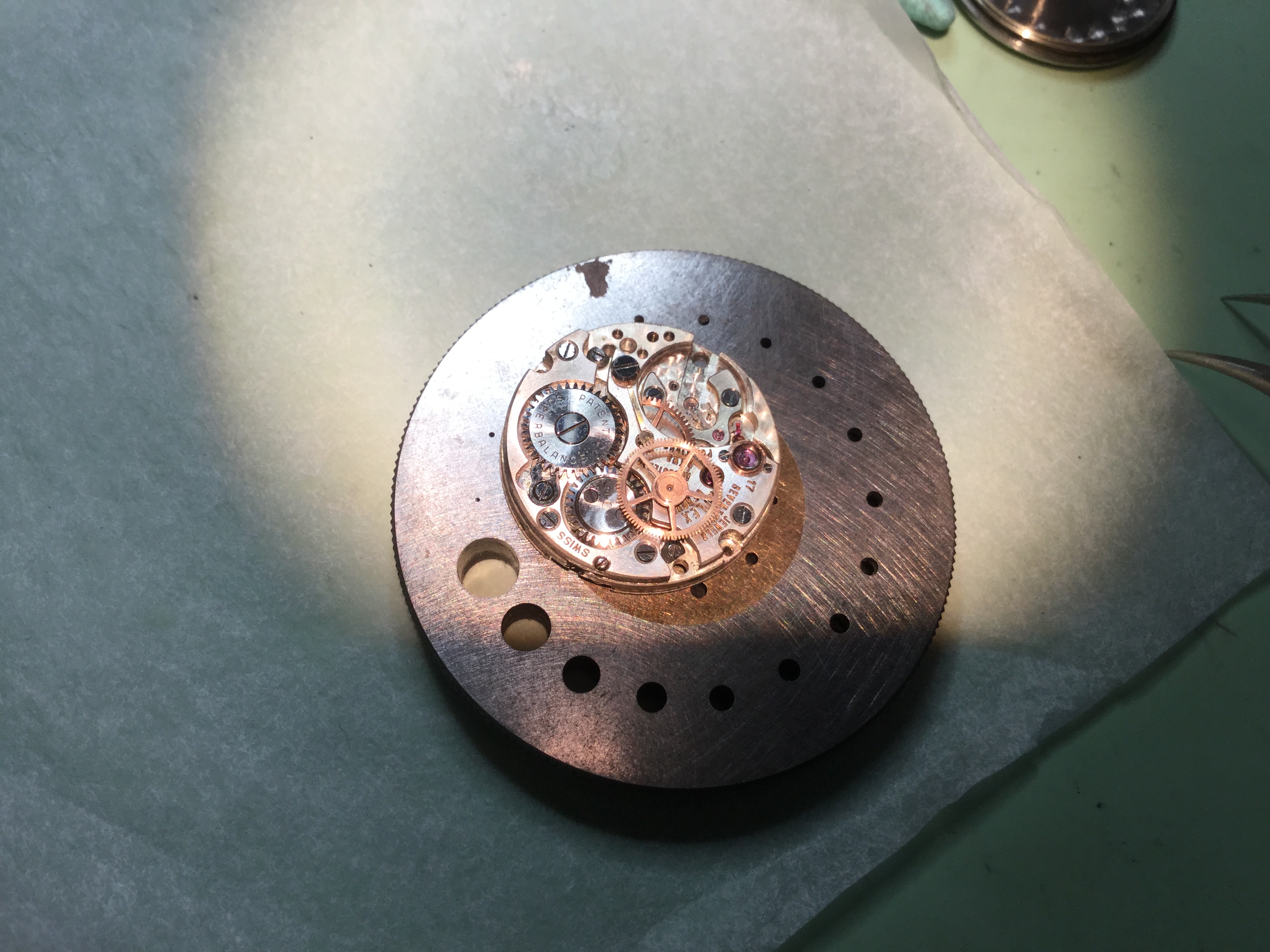

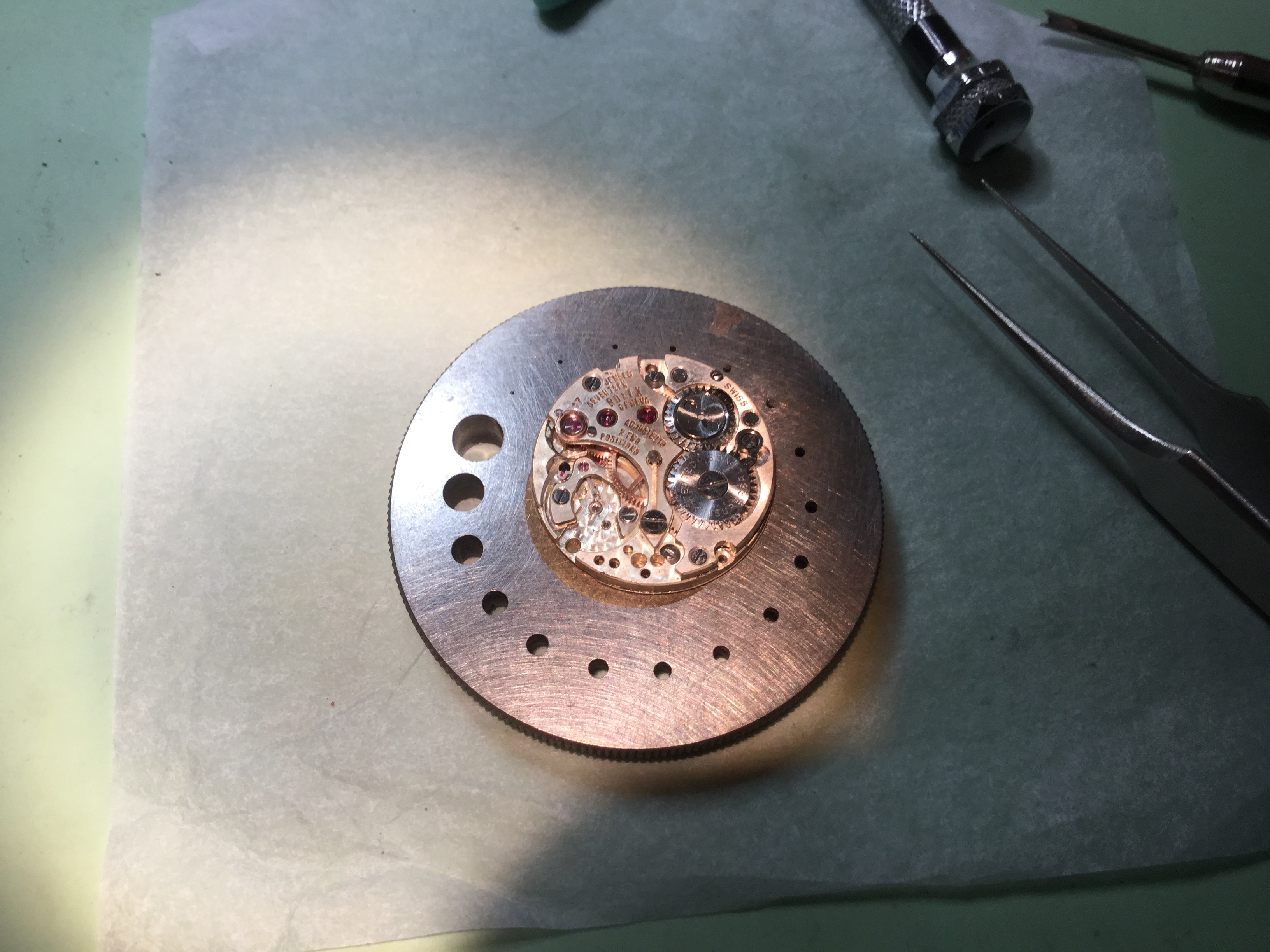

Hi, any advice on interchangeable parts for a 1948 ladies Rolex Oyster.  The movement has the following markings
Rolex 8 3/4 Hunter 0528  17 Jewels. The Pallet fork and the roller table are both damaged and I don’t have the skills to repair / make replacements. Can anyone advise if other Rolex movements share the same parts which I can substitute as I’m hitting a blank searching on the movement details.
Thanks in advance
Edward4CEBB892-AB3F-4214-A87A-7F47F93E73D0.thumb.jpeg.627a578d18f49a1b0d72c31e4a68e79e.jpeg

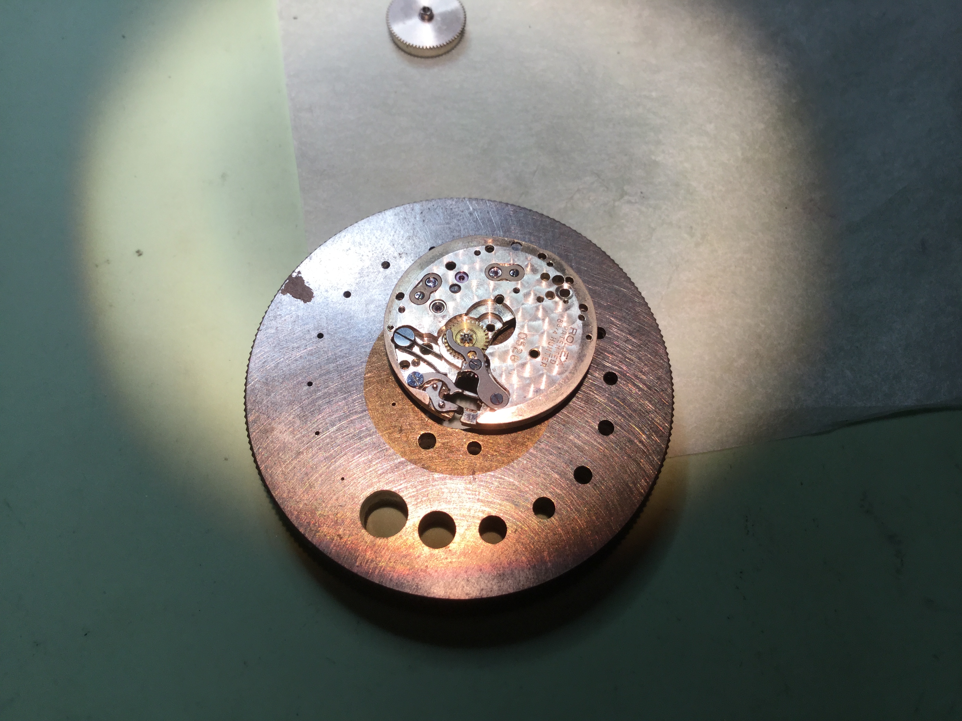

There may be more clues as to what the movement is by showing a picture of the other side, its a early calibre so is almost certainly produced by Aegler  and with 17 jewels is a Prima  varient these 8 3/4 movements where also the base calibre for the first Rolex Automatics.

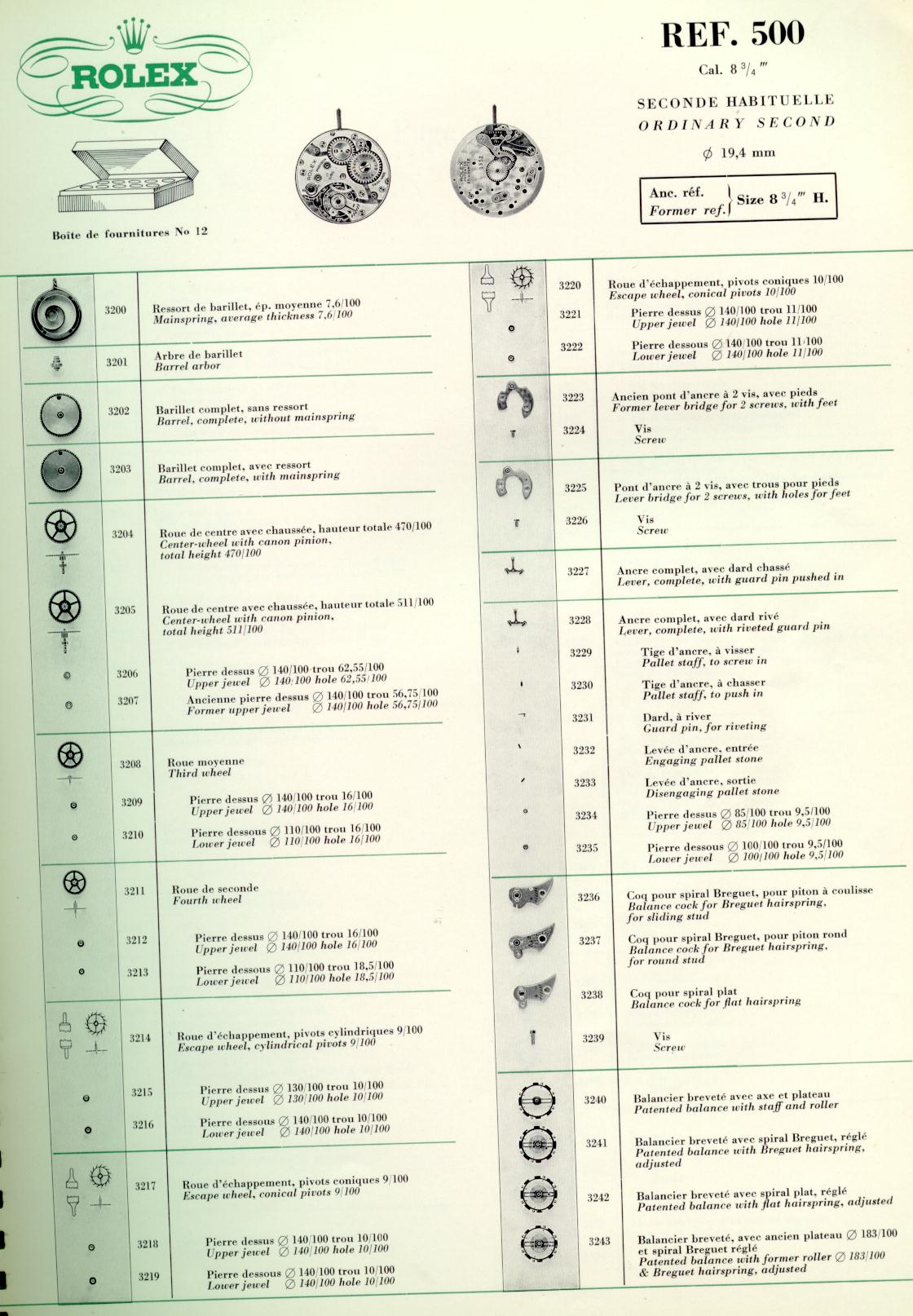

The movement is a Rolex calibre 510 most parts are common to the 500 series of movement see sheets below for part numbers5b2b393cbdeab_500I.thumb.jpg.b75b005a26f83b80da0e287986fb1fc1.jpg510.thumb.jpg.08c040acd3c80bd0ebe3faebc513b312.jpg
Interchangeable parts with other calibres:
The roller is also used  in Gruen calibres 818, 819, 823, 833, 879, other Rolex calibres 170, 250, 600, 620, 630, 635, 640, 645
