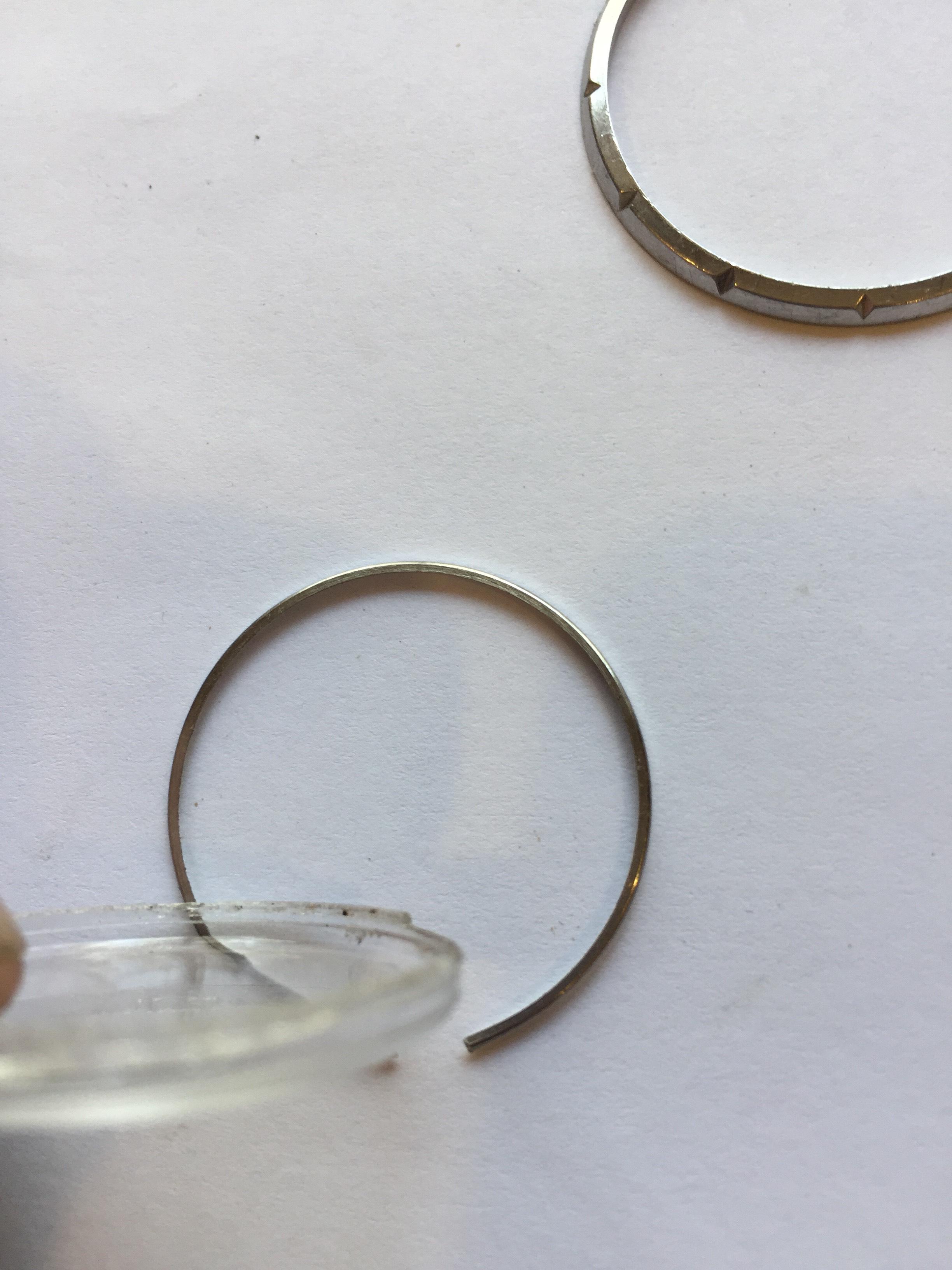

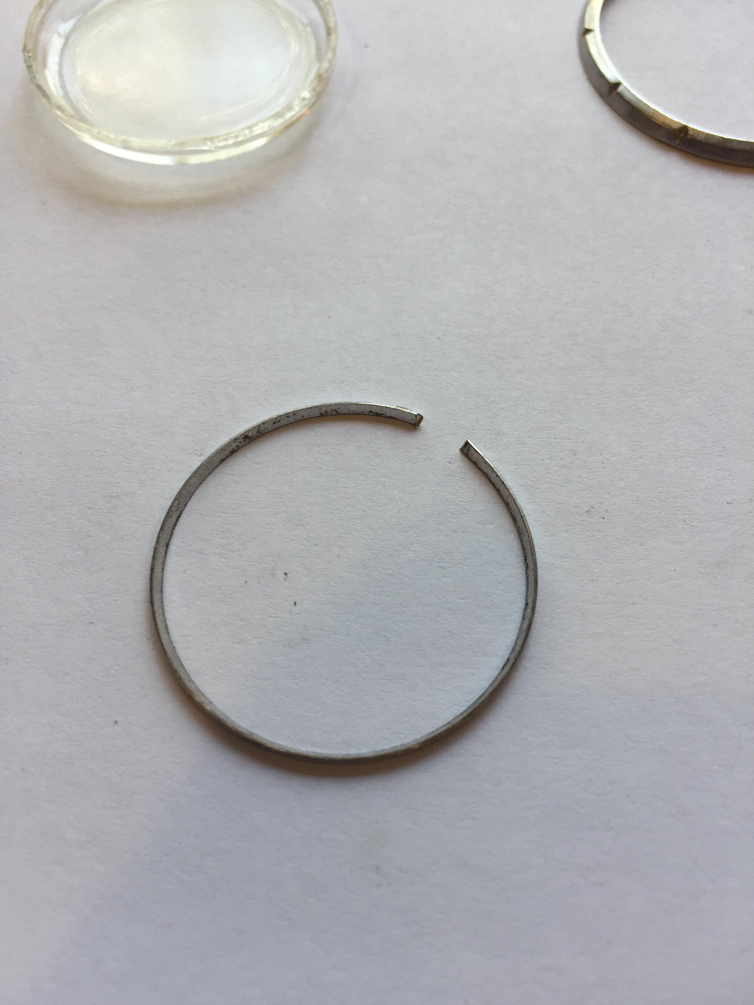

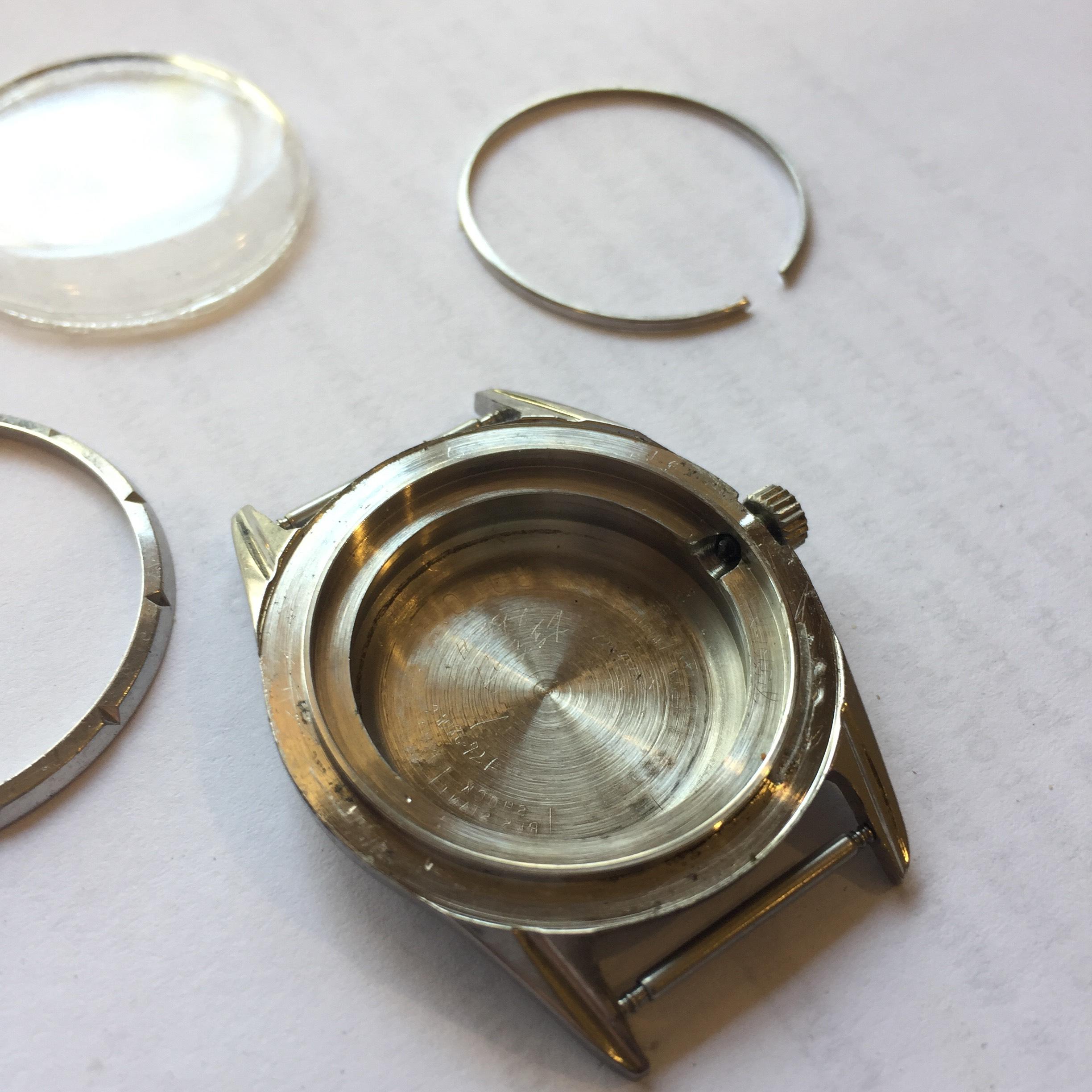

I pulled the watch back apart. I just had it at a watch repair place where I had a crown fitted (original was missing). He was also the one who added the ring below the crystal and told me I needed to find this "spacer" to lock down the movement. From what I can tell the ring has been modified or re-purposed and is not thick enough to provide sufficient contact with the dial. I've included a picture of the inside of the case and other relevant parts. Perhaps all I need is the correct ring below the crystal?

Sure looks like the movement should just sit inside the case. And that the tension ring inside the crystal shall hold the movement down. But finding the right one? Maybe a Sternkreuz ACT with tension ring could work.  You probably have to test and see what works or not?
Indeed the movement does not require a spacer.
What is the problem with the tension ring and the crystal ?
I had an Accutron once that came with a standard ACT tension ring acrylic crystal and I replaced it with a new one and everything was fine, you just have to do some tests.
Usually they fit.
Thanks to everyone for the input! Upon further examination it does appear that the tension ring is too thin and therefore the crystal is not able to apply enough pressure onto the dial. I may explore some options for shimming between the dial and the tension ring to get enough compression or try sourcing alternate tension rings. The other issue with this ring is I suspect the original had a stepped geometry so that it centered the dial and took up the clearance between the OD of the dial and the ID of the case.

Think so to. I didn't find the English word for it . Seen that kind of stepped tension ring in some Bulova watches. I had about the same problem some years ago with a Bulova 666 diver. The tension ring was wrong and pushed the crystal out when i tried to put the caseback on. Couldn't figure it out. But did some reading and found out that i had a stepped tension ring.Which i didn't have. So what i did was i turned the tension ring upside down. Worked out nice. Couldn't see it even if you looked closely.
