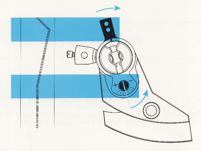

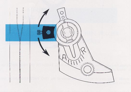

So a generic answer with me having to guess the type of watch you have. So for that I've attached images I'm assuming if the wording you have a watch that the stud can be moved and the regulator can be moved? So to make sure you're moving the correct ones I've attached images. Sometimes there is confusion over which one does what that leads to confusing results.
So the problem of the regulating system like this is it has lots of range to it it's a very very sensitive to movement. Then the parts are stacked on top of each other they can move together even though they're not supposed to. This just requires lots of patients moving things around.
