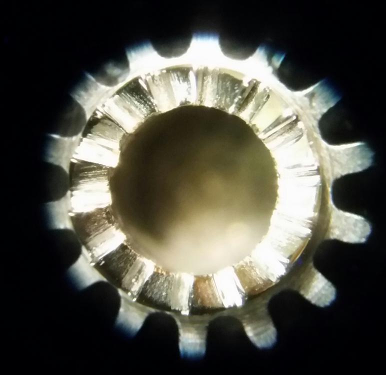

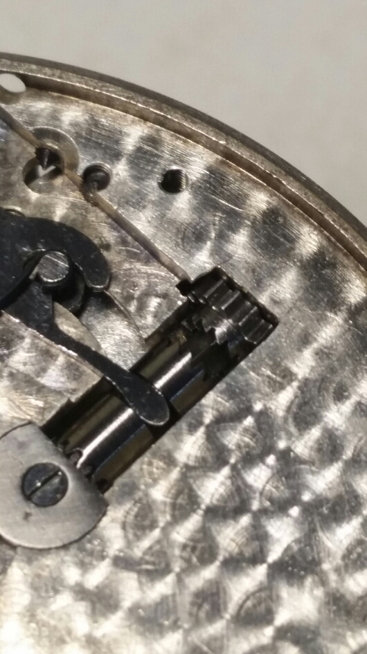

Guess it's file size, here's a picture of the clutch. Identification isn't the issue, just the sticking teeth lol. I got it fixed with another winding assembly but I would like to know why the originals stopped working after cleaning. Thanks!

The parts all went back through the cleaner, followed by a broach to get inside the recesses, then a wipe with the rodico....:)

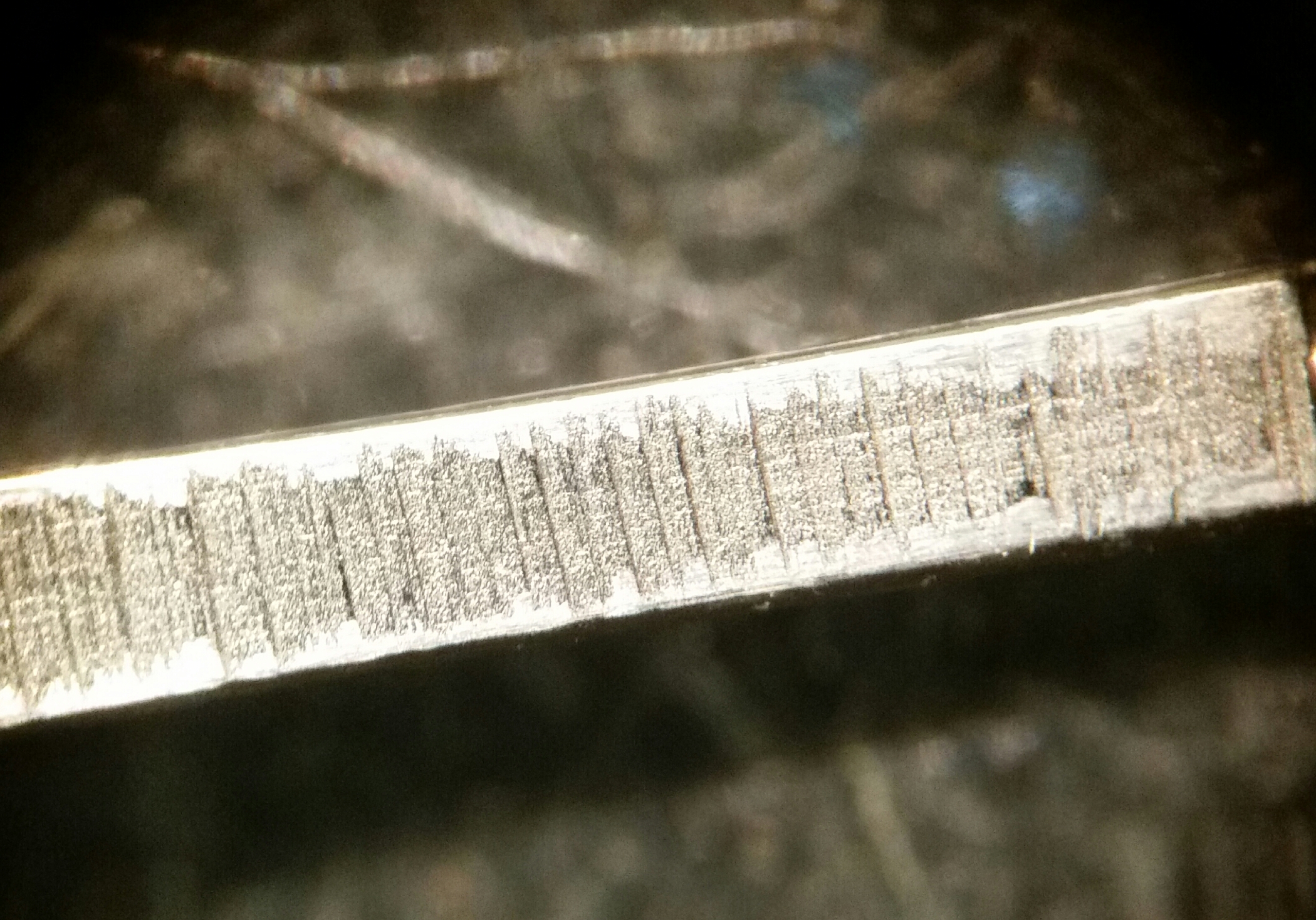

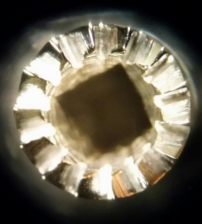

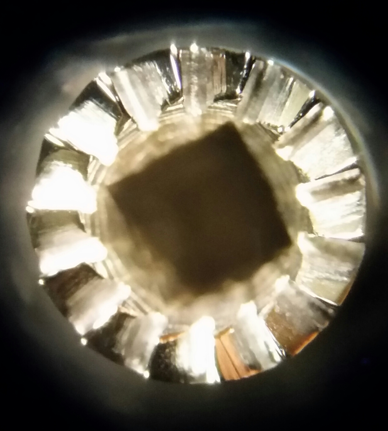

Here's some pictures of the freshly polished old parts under 30x magnification. It's really hard to see in the photos but all the mating or friction surfaces are pretty much mirror finish. I haven't tried it in the movement yet, I may just leave it for another project sometime as the one I have in there now is working perfectly.
