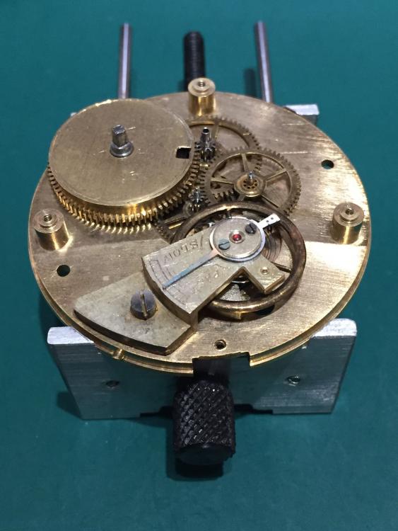

Well after nearly three weeks of putting this project on hold due to work commitments, I have finally got around to cleaning the movement and reassembling. Thanks Geo for your recommendation of removing the balance cap jewel - fiddly but relatively easy and cleaned the dirt from this area. See photos below.

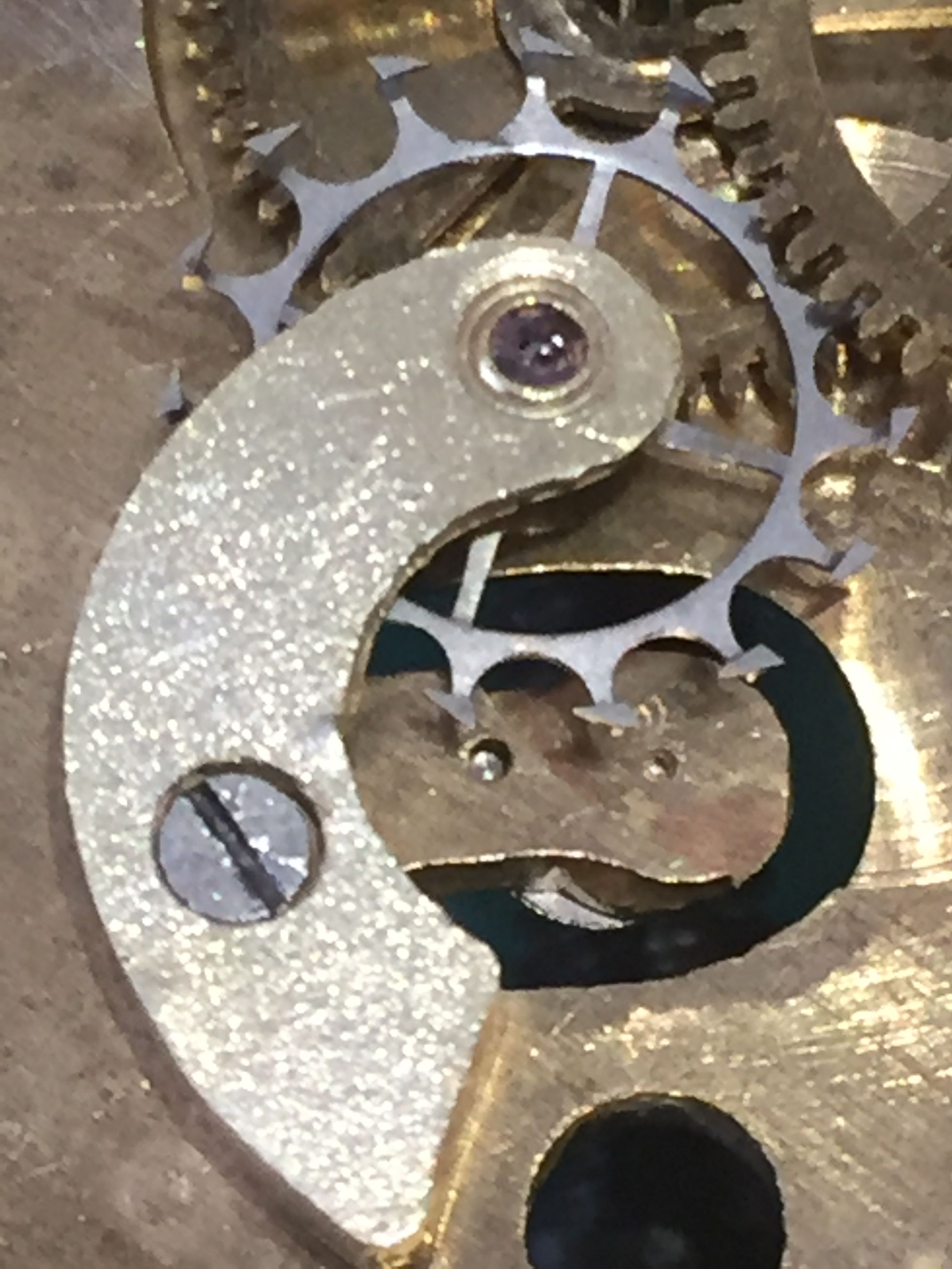

Now after re-assembly, I have a new problem. Although very fiddly to engage the balance cylinder with the escape wheel and its pivot, I managed to do it okay. Carefully spun the wheels and everything seemed to work, though the escape wheel was hit and miss, so I thought I'd get the bridge on and see if the alignment would help. Again, no problem carefully fitting the bridge but when the balance wheel swings, it only intermittently moves the escape wheel (and yes when this happens, the other wheels turn freely).
So this morning, I took the plunge and disassembled again to make a closer examination of the escape wheel pivots and its bridge arm. It was then that I noticed what I think is a fracture in the jewel, which I have attempted to show in the photos. I've also noticed that when laid flat (inverted), the bridge arm end is slightly bent down at the jewel end but again, I'm not sure whether this could be by design.
Any suggestions for resolutions would be gratefully received. I must re-iterate this is my first project ever, so excuse any bad terminology or naiveness :)
