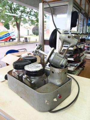

I have both, the Ultrasonic I use for cases & straps & the watch cleaner I went down the cheap route buying of ebay as I'm expanding into watch servicing & felt at the early stage I didn't know what I wanted! however its been on the bench a year & I like it!
bit of powder coating, a rewire & some details & it looks pleasing on the eye & presentable. If your used to what you have, repair it.
That's what I like to see Lee, attention to detail, not just repaired but refurbished to a high standard!
