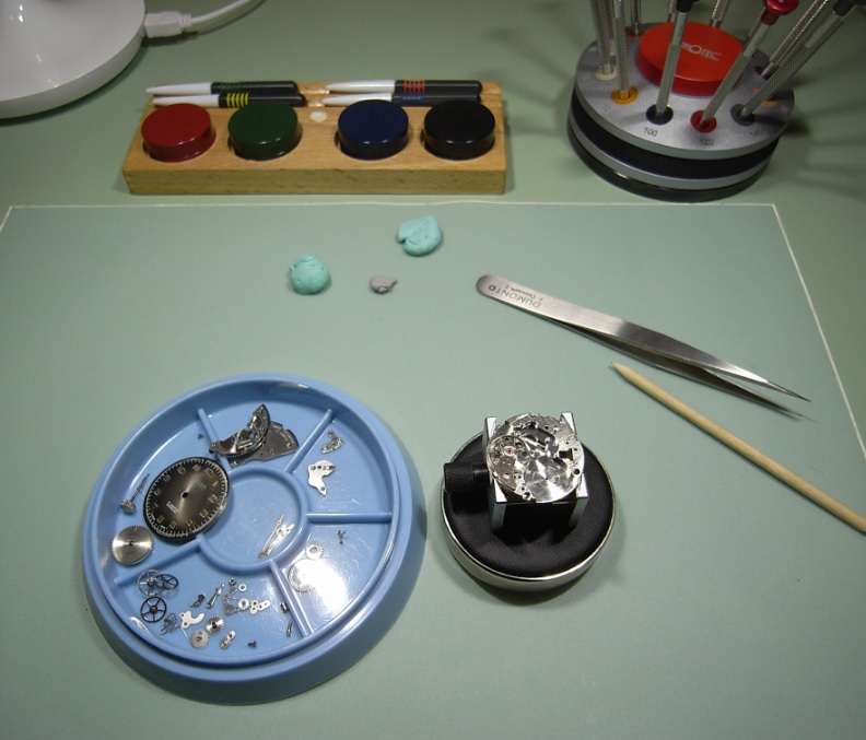

Hey Gang
It's been a long road finding parts for this watch, and after the "Indian Connection", I was very wary in purchasing parts via Fleabay.
Those who have followed my posts will know I'm currently servicing an AS1012 movement in a little "Cocktail Watch".  Well, the same lady gave me another
watch as a "practice" watch that I could keep, and guess what ... it had an ST96 movement!!  Yeah baby!! :woohoo-jumping-smiley-emoticon:
So I pulled a parts tray with my brother's watch in it and got to work!!
It even had the same brushed finish to the bridge plates, so it all matches perfectly.
Here she is all complete and shinny!!
Needless to say, by brother was thrilled to bits seeing the first watch he ever owned ticking away once again :)
A good end to a fun project, hope you all enjoyed it too.
Oh ... to add one more note here.  I got to use 90% of the original parts of my brother's watch, so that was a real blessing too.
There was no need to do a complete movement swap.
