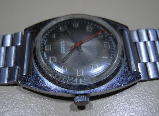

I got a new project to start on: restoration of my brother's watch he got for his 9th birthday.
This is not an expensive watch in dollar terms; but the memories and history are priceless, and one I really want to restore to excellent condition.
It stopped running decades ago, but he has still kept this watch for nearly 40 years, how many of us can say the same about their first watch?!
My brother has placed a lot of trusted in me to restore this watch, and I want to repay that trust by restoring this watch to the best of my ability.
Note his name (blocked out) and date it was given to him are engraved on the back plate.
After opening the back I was pleasantly surprised to see it was a 17 Jewel movement ... so for it's day it was a proper watch; and not a cheap throw-away item you buy at a service station.  This would have been purchased at a professional jewelers back in 1975.
Unfortunately, the first issue was discovered.  The locating ring is missing, and the only thing holding the movement in place is the stem ... not good.

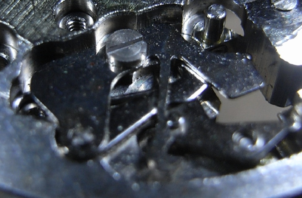

I opened the back and donned my loupe to unscrew the Setting Lever and noticed that my counterpart in India mustn't have had a 0.8mm Driver ... and this is what happens when you use a driver too large for the head of the screw. (Took the picture with the movement removed for a better image)

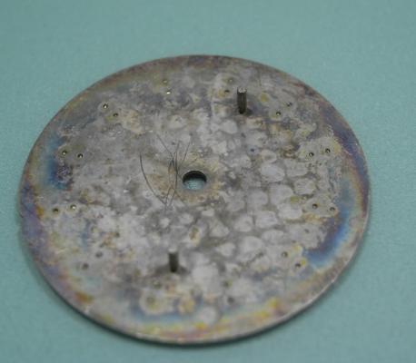

Next I removed the movement from the case and removed the hands.  The dial looked in perfect condition.
Once removed though you could see it had been made from a scrap piece of tin, complete with grinding slag  ... I must say that I am still very impressed with the face of the dial, created from this piece of offcut.
Further inspection under the loupe, I noticed the "Full Service" included oiling the jewels with all purpose grease ... ROFL!  I tried to get a good picture off it, to increase the comical value; but this is the best I could do.  I checked the endplay on the pivots and as expected, there was a considerable amount of play.
Even the post that holds the yoke has been mushroomed out like a rivet, and I was unable to remove it *Chuckle*
All in all, this movement has paid it's due, and is completely worn out.  Everywhere you look the wear is extensive.
