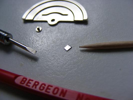

This watch came in not working a couple of days ago post-31-0-75828600-1402863392_thumb.jpg
Inside was a very poor quality movement with no markings or numbers on it,
I noticed that a lever had broken off the left chrono button post-31-0-63980000-1402864060_thumb.jpg
I took off the rotor & winding gears and found the broken part inside jamming the watch,
the winding gear plate also held in place the train wheels so it was a bit fiddly to reassemble as there were six pinions to locate at the same time !  post-31-0-64419100-1402864748_thumb.jpg
Assuming that a new lever wouldn't be available for such a cheap movement... the watch is now back together working minus the chrono function. post-31-0-63580000-1402865125_thumb.jpg    :)

Thanks Geo !  although I did think about putting it in the bin !    :fpc:

Very true, it does actually look quite well made from the outside, it's quite heavy and has a deployment clasp bracelet,
only when you look inside the true horror is revealed, the movement is small with a large plastic ring holding it central.
I would be curious to know what the guy paid for it !
