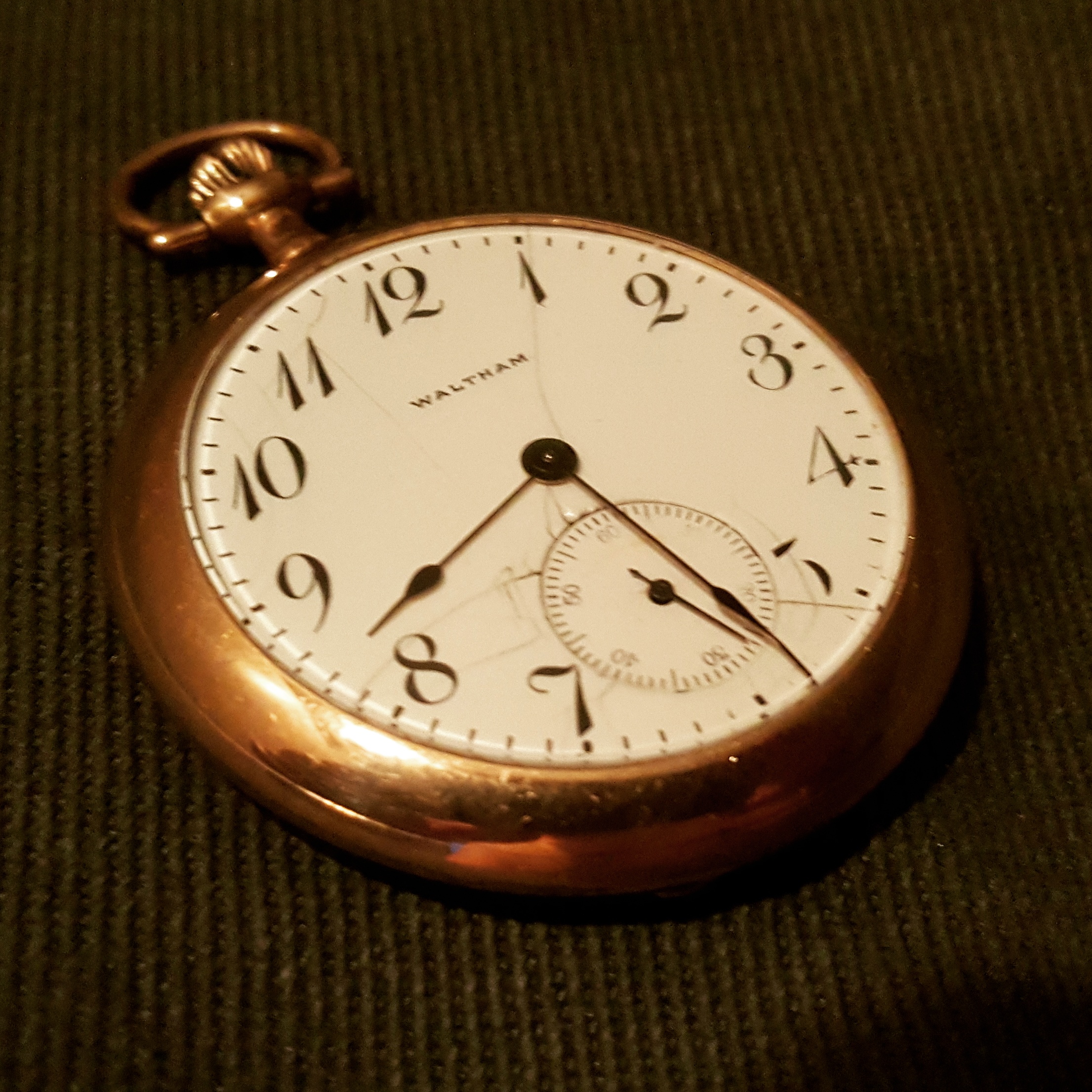

So I gave the manual spring install a few dry runs and then I made the bend.  Worked the first try!  Thanks all, I'm super pumped to have pulled this off without a winder.  Here's the Waltham ticking away with new crystal and hands.  Have to say the aftermarket hands took some more shaping and fiddling with than I expected, but hey not bad for a 100 year gap in manufacture.  It runs decent and is keeping fairly good time, but I cant leave running.  I need more practice oiling pallet stones and once I get a new cap jewel (bottom cap has a small chip and slows the pivot) it should sing.  Dad will be pleased, had it 50 years and never saw it run.
Well done I bet you are pleased with yourself all you have to do is ask and now you have the bug !!!!!
Thanks guys!  I sure am, this movement was really gooped up.  This was the first time I've tried one-dip - amazing.  Checked it this morning and it's about on the money.  I did notice, however, that in the face up position I could hear music coming from the watch...the same chord over and over.  Sounded a lot like me in middle school!  Not sure, but sounds like the regulator pin is strumming the hairspring like a guitar...?  Hoping to get a timegrapher this Summer, I use tick-o-print sometimes but don't have a solid movement to verify its accuracy and reliability.
Nice work mate, quick tip for you, ive had a few cracked dials like yours and have picked up a tip on cleaning them, get yourself a pack of denture cleaning tablets, 1x glass of warm water drop in the tablet and the dial and wait 3 mins take out dial rinse off and I guarantee that them cracks will be invisible.
Before you start make sure the numbers are actually in the enamel as they can be lifted if you are not careful,  its not happened to me yet but I'm always careful.
