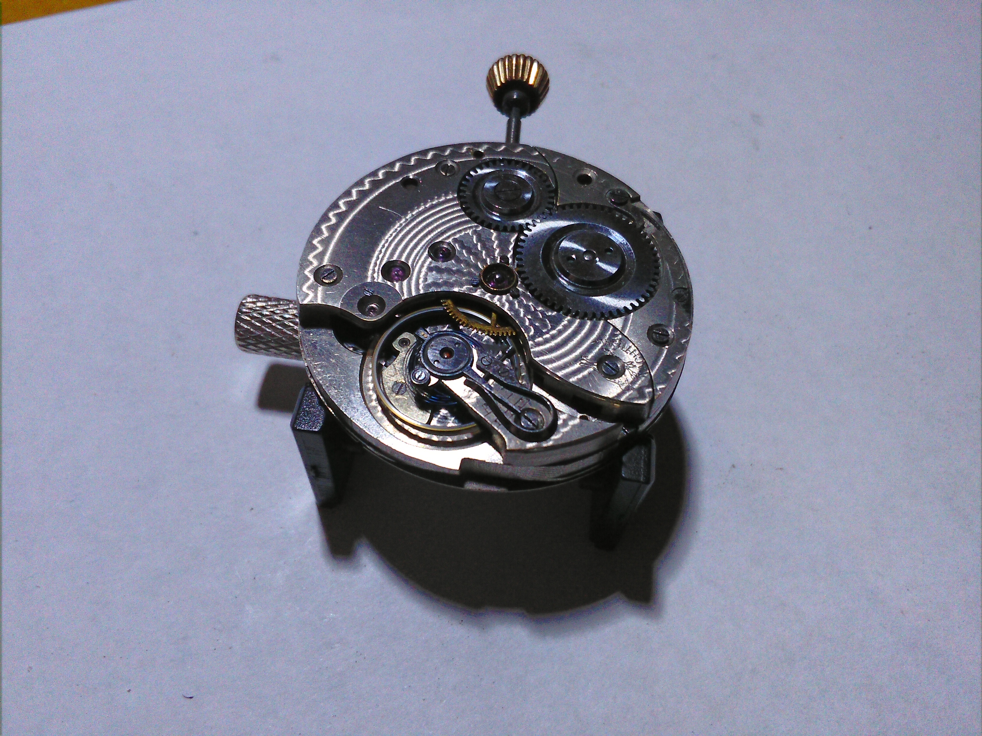

Once disassembled it turned out having many issues not just the broken balance which was mentioned by the seller.
1. Identification: The nachtigall stamp on the 3/4 plate is obvious, but what is that arrow logo under the barrel bridge? Is it a G or 9 or e? Nothing similar on Microlisk for pfeil (arrow) or G. And there are '36' marks under the dial and the 3/4 plate. Maybe serial number?
2. Error list: Broken balance, ok maybe can make new one. Broken 3rd wheel pinion, ok maybe can repivot this. But how to repair broken and bent center wheel? I think that the previous "watchmaker" had issues removing the cannon pinion since even i cant do that, there is nothing where i can grab it. How can i remove the cannon pinion?
And there are some minor issues like the missing swan neck, no dial feet, broken set lever and one broken screw...
3. Look at this lever. It has no pallets and it is pised(?). It is riveted, maybe i can change it to a palleted one?

Thank You! Thats it, FHF, Fabrique d'Horlogerie de Fontainemelon SA
I have the feeling that those two steel levers are the "pallets". At least i hpe so, since i dont have to repair the lever as well :D
Finally the cannon pinion was wrapped in 2 layers of soft red copper and pulled off with plyers.
One problem solved, three other discovered after cleaning the mainplate. Balance and 3rd wheel jewels are cracked. 4th wheel just chipped off a bit but will do. One dial retaining screw simply dont have threads just a tapered and and was pushed in his hole.

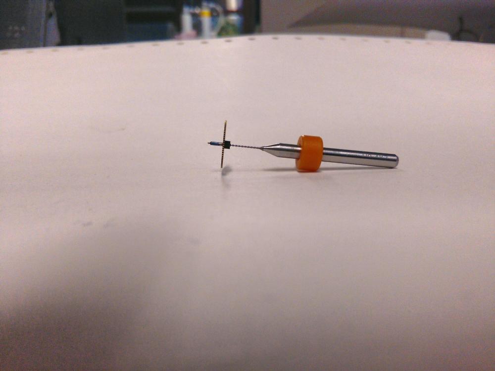

Just a quick report. 3rd wheel drilled with 0.4mm carbide microdrill. The other pinion is ~0.2mm and the book said the hole should be 1.5x the final pinion diameter but my 0.3mm bit is broken. The depth its around and should be 2x the diameter.
The process was not straightforward. The 0.4mm drill burnished the hole (maybe the staff is too hard, although i tried to anneal it in a gas lighter flame, see the color of the staff), so the hole was predrilled with the 0.2mm drill and then reamed with thw 0.4 drill.
Next i will try to drill the balance. The healthy pinion is around 0.15mm, but i can choose the broken one since the jewel on that end is broken. By the way, the jewels from my friend will arrive tomorrow. Now its time to make the jewel setting closing tool:)

Now lets drill the balance! The healthy pinion is 0.1mm. The other i am drilling to 0.2mm.
The left female cone has a 0.2mm deep hole and shoulders made with 0.4mm drill. The right one has special shape to align the drill and the balance perfectly centered (see my pivot drill post). I have made a picture of the hole but it cant be seen even through the loupe. Will investigate it with the microscope tonight.
