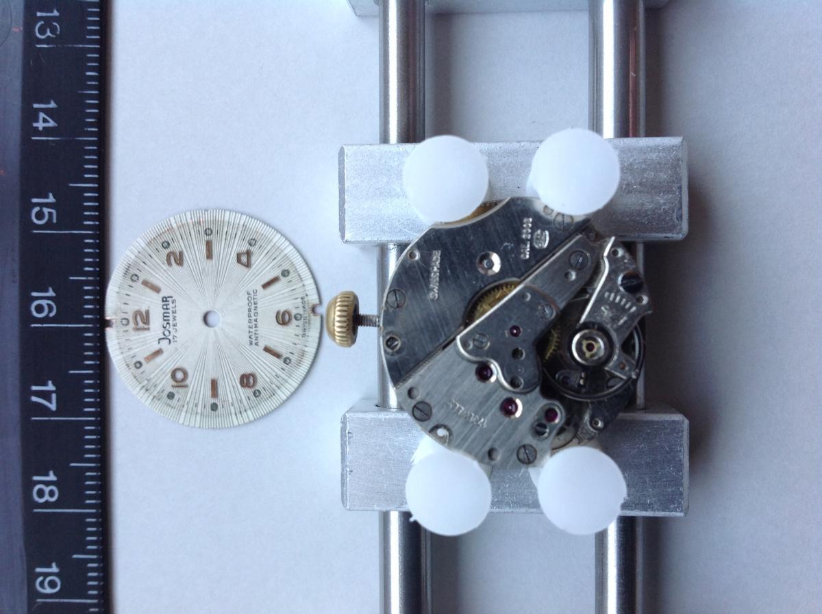

I have an old Josmar wrist watch (CAL.2003 and the word 'BROC 454' both stamped on it) and I need to find a top balance wheel jewel cap. It's not a shockproof movement and the cap would be held in place by a brass looking three pronged holder. (Which is present)
I took pictues of this watch before stripping it and the cap doesn't appear to be there!
The watch works fine, face down, but immediately stops with a jolt when turned over.
Turning it back to face down, it starts to work again.
Yes, there is lots of verticle 'end shake' and therein remains the problem.
So if anyone can come up with any suggestions, I would love to hear them.

Found the cal 2003 however Is this the movement. If so it is a Audemars Piguet & on Cousins web site parts are obsolete or restricted.
Hello, Clockboy and thanks for you reply.
No, that isn't the same movement as the one I have.
Hopefully, the picture that I have taken will identify the movement.
Len.
post-711-0-63355100-1458116143_thumb.jpe
Sorry Len struggling to identify what the movement is. It looks like under the cal 2003 is a logo (see pic) this might give the ID.
The pic you have shown it looks like the cap jewel is held with a removable shock spring so a bit confused as to what you are looking for.
The logo looks like it could be a Brac. But the caliber i am not sure of?  The shockspring looks like the one  Citizen had on there watches . Maybe that will work?

The jewel is there, but the jewel cap isn't and that is the problem.
I will now go and see if I am lucky enough to find one.
Regards.
Len.
That is very helpfull Clockboy and, with the information gathered by Rogart63, I have found out that the shock protection on this watch is
'Resomatic' (Whatever that means!) and I have emailed Watch Part, Huddersfield, to see if they can help.

Best of luck Len. There are lots of shock spring styles BUT their availability is very limited.The jewels are not so difficult if you know the size etc as Cousins have  a vast selection.
