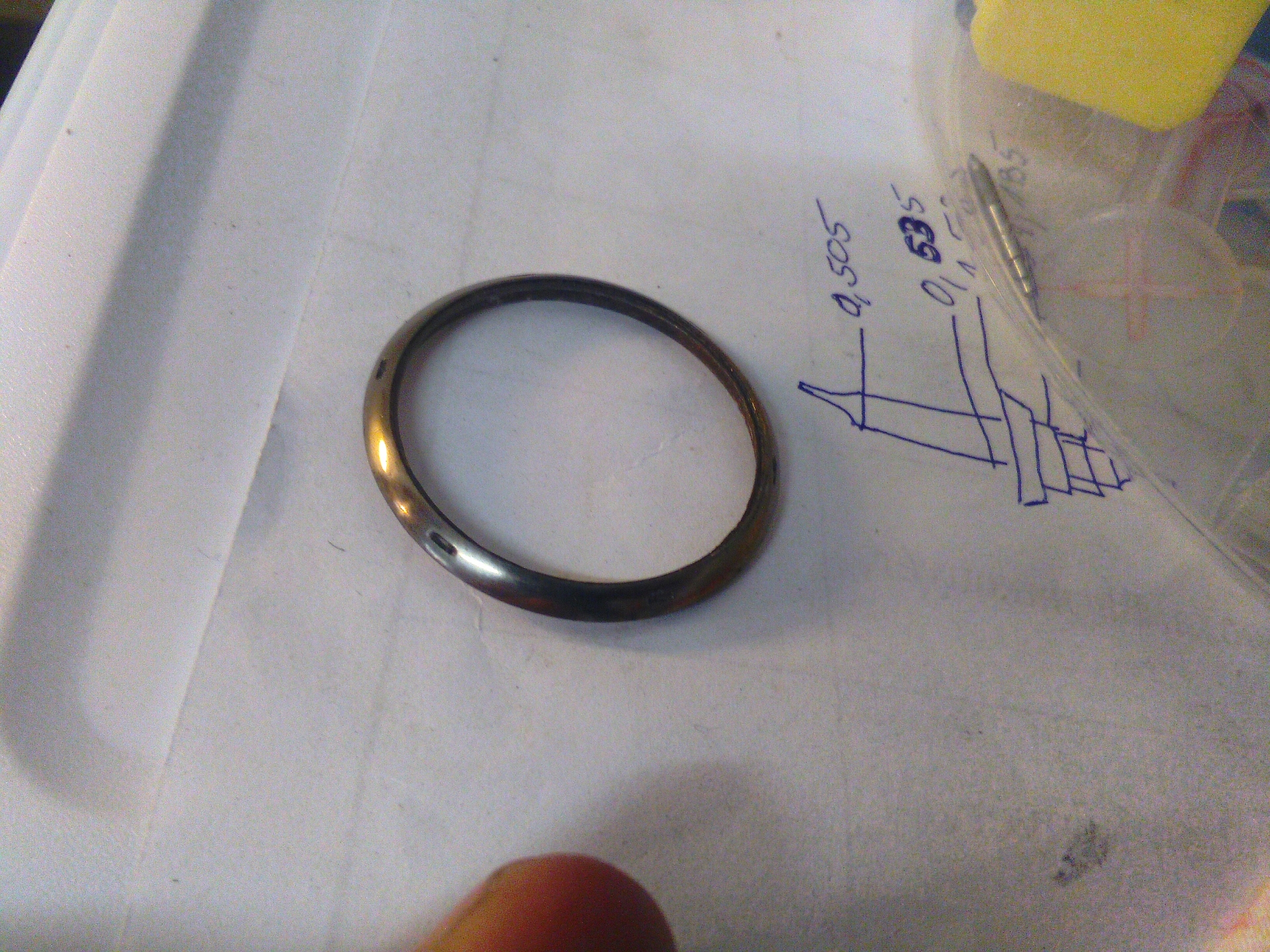

My old nickel sulfate batch finally recrystallized. Made an electrolytic nickel bath quickly. 1.5g NiSO4, 0.25g boric acid and a pinch of p-toluen sulfonic acid in 10mL water.
The zinc ring (electroless copper striked) was washed down with a tissue soaked in banzynum. Two AA batteries parallel were used az a power source. Plating was carried out at ~70 Celsius.
Here is how it looks like after the bath rinsed in water:
And after rubbing with 10000 grit polishing paste by hand:
Now i can go for the watch case and the cromium bath preparation.
