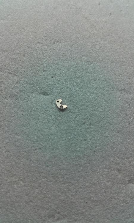

2 hours ago, yorkist said:
Hi again, the setting lever is screwed down here to hold the winding stem in place by virtue of  the small upstand you can see sitting in the recess on the stem
On 8/29/2016 at 3:14 PM, yorkist said:
Hi, seems to be the setting lever for the keyless work.
seem to be struggling to get it to fit,could you be more specific.as stated before i am a beginner but if i am shown something then i am fine and will remember.thanks,bernie.
The setting lever has 2 functions, the first is to hold the winding stem in position and secondly to operate the setting of the hands.  It is held in place by a bolt or screw which is accessed at the reverse of the setting lever on the top plate.I have downloaded a picture showing the position of the setting lever, 10 being the lever and 11 being the screw. Hope this helps
I have also sent a PM
Best of luck
Yorkist
thanks yorkist.got the setting lever back in and sorted everything else out ,then found a screw had sheared off so got myself some small drills,so should be able to sort that out ! already got new screws thanks again. bernie. PS i am doing a new post re seagull sp16 if you know anything.
