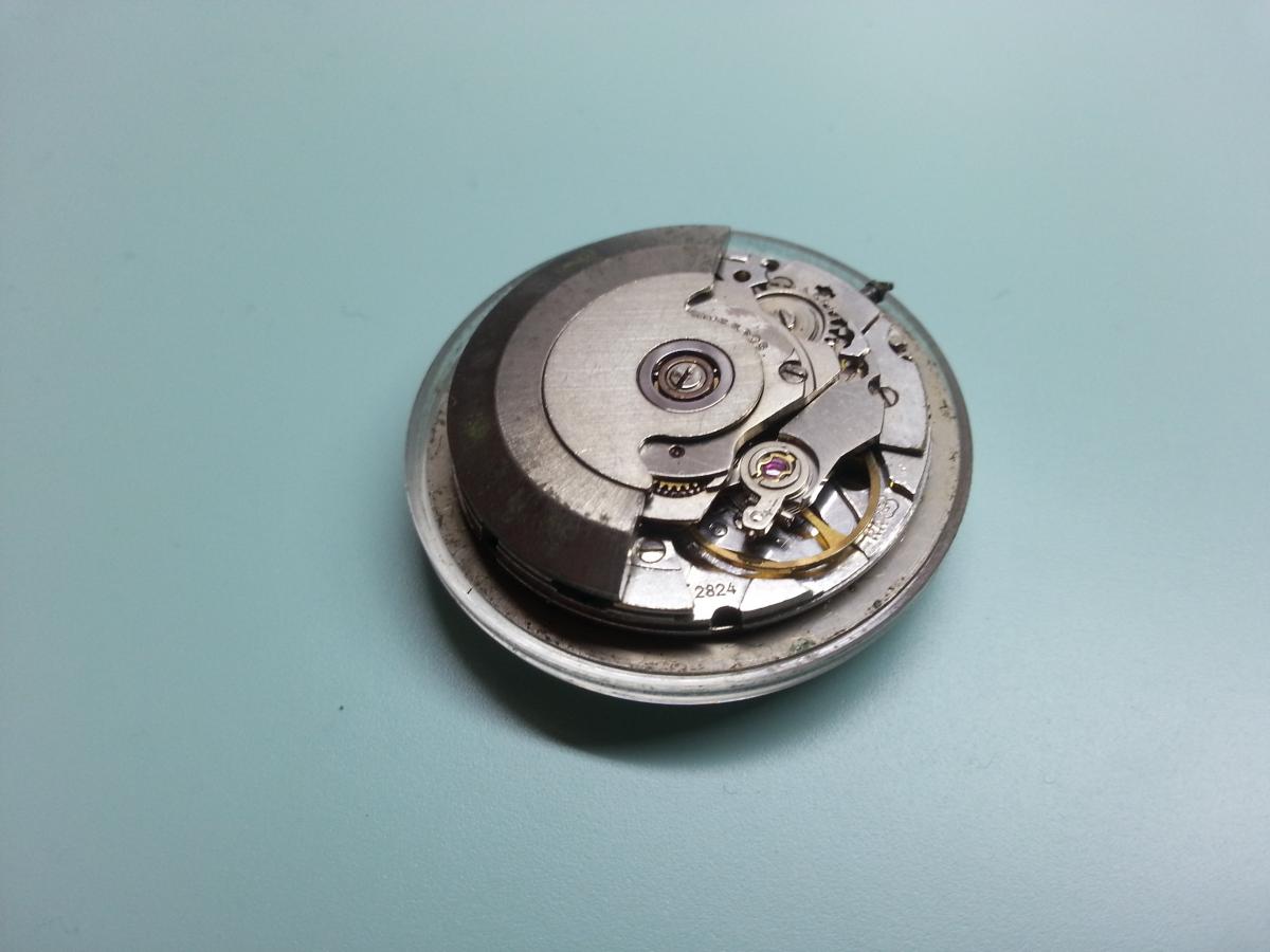

Thanks guys, yes it's a mess at the back but looks fine from the front. Hopefully I can get it useable again, but I'm not going to rush it. Ishima I tried your second method, worked fine thanks very much. Here are a couple more photos from the inside. First the back - it looks even worse from the inside, this is where the butcher really went to work I think. Presumably the rotor was catching and this was his solution. Can you get a panel beater for a watch case to sort this do you think ;)?
Second photo shows the movement, which is an ETA 2824 (also has the mark looks like RR on the plate, I'm guessing it might be BR). I was hoping it might be pristine, but far from it - quite a lot of green in there unfortunately. This will be a long job I think.

The green that you are seeing will be verdigris and it should come off with some careful cleaning in a solution of baking soda. Add half a teaspoon of baking soda to a cup of water the soak the parts in it until the verdigris disappears. You can gently scrub with an old toothbrush to help remove the corrosion.

Well I finally got round to opening it up and stripping down - as stated it's an ETA2824. It's actually not in a bad condition overall, jewels are fine, pivots are good. There was a lot of dried up gunk, particularly in the barrel for some reason. The dial is pretty good, a bit of gentle cleaning with a dab of distilled water should do it. The hands may well need reluming or replacing.
As it is a chronometer I think it would be worth me spending some time and money on it, but I need to think about how much as I will definitely need to find a new case. The following are the problems I have found:
1. Mainspring is shot, needs a new one. Cousins don't have one - where to source? Ranfft says 1.2 x 11 x 0.115.
2. One of the reversing wheels fell apart. Can these be put back together? If not where to find? Again Cousins doesn't have. Are they interchangeable with other ETA movements? I can see some on EBay for the 2824, either Chinese copies which might not be compatible or they are aftermarket and still cost a fair bit.
3. The rotor had been changed at some point I would think. I can't imagine a decent quality watch not having an engraved one. I am currently watching a couple of watches on EBay which might help with this, and with the other items.
4. I need a new case!
Initially I am going to just source the mainspring and see how the watch runs after a clean and oil, then decide if I want to do more. Any help/advice welcome. Thanks

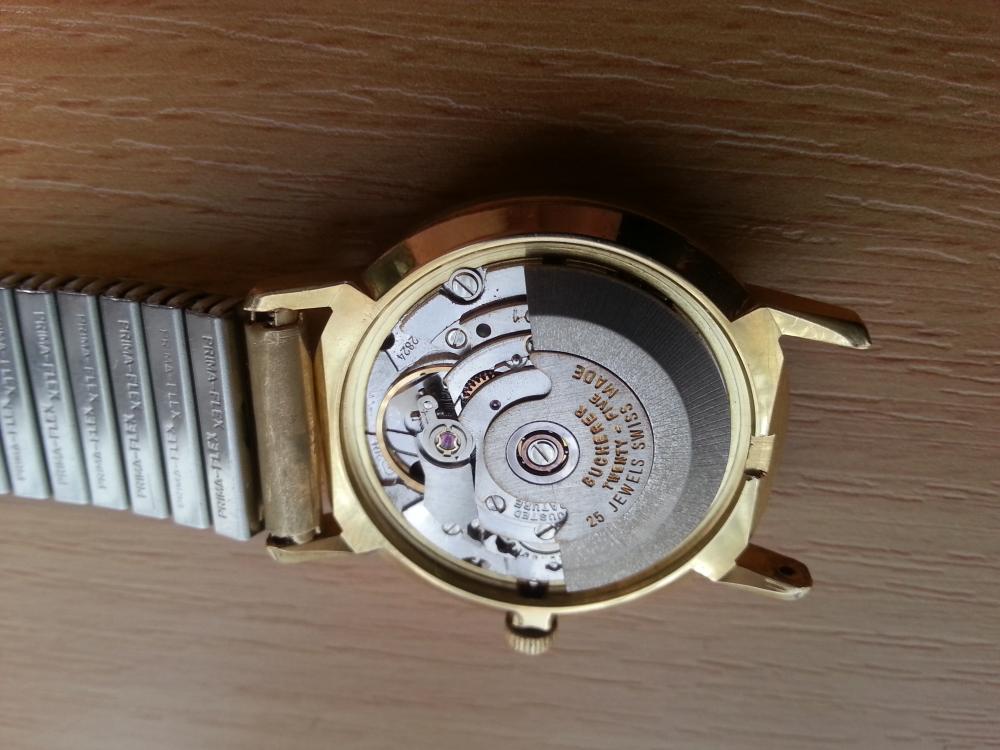

Finally got round to finishing this, thought I'd just post a couple of quick phone photos. It worked out quite well as I had another none working watch with an ETA 2824 I borrowed the case from, and I was fortunate enough to find another poor conditionBucherer 2824 chronometer grade very cheap for spares, including the all important rotor with markings.
Despite years of neglect and various things growing on it, the timekeeping is superb so far, there is a beat error of 0.2 which I might just leave. Although not normally my style I've put it on a flex band I got from another watch, seems to suit it well. The dial is in great condition, the hands also are good although I did have to relume them. All in all I'm pleased with it.
