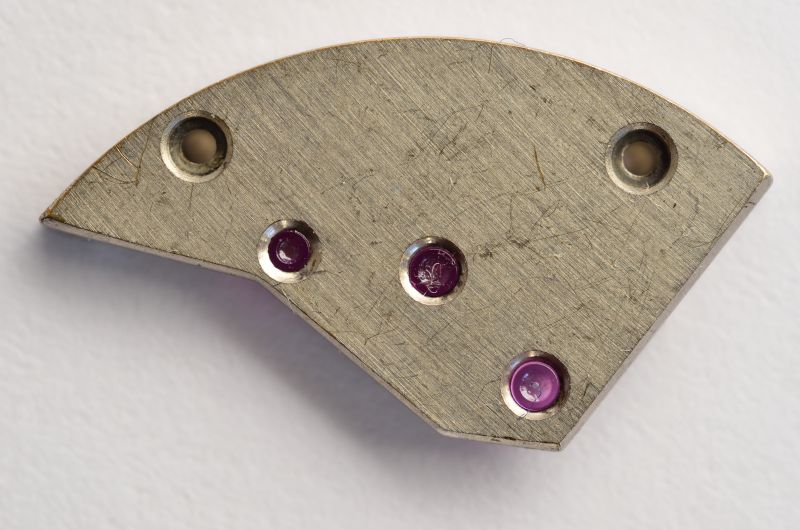

It's a "Wehrmann". Couldn't be wound and had a terrible rattle when shaked:
The first two photos is before opening the case.
It turned out that the only thing wrong was the ratchet wheel and its screw lay loose!
I believe it's a Unitas 6325, one of the so-called "Wehrmachtswerke". The train wheel bridge differs from what I have found on the internet, but the movement-plate is identical with one I bought on ebay for spare parts.
Of course I broke one of the Incablock-springs, the one in the movement plate, but I simply switched plates. The one in the balance cock I managed to preserve. I couldn't figure out how to replace the spring alone, as it seems to be non-separable from the movement plate (correct me here please).
After cleaning (ultrasound) and re-assembly + lubrication I think I was struck by beginners luck, as it seems to work! I haven't got one of those fancy testing machines (yet), but measured on the app Twixt it looses 25,6 seconds per day which of course i far from impressive but that was not what it was all about with this otherwise useless watch.  I did loose small parts in the project, especially the click spring a lot of times, but amazingly I found each little part again. Btw I found out that cleaning of the hands using ultrasound is no good idea - must have had a stroke there...:)
