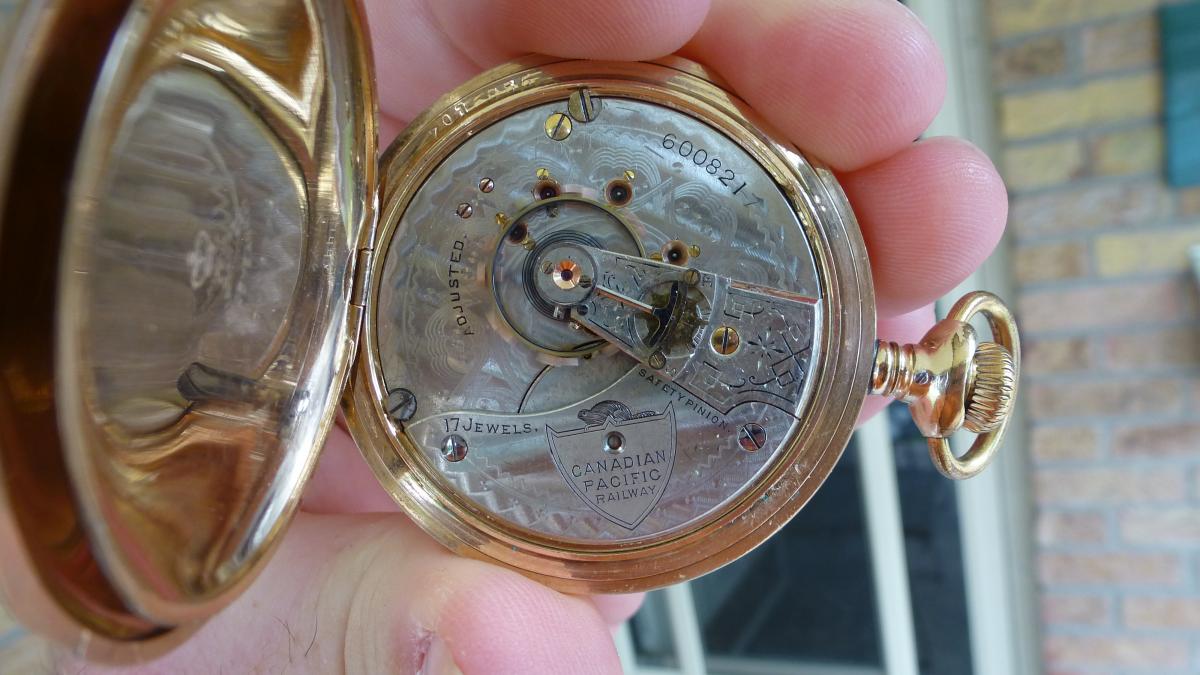

Welcome to the Forum - we look forward to hearing from you. That looks very similar in style to the movement in my Ball-Waltham RR watch. Excellent!
Cheers,
Will
HI!
I've just started gathering some pocket watches, and will probably be pestering people about how to work on them while avoiding destruction and tragedy :-)
Glad you're here!

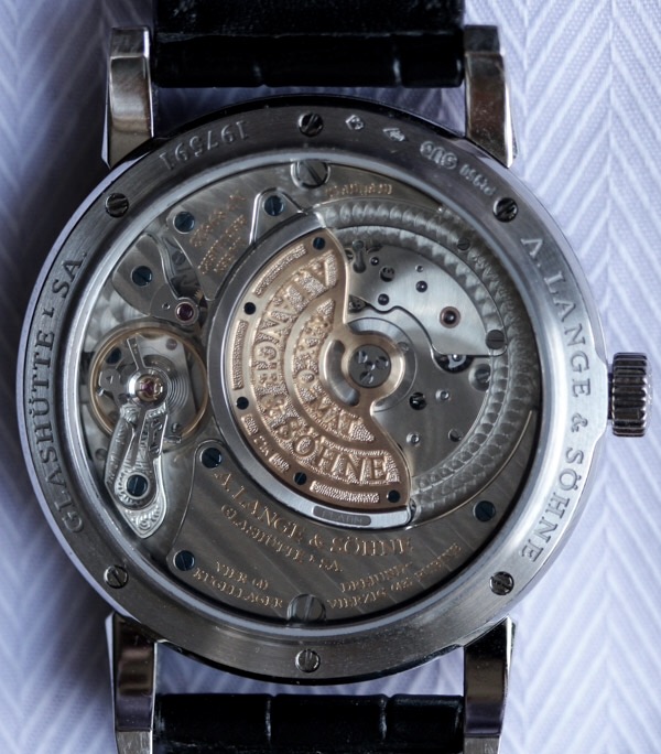

  On 1/7/2016 at 1:31 AM, ramrod said:
what a beautiful movement. we probably couldn't afford watches if they were made like that today.
Some watches today are finished like that and better. You are right, the majority of folk can't afford them.
Here's an example.
post-124-0-02943200-1452150259_thumb.jpe
