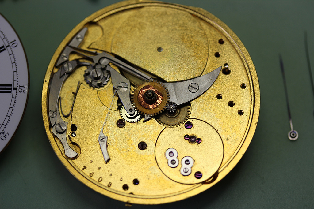

This came in with a broken staff. Somebody had already removed the broken piece which is now lost so it will be a small challenge as I usually use the old staff as a guide.

Is this strictly a "Time of Day" watch, Mark? There's an awful lot of extra gears and stuff on this thing! I'm also curious on the sub seconds chapter position on the dial.
I think it is truly a fascinating timepiece!
Thanks for sharing...
Don, it functions like the Omega Chronostop. A single pusher Starts, then Stops and Resets.

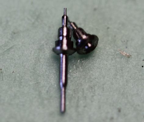

I use a 0.5mm solid carbide twist drill, it was like mating hedgehogs. The pinion was 1.96mm long x 0.5mm diameter reduced to 0.14mm diameter x 0.5mm long to fit the jewel.
Finding the centre has to be the trickiest part!
I squared off the end of the shaft in my lathe using a carbide lathe tool the using the same tool dished the end of the shaft. I then spotted the end with a 1mm carbide drill before using the 0.5 drill.

Removed a lot of material before parting off:
Trying the roller for size:
Now using a pivot file to fine tune the taper so that the roller will fit snug:
Now I have my roughed out piece I can start polishing and grinding the pivots down to size. Lower pivot is about double what I need in length as I do not know how long it should be yet:

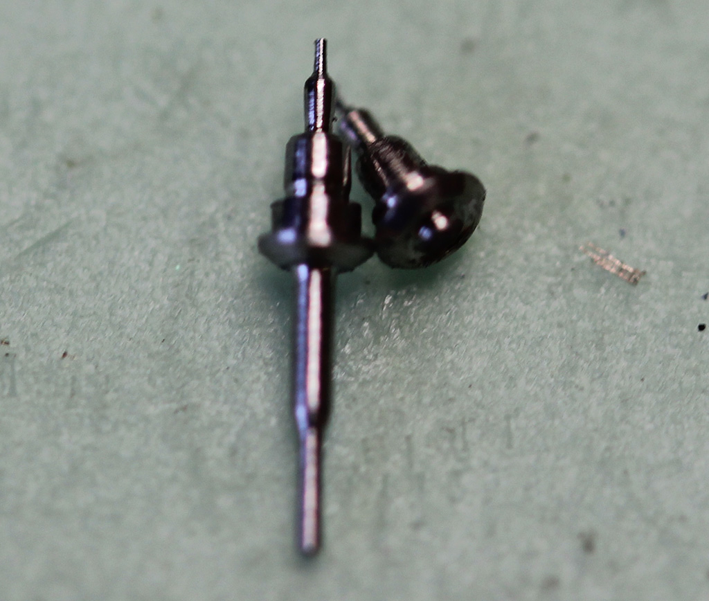

Wrapping it up for today. Heres a couple more pics.
I'v mounted the staff on the wheel so that I can use the Jacot tool. Grinding the pivots to size with my pivot file:
I'm about half way there:
