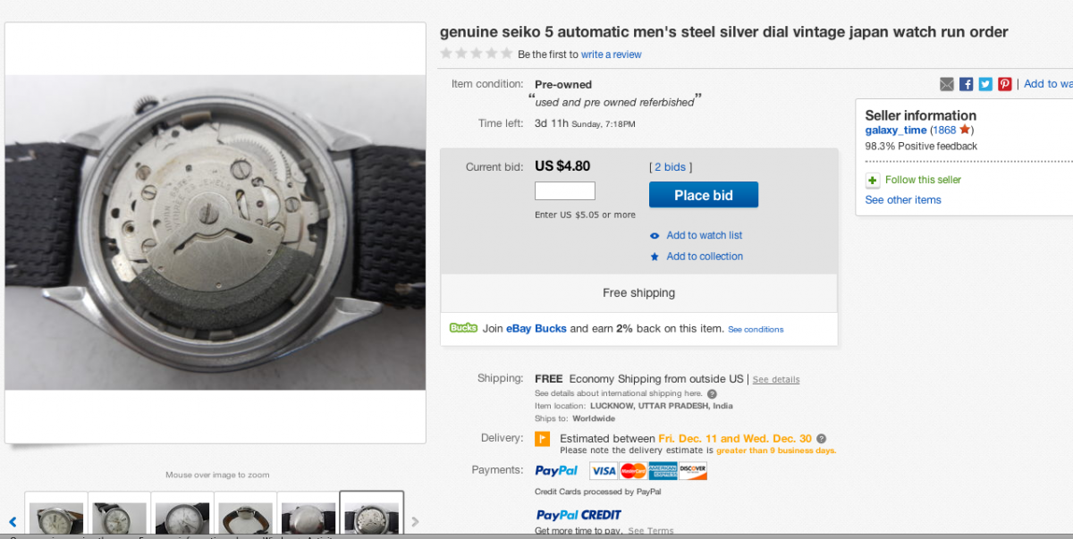

Hello,
I read the content & find out some similarity with my actual topic.
I have the same seiko 5, jut in a little worse condition... attached ....  😄
image.png.c239c9edd68a2c7a0e40cf668570489b.pngimage.png.0decba5014206ac20e8a08bc96ef6194.png
I bought it from a small market 3 year ago as not realy working one, but it started. I take it to a local watch repair shop and for ~100£ they fixed it(full clean, oil, some part change). After some time the watch lose the seconds hand --> repaired again --> after some time it started to make within 1 day ~30 minutes less than it should by normal operation. (weared full day, so it could wind itself) From the beginning it has a rotor noise, I tought it is normal by such an old watch...
I give back nowdays to the same shop, they fixed and cleaned again for ~100£, but the rotor was quiet, after 1 month the rotor gives the same strage and stong noise. Definetly I can also feel the movement of the rotor too as by the beginning. https://drive.google.com/file/d/1P9Uoj8vxwQSgZkUQ1UmYl13kI2op2NS8/view?usp=drive_link
After 2 times of full service (some part change, cleaning oiling...) I'm not sure, that my watch is in better condition.
This noise can be some loose screw, or the bearing is full worn, just the shop don't care about just tightened it more?
What can be the problem?
The watch winds itself up when worn, but today I experienced an other strange behaviour: the rotor moved from the watch itself a little (like unwind the already stored winding)
I'm not a specialist to know that this is a problem. Is this phenomena fixable or I need to search an other watch for daily usage?
Thank you for the suport in advance 🙂
