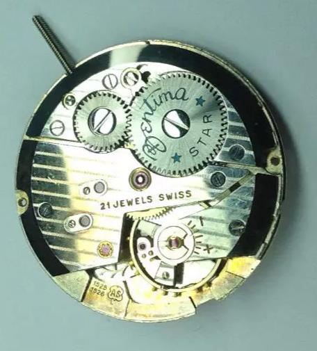

I'd think the free balance mod could be quite easy on a movement that already has adjusting screws on the balance wheel?
If you remove the regulator arm, the hairspring will have a slightly longer effective length, all the way to the anchor stud, so the watch will run slow.
That can be compensated for by filing or grinding small amounts from an opposite pair of weights (or removing shims), then the fine adjustment made using the existing screws.
eg. from a quick look on ebay - a pocket watch movement and a wristwatch movement. The pocket watch has clearly visible adjusting screws; I think the other has those also, though the image is not so detailed. There are many others, if you look as mechanical watch movements on ebay, including some ETA ones.

This is also a good idea. If the balance already has screws that would make it easier to adjust. It sounds like there are several paths forward if I decide to attempt these sorts of movement modifications.
