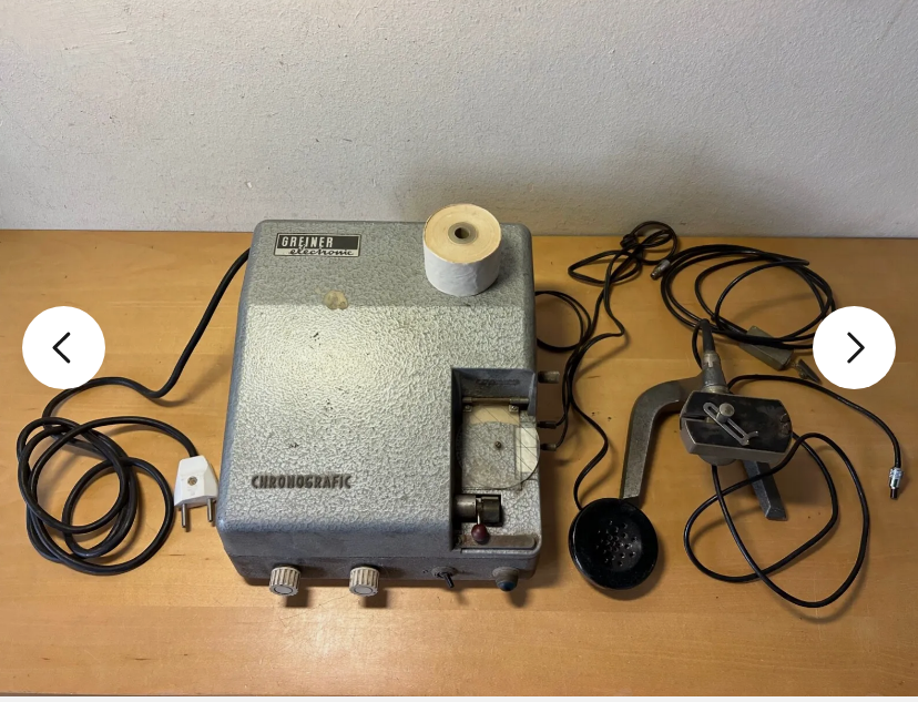

Here are the two timing machines I had both are far superior to the modern ones of today🤣 The first burns holes in the paper you start it by turning that knob on the right side. The second works with ink it has a block inside that you have to fill and then reconnect it. Both have plastic dials and you move them so at the lines and this tell s you how much you need to adjust the regulator. The second has a lead with a clip so you can time small clocks but I didn't find it any good. You see they were the good old days.
The one under question i believe is in the region of 3 grand. 💰
I believe I'll stick with my cheapo Chinese for now .

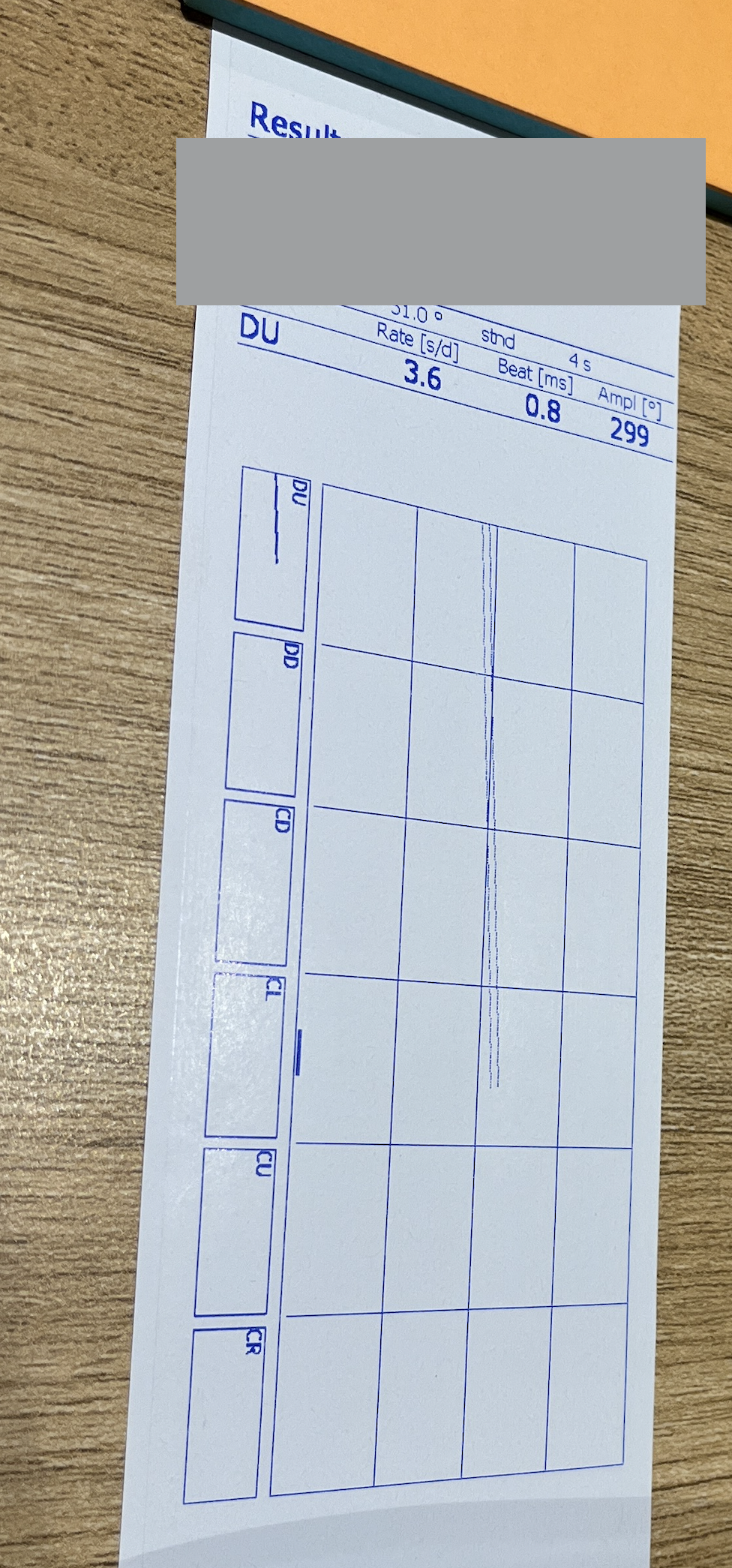

19 hours ago, Microbrandowner said:
How do we get the printer to spit out the consolidated results for all positions that we tested for the watch?
According to the user manual for that machine that I found on the Boley site, the only print option is in effect a "Print screen" function that prints whatever is on screen at the time.
It can either print the screen image or save the screen grab to USB.
On that basis, you would have to print the result for each position, as you evaluate the watch.
(It would have to be able to store multiple readings - and have controls to save each result when you have the desired stable display & to tell it you are starting again with a different watch - to print a multi-reading report).
Actually what is far superior is the users manual for your first machine. The user manuals extremely detailed and assumes the watchmaker doesn't know what a timing machine is and it spells out everything is truly one of the most outstanding manuals for understanding What you can do with the timing machine. Then just think burning holes in paper you don't have to have ribbon if you just still find the paper?

Thanks for looking into this @rjenkinsgb
The machine has two print options:
1) When the test is ongoing, if I were to hit the 'print' icon (it is a touchscreen display), the machine will print the results of the current watch positon. The print looks something like this (attached image).
2) When the test is ongoing, if I were to hit the "pause" button, and then the 'print' icon, the machine will print the result of the current watch position, _including_ the current graph from the screen.
The machine _does_ store multiple readings - if you see the image, reading 1 was dial-up position, and reading 2 was crown-down position. The machine does remember the graphs of those two positions, but won't print the consolidated result of the specific position.

Appreciate this insight @JohnR725. I am not a watchmaker, I am a brand owner and I am putting together our workshop with a watchmaker in residence. I understand 10 seconds is too short - that was just an example. Irrespective of the timing specs, our Witschi can't seem to print consolidated results.
