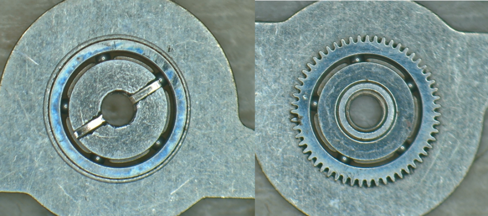

Has anyone managed to reduce the play in the rotor bearing on a Seiko?  This is from a cal 7019
A good tap with a large punch on the lower surface?
 It always a good idea to make sure you have a good bearing before you reduce the play, sometimes I tear the bearing to check all parts, steel balls ought to be checked under microscope.

The hole is actually a thread. The slots on top are to screw the bearing on.
I just found a scrap one from an old 7s26 movement. The bearing is different but similar construction. I'll try to disassemble it ...
Well it came apart 😯
The are just pushed together. I cannot see any shoulder, so the play just depends on how far the bottom is pushed on.
Those balls are incredibly small !
Correction - I was forgetting the washer. The top and bottom do push together solidly. There is no more adjustment available. The play is from wear on the sloped edges where the ball bearings run.
So to answer my own question - no you cannot reduce the play.

It is easy to reduce the free play of the bearing, even easier now that You have disassembled it. You need to bring the cones that form the internal part closer to each other. Of course, to do that You need to grind the downside part like I have shown in this thread.  Look at my message from January 24. Then nobody toke me serious I think.
Great, thanks. So basically you remove some material where I've highlighted in yellow?
BTW I put it back together, just to prove that I could. It's not difficult to take apart and reassemble.
Yes, exactly. You can take off material from there but in the end the separator must still rotate free. Be careful - not to grind to much. 3-4 movements on the file and try the end shake, and if still big - again.
Assembling is easy, but use some grease to 'glue' the balls. When assembled, wash the bearing from the grease in petrol.
The free play is not neccessarily due to wear, but  often due to the plate/ washer pushed outwards by weight of the rotor having overcomed the friction that holds it where put,  as Seiko just friction fitted it.
You should first check all parts under good magnification.
In case the bearing or balls are  anything less than perfect, just replace the whole thing  with new.
Cut four small nick around the washer for tighter fit, since the washer might be pushed back again if just  refitted as it came out.
By "washer", do you mean the notched disc as the lower left of the photos? (That's the only item shown that seems to fit?)
That is the part that functions as the bearing cage, it must rotate completely freely, separately from the inner race parts.

Since the rotor is not balanced , there is always a force exerted on the heavy side which tends to tilt the rotor and create the free play in the long run.
It worked perfectly !
I have a 1000 grit diamond sharpening stone which was ideal. Sliding the washer about 100mm 4 times took off about 0.01mm. I ended up taking 0.025mm off in total, which left it spinning perfectly with very little play.
