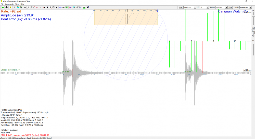

27 minutes ago, guidovelasquez said:
On the top is a image from the Waltham watch, on a cheap piezo mic.  Most of the noise is probably background noise I supose.  But there is a HUGE difference.   One of my other Piezo mics is a little better but still picks up every little sound in the room.  The Vibrograph mic works far better.image.thumb.png.f2d1c28b1c77337cf0ef35dae8d31ef8.png
Next image is a recording of the same watch on the vibrograph mic.  Same settings as above, no digital filtering.
BIG DIFFERENCE.  Not sure why but the vibrograph mic works much better.
And...  Here is the same Waltham watch on the Vibrograph mic, using E-timer and its built in Digital filtering.
Here it is with same settings without filteringimage.thumb.png.06309acfed4e02403d0c5166f601e103.png

11 hours ago, guidovelasquez said:
Listening to the recording, I notice a lot of noise. After analyzing it with Spectra, it becomes evident that below 3kH there is a lot of noisy signal.
Review these options:
1.- Make sure that the sensor inside the pick up of the vibrograph microphone is in good condition.
2.- Use good quality shielded cable to prevent electromagnetic waves traveling in all directions in the room from contaminating. Produced by battery chargers, energy saving lamps, led bulbs, etc.
3.- Noise in itself is not a problem. If the signal exceeds the noise by about 40 dB, good results can be obtained.
4. On the e_timer screen, the signal may be clean. But it is because the program applies a VERY EFFICIENT filter. I prefer to use the WOS screen. The waveform display. AND WITHOUT APPLYING ANY FILTER IN WOS.
In the last Waltham sound, I don't understand what the adjustment was made but it improved the sound noticeably. Enough already to be analyzed by timing machine. Finally I have the idea that the cable that carries the signal from the microphone to the preamplifier needs a better shield.
And I'm sure that if the whole circuit is inside a metallic enclosure, the signal will be clean.
Noise is present, but the signal strength is much higher.
The shielded cable from the mic to the amp is the factory vibrograph cable.  The cable from the output to the PC is cheap non-shielded.  Compared to my professional factory made machines this signal is far cleaner except the microset is less susceptible to background sounds from room.  The Microset uses a piezo type mic but has noise canceling inside the mic circuitry that cleans up the signal before it even gets to the preamp I believe.
The recordings I did were taken in a fairly noisy environment, florescent lighting, close to pc, wife was running a dremel, cars were driving back and forth, daughter was listening to Netflix, fan on my laptop is VERY loud.  So the signal may be cleaner under more controlled circumstances.
"4. On the e_timer screen, the signal may be clean. But it is because the program applies a VERY EFFICIENT filter. I prefer to use the WOS screen. The waveform display. AND WITHOUT APPLYING ANY FILTER IN WOS.
In the last Waltham sound, I don't understand what the adjustment was made but it improved the sound noticeably."
I turned off all filtering in E-timer I believe.  The last recording is after I changed the c3,c5, and c7 caps.  The audio recording was unfiltered in the last recording of the Waltham.
I have the gain on the board (R7) turned up pretty far, I may back it off a bit.
Also board is dirty, I need to lean off the residue from the flux.  I am going to omit the IC sockets in the next build, and add ground pours.  I am also cleaning up the Traces, and laying them out differently to try to lessen noise.

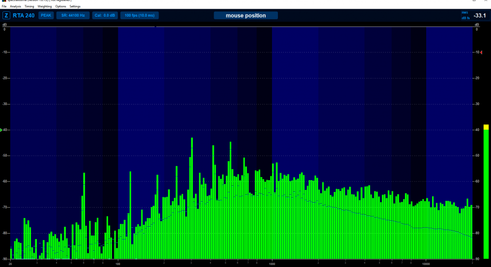

1 hour ago, praezis said:
I can confirm Guido's results.
I ran the audio files on PCTM.
There is much low frequency noise, much too much for this elaborate amplifier.
Waltham was loud (PW?) compared to the noise, with software filter 'on', noise disappeared totally.
The other files showed a bit poor signal/noise ratio.
Frank
2892 filter'on':
SmallWatch... filter 'off':
Waltham before..., filter 'off':
Do you know of a less elaborate amp with better results?  Please share.
